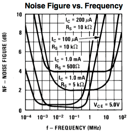

2n5089 is typical of low noise requiring low Vceo and being for 1K~10k plus source impedance, merging into the region where jfets are best
5089 has a high knee frequency where the noise increases substantially below that frequency.
Typically the plots show the knee @ 500Hz to 10kHz.
That makes it pretty noisy in Audio frequency circuits.
This indeed is something to consider: I am certain that the 1/f knee is what you mean here. But with proper choice of transistor current Ic and source resistance Rs one certainly wille be able to use this transistor as a very good imput amplifier. BTW for audio an 1/f knee of about 100Hz is not that dramatic. Unfortunately the original specs do not show us the 1/f curve (as like a MAT02 spec). But hey, compare 4 cents for a 2N5089 to the MAT02, that's a hell of a difference 🙂
For completeness I added the noise plot that ON-semi provided in their datasheet:
