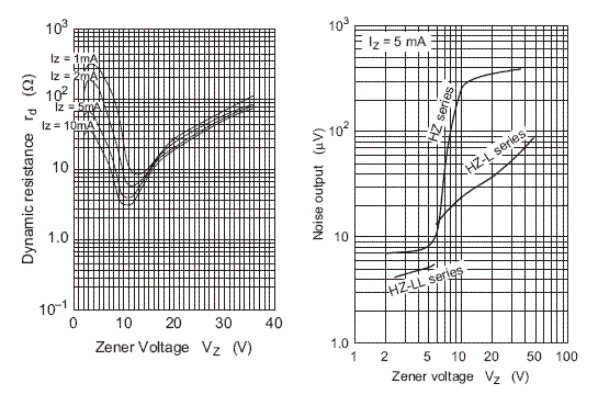

I'll agree with "best below about 6V". When you said "best are 6.2V", I was expecting to see some sort of minima, like with the dynamic impedance.
No, not that easy. The real figure of merit is noise voltage divided by reference voltage, which slightly complicates things- very low noise at 0.7V (say) may or may not be better than higher noise at 6.2 (or 5.6)V. Somewhere in the 5.6-6.2 range is the sweet spot.

The data in 1.4.2. Look particularly at the first graph, which shows 1-2 orders of magnitude improvement at 5.6 and 6.2V compared to, say, 9 or 20V.
LEDs are still quieter, though- under 0.5nV/rt Hz for a cheap red.

Sure enough, Christer's measurements showed much lower noise for the 12V Zeners than those around 6V, while datasheets suggest the opposite. There's an anomaly worth investigating.The manufacturers' data indicate otherwise.
Turns out the answer's fairly straightforward - in a nutshell Christer screwed up the measurements.
What he was trying to do was pass a constant current through the DUT, and measure the noise voltage across it. However if you look at his test rig, you'll see that he used a very noisy current source.
So what he was actually measuring was: measured noise voltage = (noise voltage of DUT) + (current noise from CCS * dynamic resistance of DUT), and that second term was obviously significant. Zeners have much lower dynamic resistance at 12V than at around 6V.
Suddenly it all makes sense.
