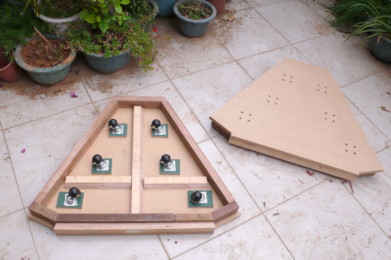

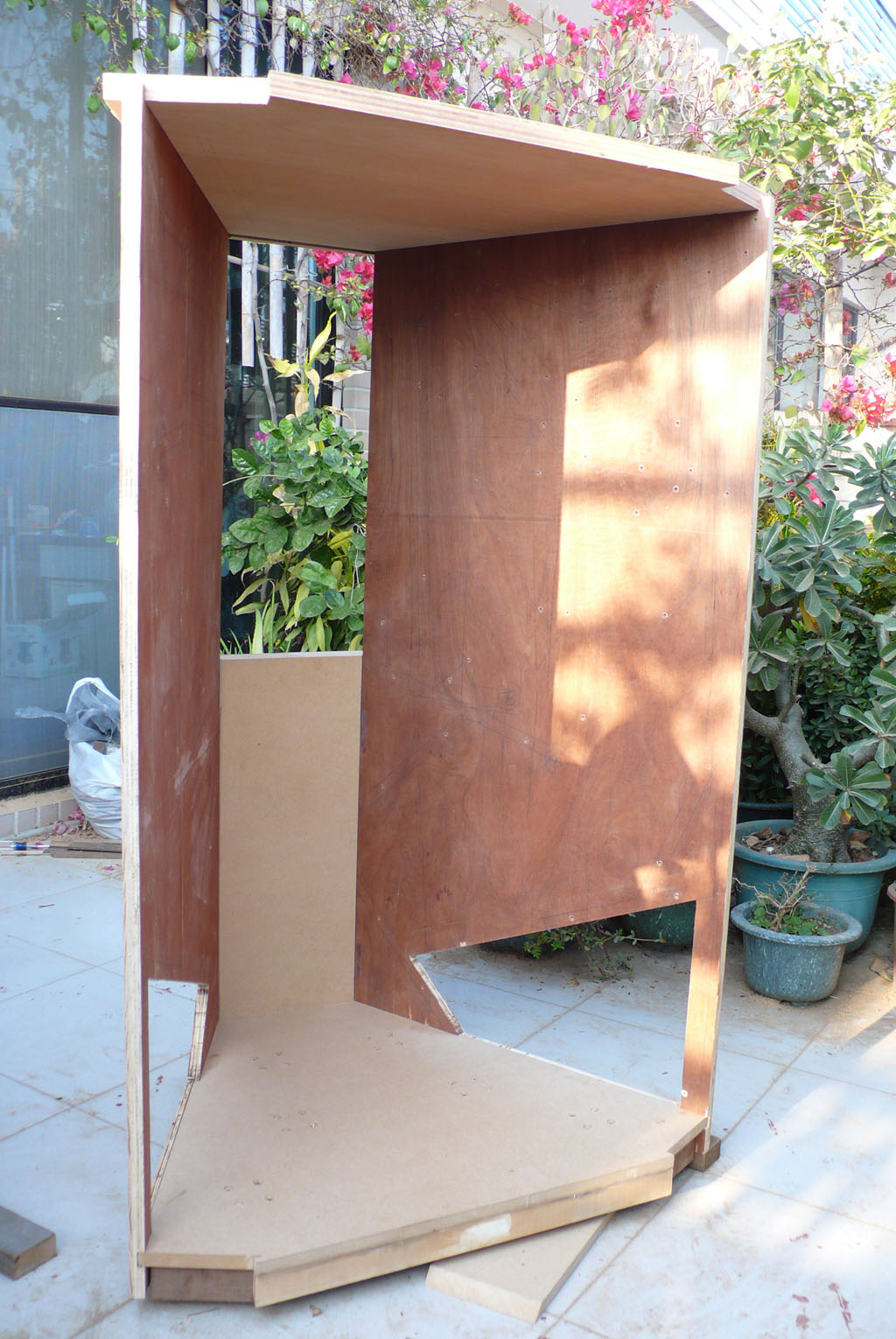

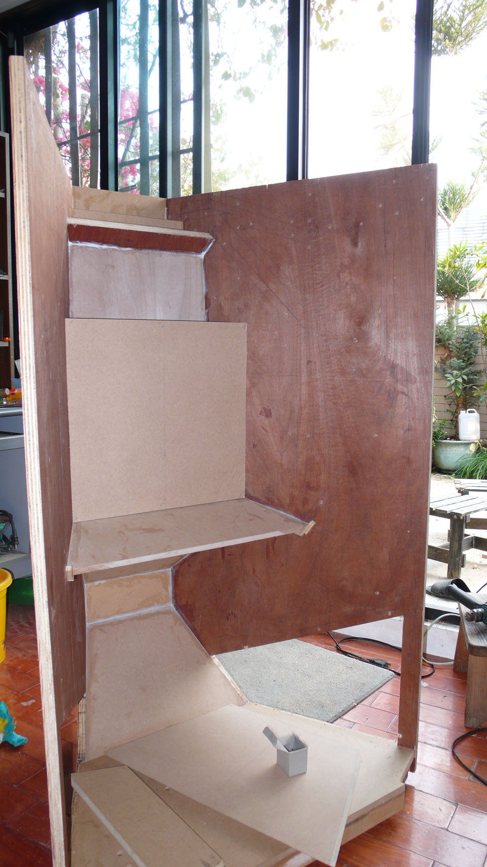

I have to make these big cabinets alone, withoud help. It would be impossible to turn down this heavy(about 120kg) cabinet later by myself. I install 6 rollers(costors) for each baseplate. The baseplate(18mm Th'k MDF) seems to be a little weak. Some reinforcement plates and damping materials are added under the baseplate to reduce resonant. The damping material is not shown in the photo.
Lowther Opus One model B

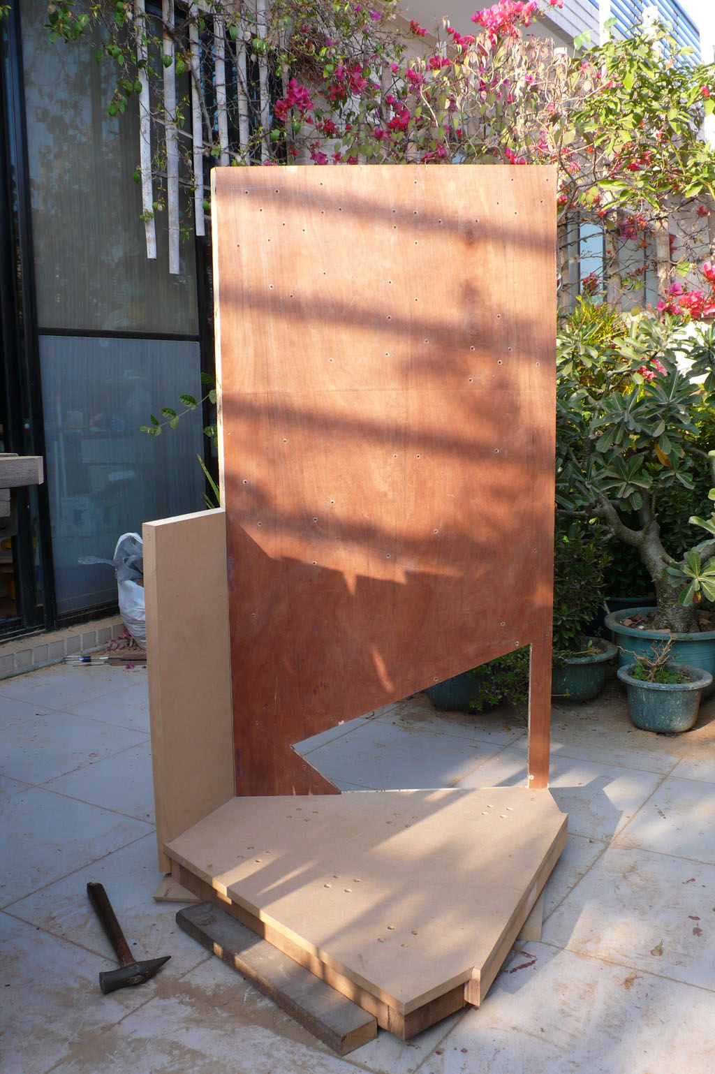

I spent a lot of time to figure out the assembly process. C clamps should be uneasy to use for this non-rectangular cabinet. I think screws and wood sticks are more useful. Two side and back panels are assemblied first. Pre-assembly by screws is absolutely a must before gluing for every panels. Top panels are routed with grooves to bound the two side panels.

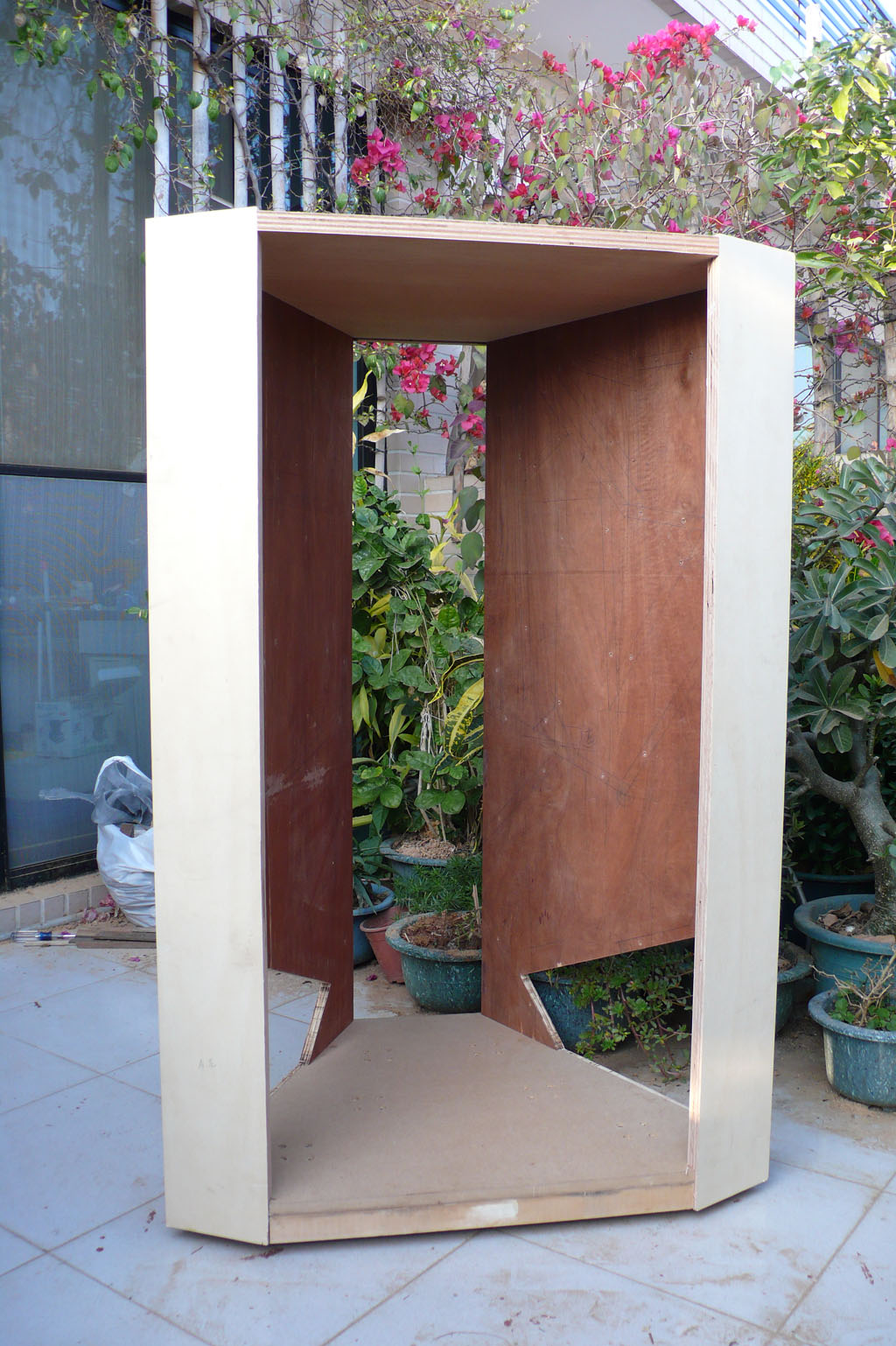

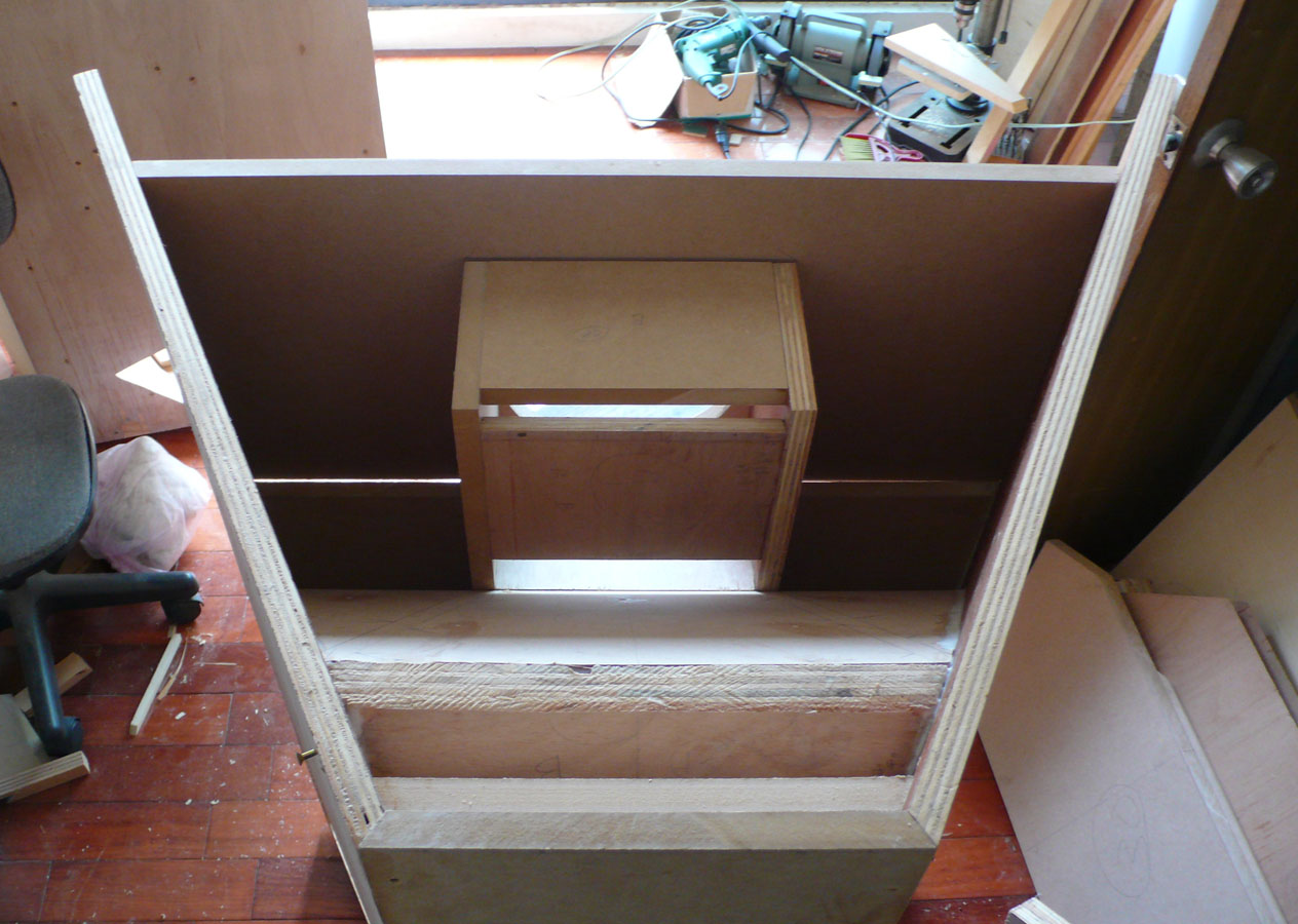

Let’s continue to precede the assembly process. I spent a large effort to figure out the assembly order for this complicated project. All enclosure panels are first temperately fixed by screws to check overall dimensions. Then remove all the screws and glue only two large side panels, base and back panels. Top and front panels should be left at the final step; these areas should be reserved to pass inner panels. The inner panels are typically glued in the order from bottom to top, and from back to front, except that the compression chamber should be pre-assembly and glued.
Somebody said that this cabinet can only be made by many hands in a plant; the panels are only can be cut by a CNC Laser machine. That is not true.
Dear Tom Scata, thanks again. Our diy guys always want to make something different or difficult. I am always afraid of doing something wrong, although I believe I can solve difficulties finally. Encouragement is very important for all us.

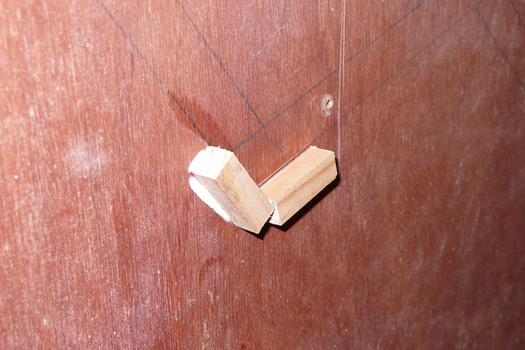

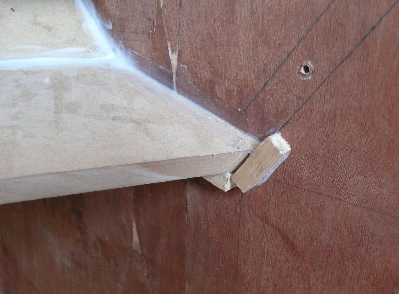

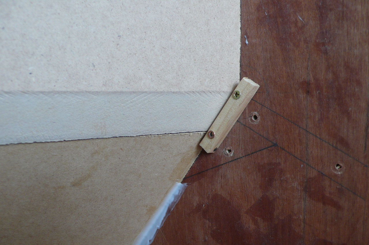

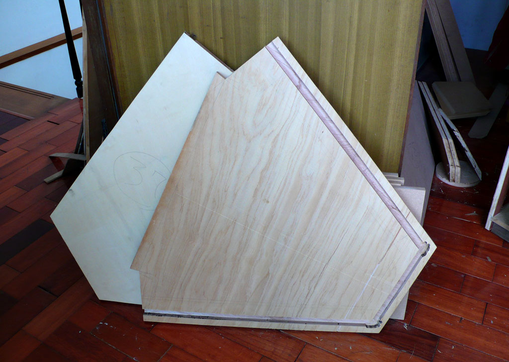

I forgot to mention that the side panels and lower back panel should be grooved to fit into base plate accurately.
You may find that setting some inner panels into the enclosure precisely is a hard work. Wood sticks which used to position some inner panels are shown here. The wood sticks are used to bear the panels below. Metal screws used to fix the panels from side panels. Both methods can let the assembly work much easier.

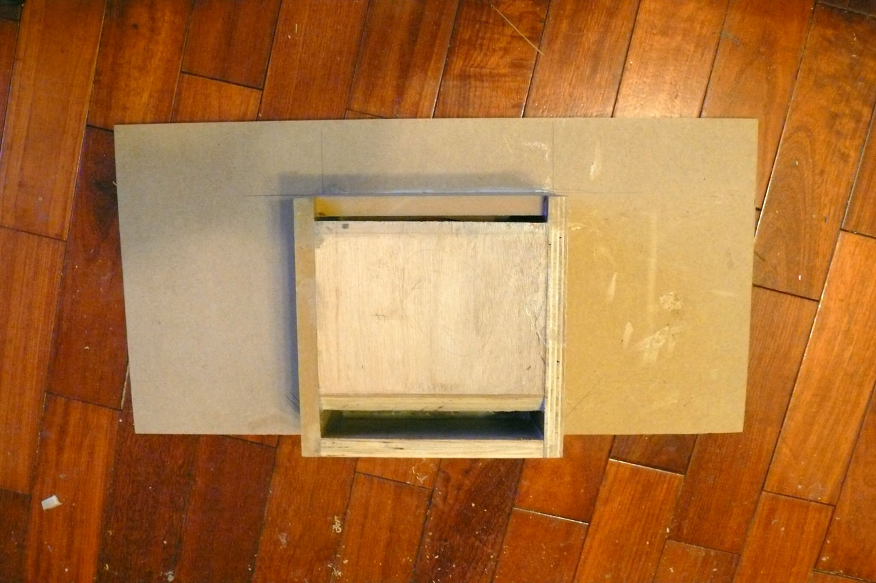

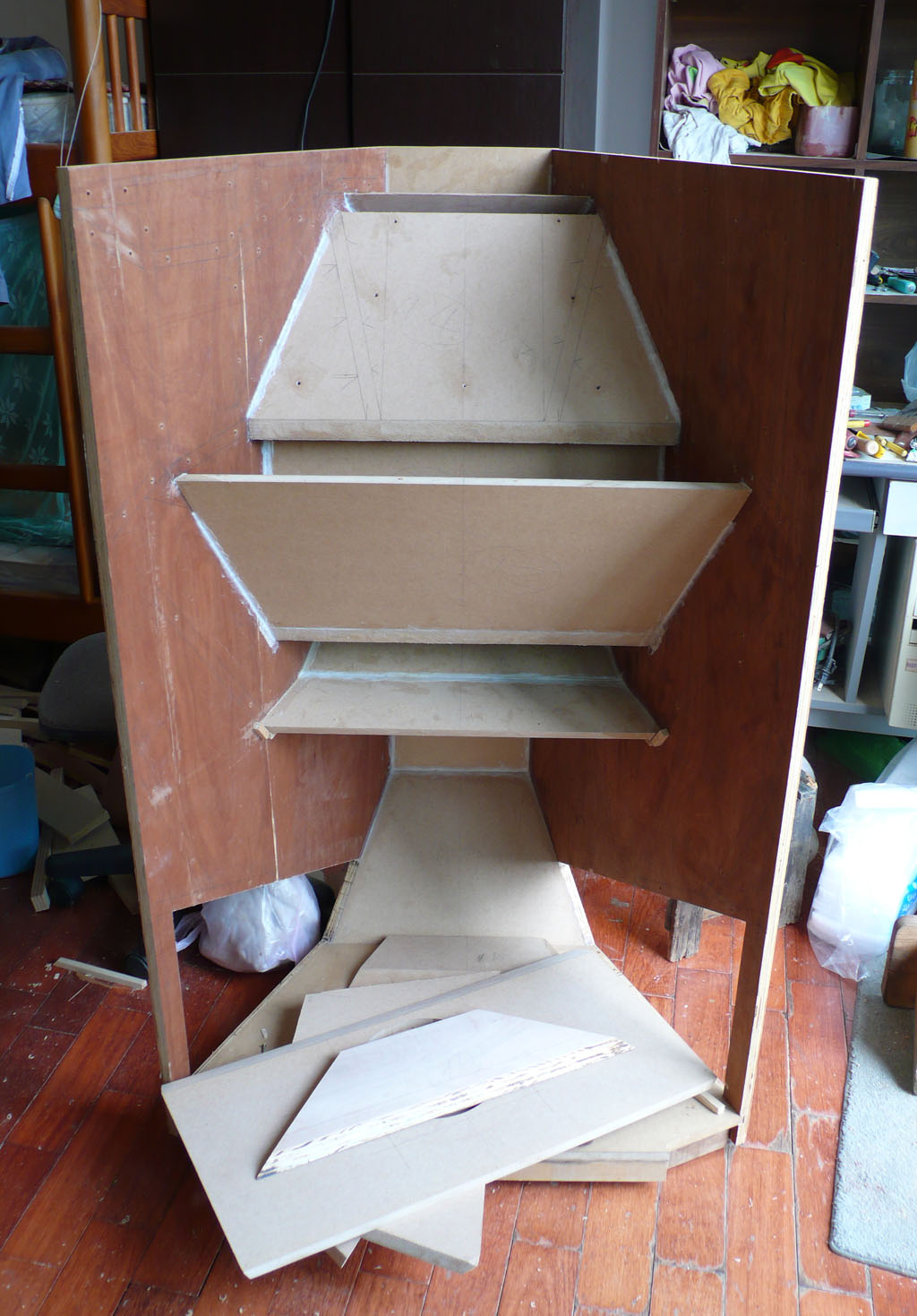

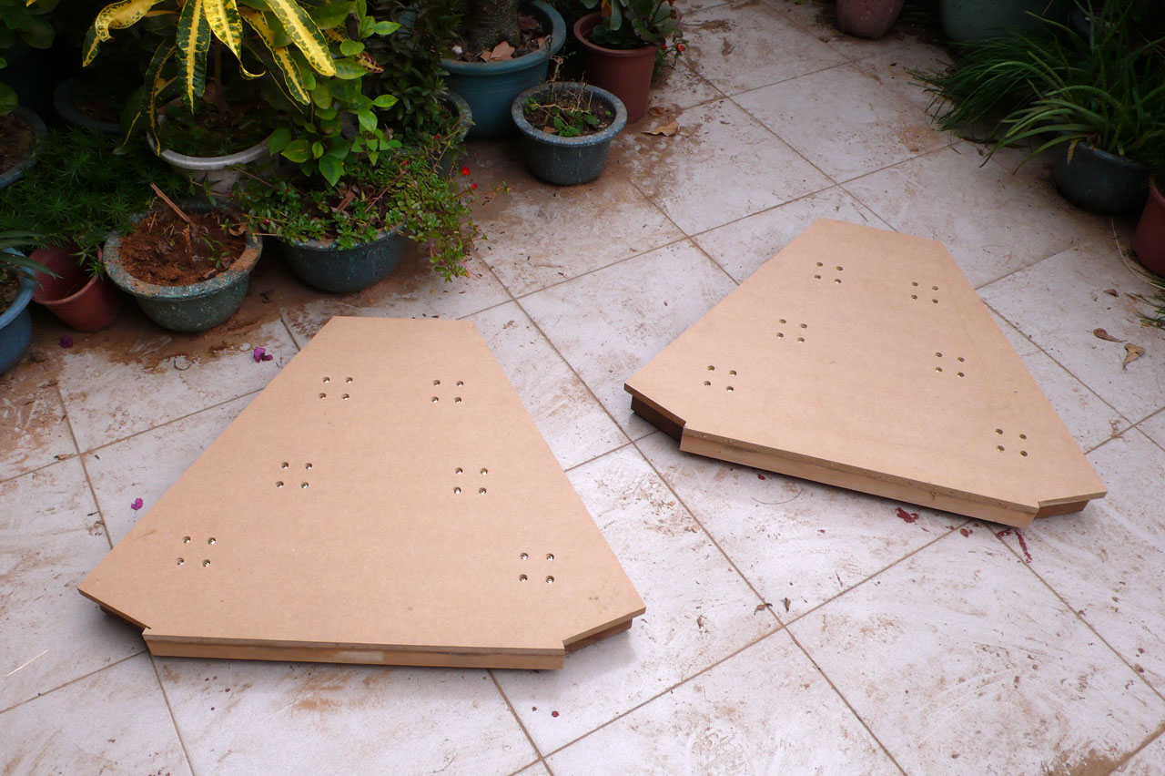

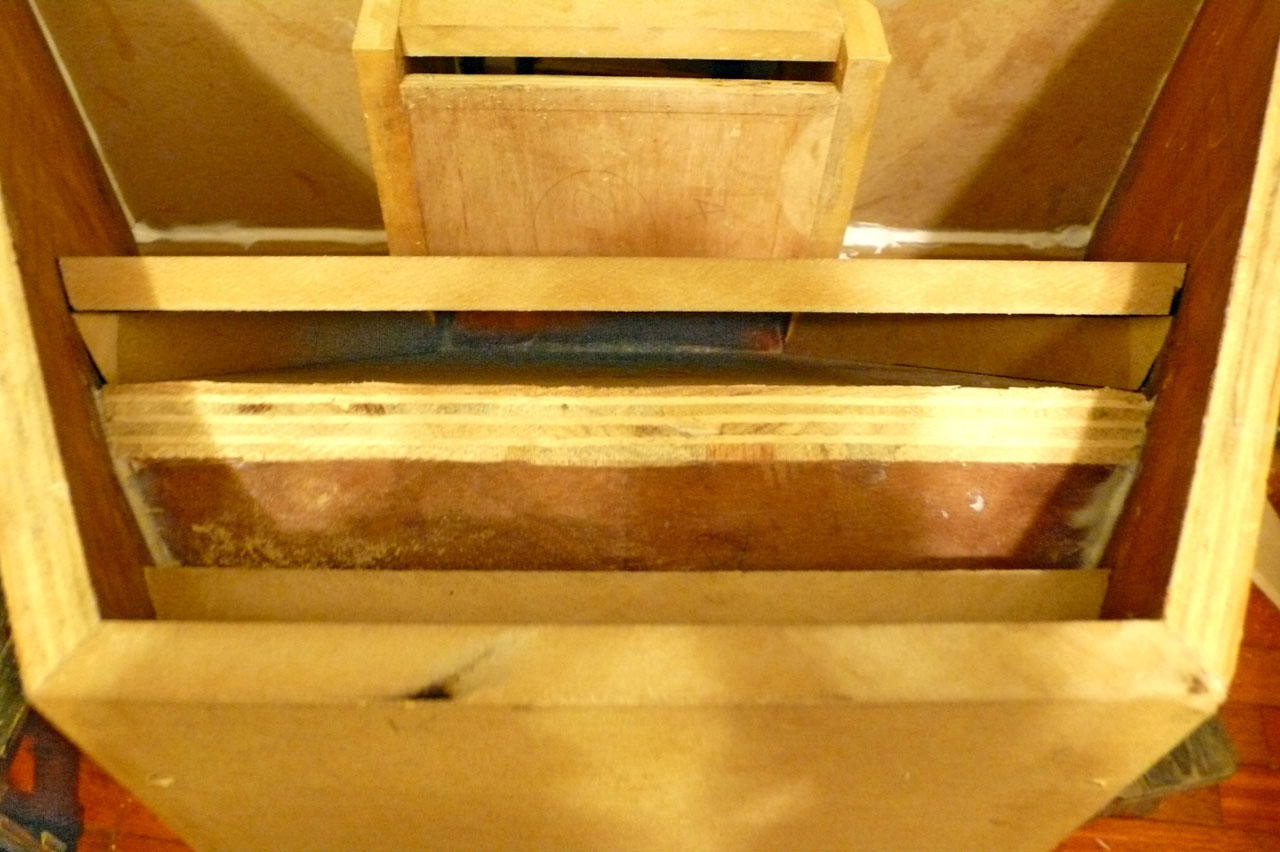

The progress kept going. The two throats sizes are the most critical points in the horn theory. The assembly of driver mounting panel and compression chamber is a little tricky. I found these parts should be precisely assembled to a sub-assembly first before fitting into the cabinet, in order to assure the dimensions of compression chamber and two throats to be as accurate as possible.
I bought the CD of cabinets drawings from Lowther directly. The drawings show the whole cabinet and panels’ dimensions and even point out some critical points. However, Lowther doesn't describe how to cut the woods and the assembly procedure. The drawings are quite complicated. You should have an engineering background to understand them. There are some errors in some panel's drawings. You should use the AutoCAD software to fix the errors.
You guys will not believe that I spent about 6 months to finish this project. I need to work 6 days per week for the company from AM 6:30 to PM18:00, so I only have about maximum 16 hrs free time in a week to enjoy this diy hobby.

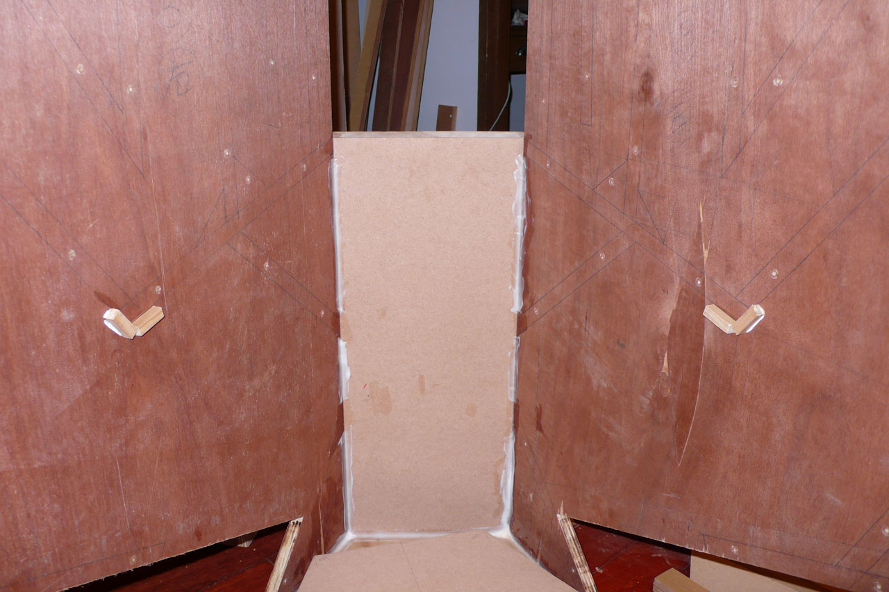

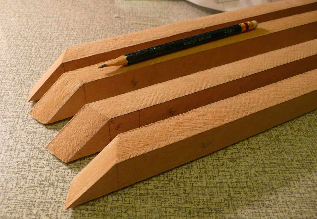

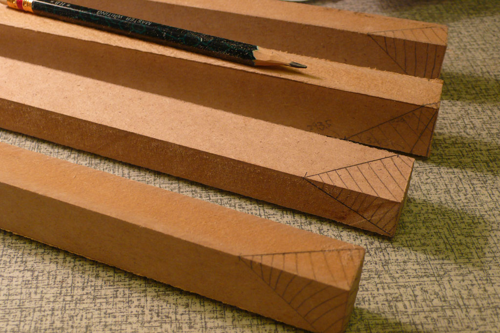

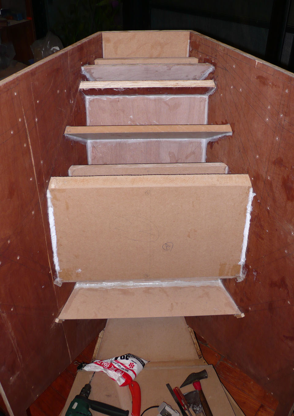

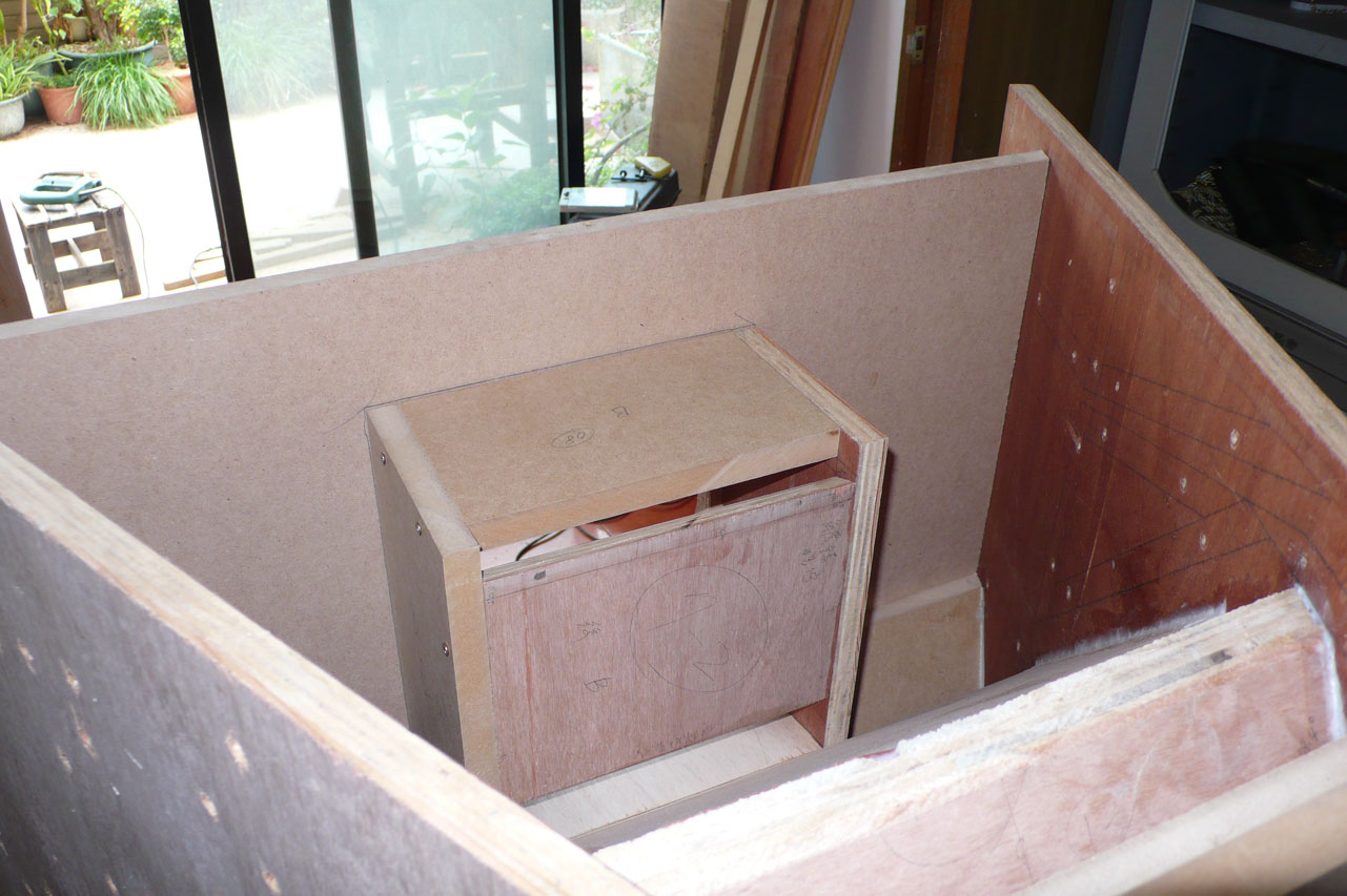

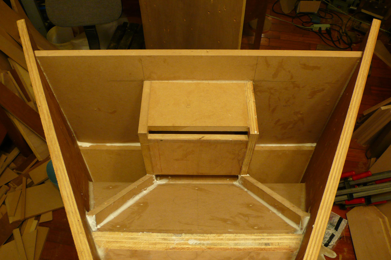

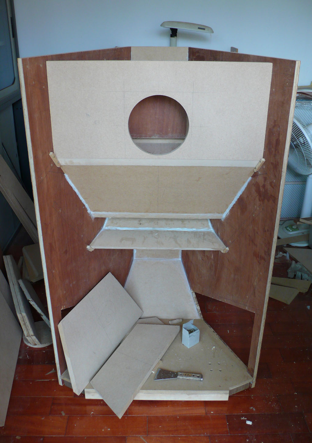

I continue to present the construction of this project.
The very complicated and critical panels are the dividing panels, which are extended from the throat. Originally I follow the drawing to cut these panels and latter found these panels are unable to match with the throat. I corrected the error by field fitting and a little try-error.
English is not my native language. It is difficult for me to describe my exciting feeling about the sound of these big horns. Their sound is wonderful, very clean, clear and dynamic. When I switched to another full range speaker Jordan VTL with JX92S, I found that the sound of JX92S suddenly become terrible; they don’t sweet and swell any more for my ears.
