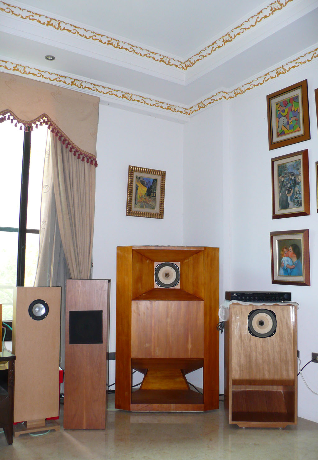

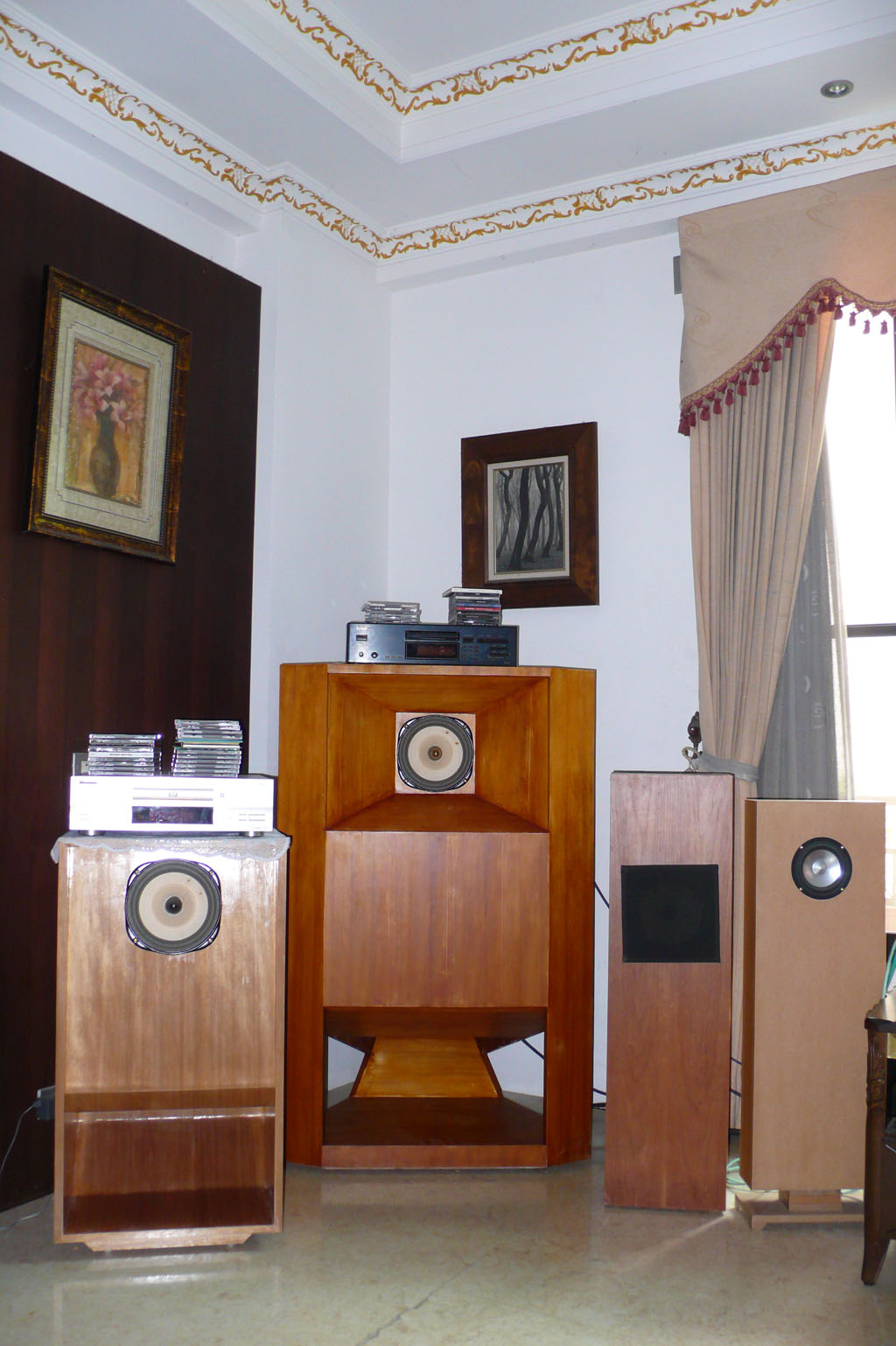

The Opus One now gets into the corner standing with their elder brothers.
I am surprised; up to now I just noticed that the Opus one looks so large compared with Acousta 115 and Academy.
I just listen W. A. Mozart's Konzert fur Klarinette played by Prinz.
Every note became different!
I just hope that your enjoyment was (and is) equal to look of it , and that sound isn't much below that

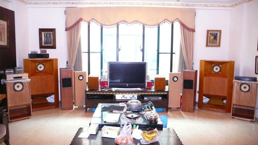

Lowther Opus One model B
Hi, Rick and Zen Mod
Thanks for your interest.
The build work is difficult and exciting. The sound is wonderful.
The looks are just so so.

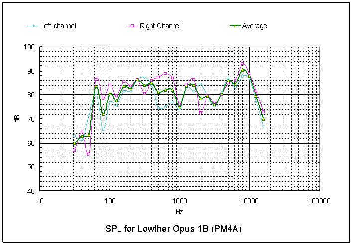

SPL measurement for Lowther opus one model B
I just measured the SPL response for lowther Opus one model B. The measurement may be not quite accurate, but very informative!
The sound lever meter used here is Radio shack (realistic) model 33-2025(older type). The measured distance is above 4m, on-axis, and the same height, faced to driver PM4A. The measured data is corrected by using the data from Audiogon for the meter.
Please note that the big peak at 62Hz which should be a room resonance. The distance between the ceiling and base of my listen room is about 2.8m, so that the theoretical resonance frequency should be 345/(2.8x2)=62Hz. The measured resonance is quite matched to the acoustic theory.
Other minor peaks between 60-120Hz may be resonances result from some furnitures, such as the tables, cabinets or chairs. The distances between the ceiling and those furnitures are about 1.5-2m.
After examining the diagram, I think that the LF response of Lowther Opus one B is rolled off from 100/120Hz with a slope of about 24dB/octave.
I would like to highlight that Lowther Opus one model B is really an excellent speaker. I am so surprised that I can hear and feel the sound wave of 30Hz during measuring, although which is about 60dB only. I still agree that the Opus one B really doesn’t need a subwoofer to play the bass, as mentioned before by many audiophiles. However, I crave to use above measurement to design a pair of subwoofers using peerless, 12” model-835017.
I also found that I could hear nothing for the 12.5K and 16 KHz signals, although the meter shows 80 and 70 db respectively. I may have some ear problems. 😡
Any comment or suggestion is appreciated. Thanks a lot.

Hello,
such big and no bass?
the difference between left and right is too much
Please note that the averge SPL of whole spectrum is 80db for both channels.
If I increased the volume to get the averge SPL to 100dB, then the 30Hz level will shift to 80db.
The opus definitely has bass but not strong.
The bass is moderate and enough for classic music.
I think the response difference between left and right channels mainly result from the alignment angle error of the meter toward the driver's center.
The HF response of Lowther PM4A, even with a front horn, is very very directional!
The angle alignment seems to be difficult for the opus-shaped horn.
I may try to measure them again, more accurately.
I think there is no horn is large enough, but the room space is limited.
I admire your horn designs.
I found that the bass response of Fostex drivers is about 10db louder than lowther's.
Hello Peter,
for our ear brain is the left right not difference more important as the problems of a box itself.
I don´t believe in such a big difference of a Pm4, so better make new measurements,
near field driver 1 cm out of axis, near field horn mouth, fullrange if 1 m does not match to the bass try 2 m, and important make a IMP measurement.

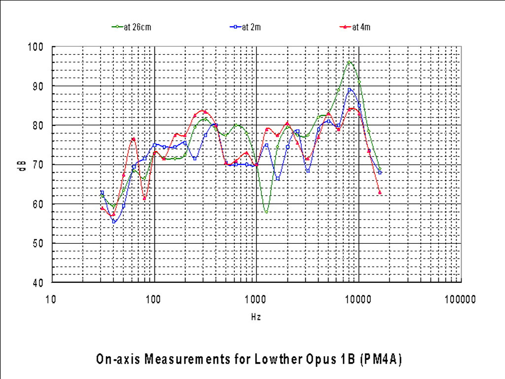

Hi, Horst Möller, thanks for your very positive suggestion. I measured the near-field responses and combined with previous far-field one to make a comparison, as shown.
There are three measurements, all on-axis, only for left channel. The far-field measurement is located at 4m, the same as the ordinary listen position. The near-field measurement at 2m is used to as a typical comparison base. The third measurement is located at 26cm from the driver’s cone center, almost just in front of the front horn mouth. The measured data are Levelized to the same value of 70db at 1Khz.
By examining the diagram, there are three essential phenomenons which I would like to emphasize. The first one I noticed is that the fare-field response around 8 kHz is attenuated about 12dB compared to the near-field one at 26cm. The front horn seems to have a strong performance to reduce the HF shouts, sometime criticized for Lowther’s stronger drivers.
In addition, the room resonant peak at 60Hz is almost disappeared at near-field responses.
The deep dip at about 1.1Khz of near-field measurement at 26m is quite difficult for me to understand.
Any comment or suggestion will be highly appreciated. Thanks.
Peter,
"deep dip" because the horn is at that wave length to large, reflexions in the mouth
delete at that mic point with that wave length.
Now i would make measurements at the listening place, and make an individual
notch filter for each box, to make l/r measurements equal as possible,
the area around 300 Hz is to loud, to much front horn performens and rest of
bass horn.
