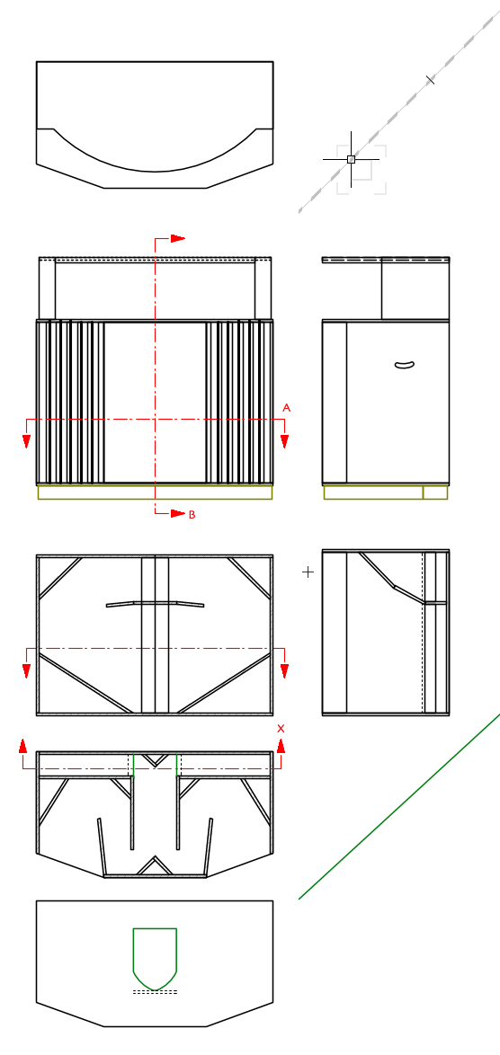

I have a copy of the original bass horn drawings.
Some progress… enuff for peopleto at least get an idea.
dave
Using a very rough range of estimates of the horn's parameters, I ran a sim in HornResp. It should produce something like 105dB down to around 40Hz at 1W.Some progress… enuff for peopleto at least get an idea.
dave

Hi, could you supply a copy to me of the original bass horn drawings you mention, I have background in fine woodworking and would love to make a pair of Lowther Hegerman. I am a user of Solidworks and I would look to complete a 3D file from the drawings, I would then make this work available to any one interested.
Kind regards Barry
Kind regards Barry
For anybody interested, the PDF contains plans for the Lowther Hegeman Bass cabinet, these are my work taken from original drawings, they were in poor state as they had been photo-copied a number of times, I also have available a Solidworks model of the enclosure, again for anybody interested!
