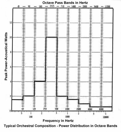

As to the power of a fixed or variable L-Pad ...no... they don't need to be 100w, but a 100w L-Pad is not that expensive. The Power Distribution across the frequency spectrum is very low for high frequencies. For example, and from memory, if we have 10w at 350hz, then we will have about 1/2w above 4khz.
Here is a chart of Power Distribution across the spectrum for full orchestral music -
Though I would certainly not make my Tweeters or L-Pad components 0.5w. 16 ohm Variable L-Pads are not that expensive, and typically come in 50w and 100w ratings.
