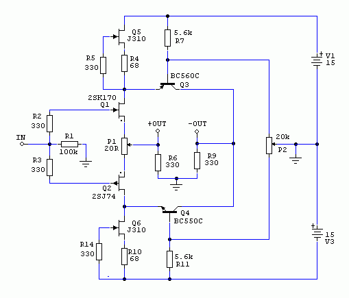

I am interested in using the unity gain version of the LSK circuit as a phase splitter for bridging amps. I mean the schematic which you posted in F4 amp thread (post 3942), also attached here. Re: this schematic:
Q1: The output impedance here is 220 Ohm, right? and
Q2: what grade (Idss) are 170/74 pair? Can I use BL grade parts (Idss~7mA) and if yes how do I adjust the current sources and other values? Thanks a lot. (p.s. if the Zout after changes gets higher, I can always run both Out+ and Out- signal, each through a separate buffer, right?

Yes, but only on the -OUT. On the +OUT it's about 20-30 Ohms. So there is a difference in Zout value between the outputs but it won't matter if the load (next stage's Zin) is high enough (10k or more).Q1: The output impedance here is 220 Ohm, right?
For that phase splitter I used BL parts (~8mA Idss) so your JFETs will be fine.Q2: what grade (Idss) are 170/74 pair? Can I use BL grade parts (Idss~7mA) ...

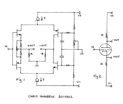

Look at the sch. in attachment, I think it will serve you a bit better. CCSs (Q5, Q6) should be set for 15-17mA each at 5V (both should deliver the same current) before you put them in the circuit. Value of R4, R10 will set the current through Q5,Q6. Start with the given value and see where it'll take you. P2 sets the DC offset at -OUT (like in Chris Hornbeck's original schematic)...how do I adjust the current sources and other values? ...
Now it's 330 Ohms at -OUT (it sounds better to me that way, you can try different values) and it still doesn't need a buffer to drive any standard amp (Zin of 10k or more) but yes, you can add buffers on both outputs if you plan to drive extra long cables and/or unusual loads (F3, TVC, or similar)....if the Zout after changes gets higher, I can always run both Out+ and Out- signal, each through a separate buffer, right?

Of course - everything stays the same except the value of the output I/V resistor and P2 which is introduced to enable separate DC offset setting for -OUT (P1 does it for +OUT)....Is it possible to use +/-33V that already exist in PS?
Excellent, any suggestion for I/V resistor value in case that 2SK170V/2SJ74V or 2Sk246/2SJ103 pair will be used?
Look at the schematics. With k246/j103 you can use somewhat higher values since they have lower parasitic capacitance. It's a compromise - higher resistor values give better general linearity (smaller current swing is needed) but they tend to narrow the band and increase the Zout.Excellent, any suggestion for I/V resistor value in case that 2SK170V/2SJ74V or 2Sk246/2SJ103 pair will be used?
You can't relay on simulations here if you are not prepared to make models that reflect the real world parasitics. Listen to differences that various values produce and/or measure the results. When designing/measuring for bandwidth I aim for such a frequency response that provides zero phase change at 20kHz with realistic load (1-2m coax cable terminated with 10k||10p-1n).
