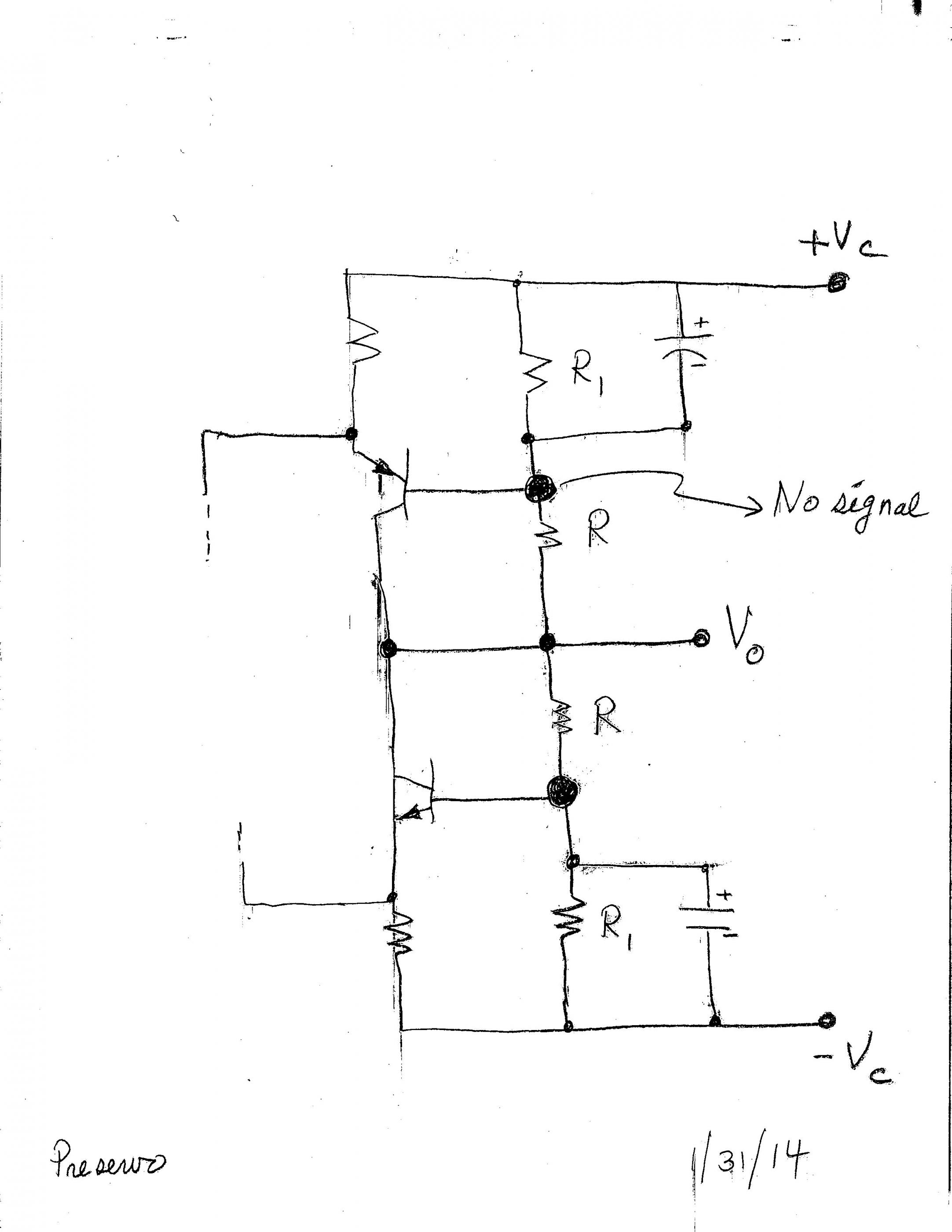

I recall posting schematic like the attached in a dialogue with lhquam in a Pass Labs thread; which escapes me now. This schematic shows a simple approach to DC servo this unique and popular preamp. Note the following:
- An electrolytic capacitor is added across R1. Thus, the bases of the cascode bjts are grounded; meaning no AC signal appears at these junctions to alter the design AC gain [Vo] of the bjts operating in the common base configuration.
- The middle junction of the resistor ladder [R1-R*R-R1] biasing the folded cascode bjts is connected to Vo. Thus Zo of the amp is R/2.
- When the DC voltage at Vo becomes or drifts positive from its initial state, the NPN turns more on and the PNP turns more off. The reverse happens when the DC voltage at the output goes negative. This is negative feedback which acts to restore the initial quiescent DC voltage which initially maybe 0VDC [or close to it] by careful design.
- The bjts operate as undisturbed folded cascodes for the AC signal and as inverters for an emerging DC offset component.

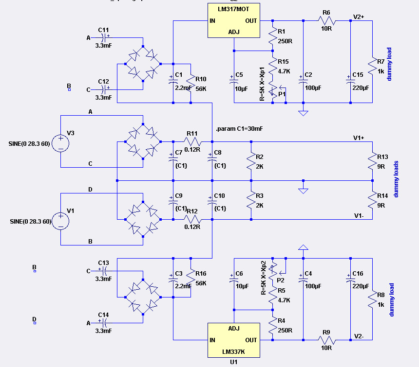

I have a question about the power transformer. Assuming an 18V winding as shown in the post 66 schematic; I don't see how we can get 33V or enough voltage headroom for the 24V regulator. ((18 X sqrt(2))/1.11)-1.4) yields about 21.5V. Even if the transformer had say 20% regulation and we were loading it lightly we'd only hit 25V at best. What am I missing?

I see it...voltage doublers!

And not even that...
AC coupled using polar electrolytics between TX and rectifiersAnd not even that...just AC coupled into the rectifiers. Never seen that before. Good for low currents I guess. Cool.
Yes (to post 335); that's what I was saying in the next post (333). I think my notion of a voltage doubler was erroneous.
I have never seen this before. I guess as long as the caps can tolerate the max voltage and current it should work. I'm not sure about grounding the centre tap of the transformer.
Ok I think I get it.
The two 18V secondaries are in series with the centre grounded.
The charged caps keeps both half of the full wave bridge conducting contemporarily (therefore doubling the voltage?)
The rectifier bridges keeps the electrolytics polarised correctly as current only flows in one direction.
Possibly stupid question: what is the advantage of this over simply getting a dual secondary 36V transformer and using a "normal" configuration with smoothing caps after the rectifiers? No rectifier on/of noise?

Not stupid at all. The only stupid questions are the ones not asked.
This configuration gives 2 voltages off one transformer. The 'normal' voltage is the one that requires more current, hence the PSU being made for that voltage, and the higher doubled supply is easy to make from the LV supply.
IF you were to make a higher-volt supply and regulate down to the lower voltage or use dropping resistors, it would be very inefficient.
