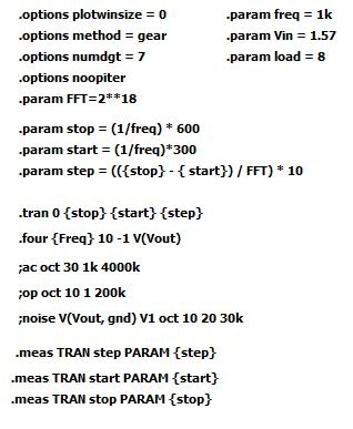

FWIW, here is what I am currently using.

You turned off the infamous LTSpice waveform compression, reserved time for settling, took an integer number of periods of the signal into your FFT window and specified the number of digits, so that's all good.
I wonder why you make the maximum step size equal to 10 times the FFT sample period, .param step=(({stop}-{start})/FFT)*10. Why not equal to the FFT sample period, or maybe even the FFT sample period divided by some small positive integer number? Now some interpolation algorithm or other may have to guesstimate up to nine intermediate points between each two simulated points to get the data needed for the FFT.
You haven't specified a reltol. Sometimes the default is small enough, sometimes you have to set it to a smaller value. SPICE has lots of parameters that influence the simulation accuracy, but reltol is the one that usually has the clearest effect.
I can't say whether 300 periods is enough for settling. Usually you just keep increasing it until the results don't change substantially anymore. If settling takes an unacceptable amount of simulation time, you can try to replace any big capacitors with ideal voltage sources with the same DC voltage across them.
