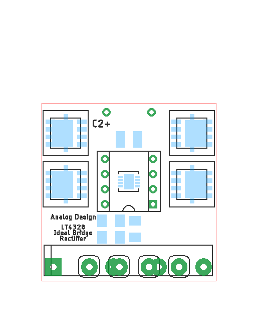

here is something i have been working on for some time.
I am willing to offer the pcbs as a group guy.
let me know if there is interest.
I will share a bom to GB subscribers, all mouser based, if GB goes ahead.
regards
Prasi

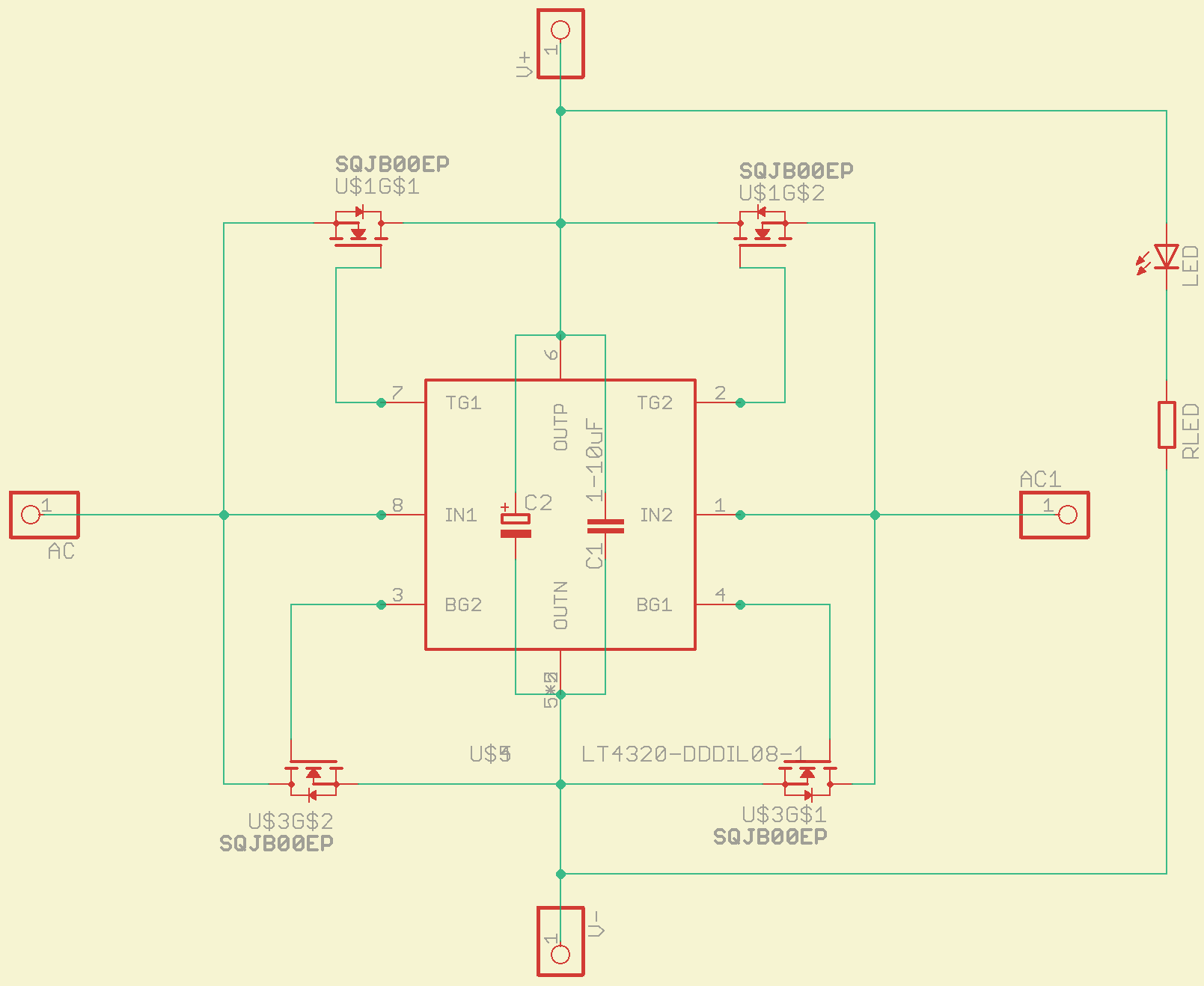

Schematic SMD LT4320 rectifier LT4320 based active rectifier
Schematic THT LT4320 rectifier LT4320 based active rectifier
Schematic LT4320 CRC PSU PCB: LT4320 based active rectifier

I think more info on this is available here before it spun off onto its own thread. This version uses a double-die MOSFET. I can attest that this topology works very well - almost no heat, added headroom due to no voltage drop across silicon diodes, smooth switching with no noise spikes since phase is timed with zero crossing:

Hi prasi, do you think there would be more demand for your PCB if you made it using through hole components rather than SMT devices.
I assume you are trying to make it as small as possible.
Hello Gary, let me try it with dual secondary , 2 of the LT , and 8 of the mosfets but it wont be a compact replacement for SIP-4 rectifiers; rather it will be a regular PCB that needs mounting holes, run wires to bulk cap PCB, etc.
regards
Prasi

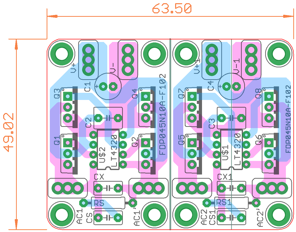

I am running into the same situation in making an all TH PSU using the active bridge.
The use of TH components requires double the parts and the parts are large.
Here is an example of a 10A capable active bridge (just one rail):

Here is the layout for the TH equivalent (dual rail) - it takes up 20% of the real estate whereas the SMT version is a small fraction of that and can be mounted on underside:

1. minimal power dissipation, no heatsink for rectifier, higher DC voltage output for a given AC voltage, etc
2. yes, it is a drop in replacement for SIP-4 type rectifiers.
3. THT option for LT4320 provided, MOSFETs are SMD, but will be simple to solder for anyone who has soldered SMD's before.

Yeah, the dual MOSFET is about the size of a smd opamp. Soldering should not be too bad. Using solder paste to stick the component to the board will help if you do not want to use regular solder. I prefer to use screw connectors than pins for AC though. Just curious what is the estimate of the current limit of the smd MOSFET. Thanks!

Indeed, these are "powerful" MOSFET:D. You are talking about the smd version, right? Come to think about it, the size of the smd version of the MOSFET is only about 5 x 6 mm, 3 W dissipation is a lot for such a small device (please correct me if I am wrong) and there is no cooling. Is that OK?
However, I suspect that the typical current draw (for a class A amp running at 30 V) is probably under 5 A. So, the heat generated will be much lower.
Looking forward to your testing results!!
Here is my all THT version of the rectifier, though small enough, its still cant replace the SIP-4 type rectifiers.
regards
Prasi
