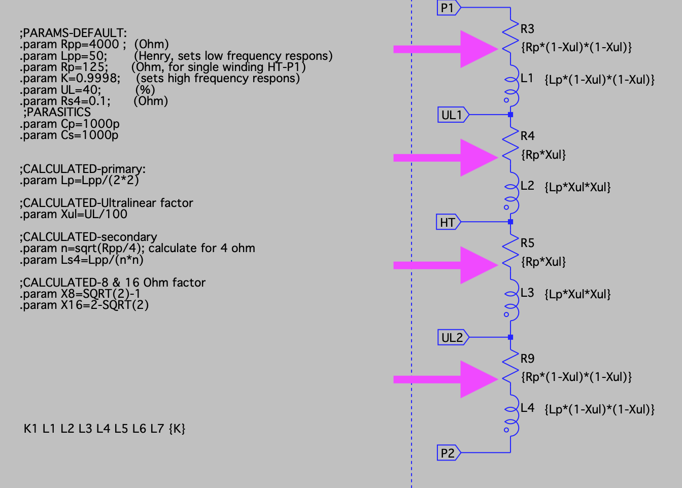

HAMMOND 125A universal PUSH-PULL Output Transformer
For diyaudio fellow JoeAlders I made a hierarchical model of the Hammond 125A.
He was working on the Lingwendil flea amplifier project
https://www.diyaudio.com/community/threads/6sn7-push-pull-flea-amplifier-project.303846/
Based on the datasheet (and a 125A that Joe kindly sent me to take some measurements) I created this model. Measuring a transformer with simple equipment is not a trivial task, as we both experienced. The transformer K calculated from my L measurements was too high when looking at the frequency response. To correct this discrepancy, I cheated and adjusted K to match the LTspice results with my 3k-8 frequency response measurements. So there is certainly room for improvement.

NOTE:
By adjusting a few parameters you can easily convert this 125A model to another type from the 125A..E series. Start with changing Lpp, R-brown/blue, and Rs-total, and go from there.

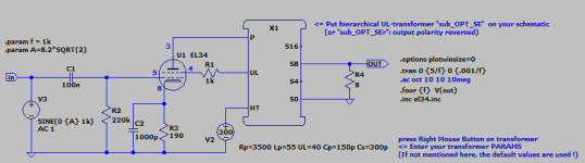

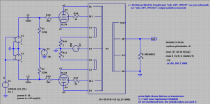

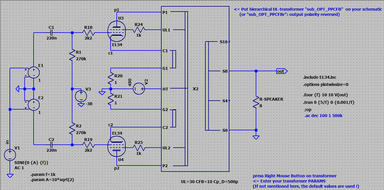

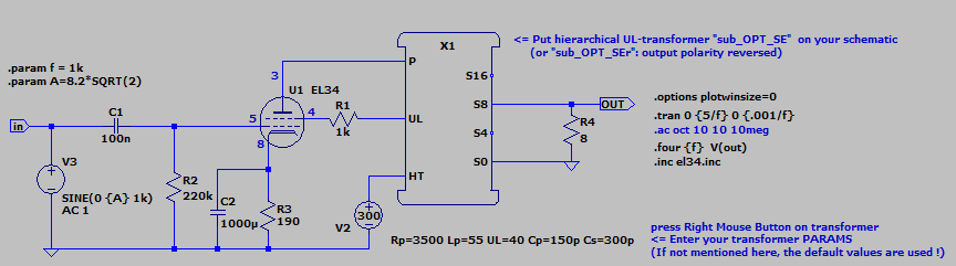

Hi Mo,
The asymmetry is caused by the distortion in the "out" signal. (use control-L to show it in the error log)
When you re-run the simulation with a lower input signal, the signal will have lower distortion and the symmetry will be better.
The distortion is not caused by the transformer model. It is only a simple lumped model, that doesn't incorporate core-saturation.
Press Right Mouse Button on the transformer, and click [Open Schematic] to view the model used.
The example circuit with the EL34 is only to show how to use the transformer model. It is by no means a perfect circuit.
