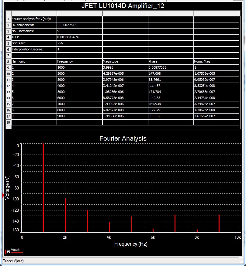

I post the full Fourier Analysis of this amplifier at 1 Watt 8 Ohm.
Have a look.
Notice the very dominant 2nd harmonic.
This is what Nelson Pass is going for in his amplifiers.
He has also used LU1014D. In fact he has helped to make it popular.
But the second harmonic in this amplifier has got a positive phase. As can be seen.
This is not perfect in the eye of Nelson. He likes the phase of 2nd to be negative.
Well, one can not get everything.
Here it is:
Have a look.
Here it is:

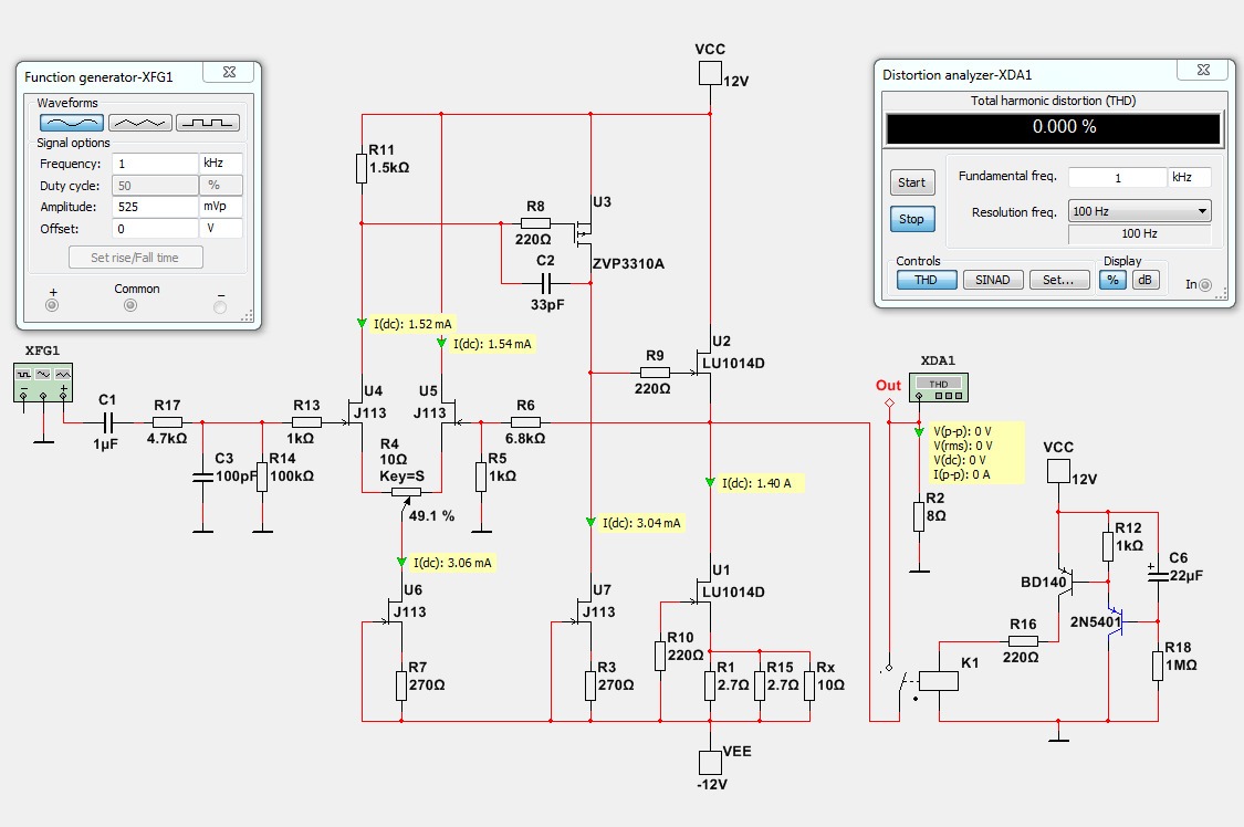

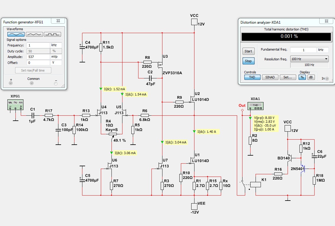

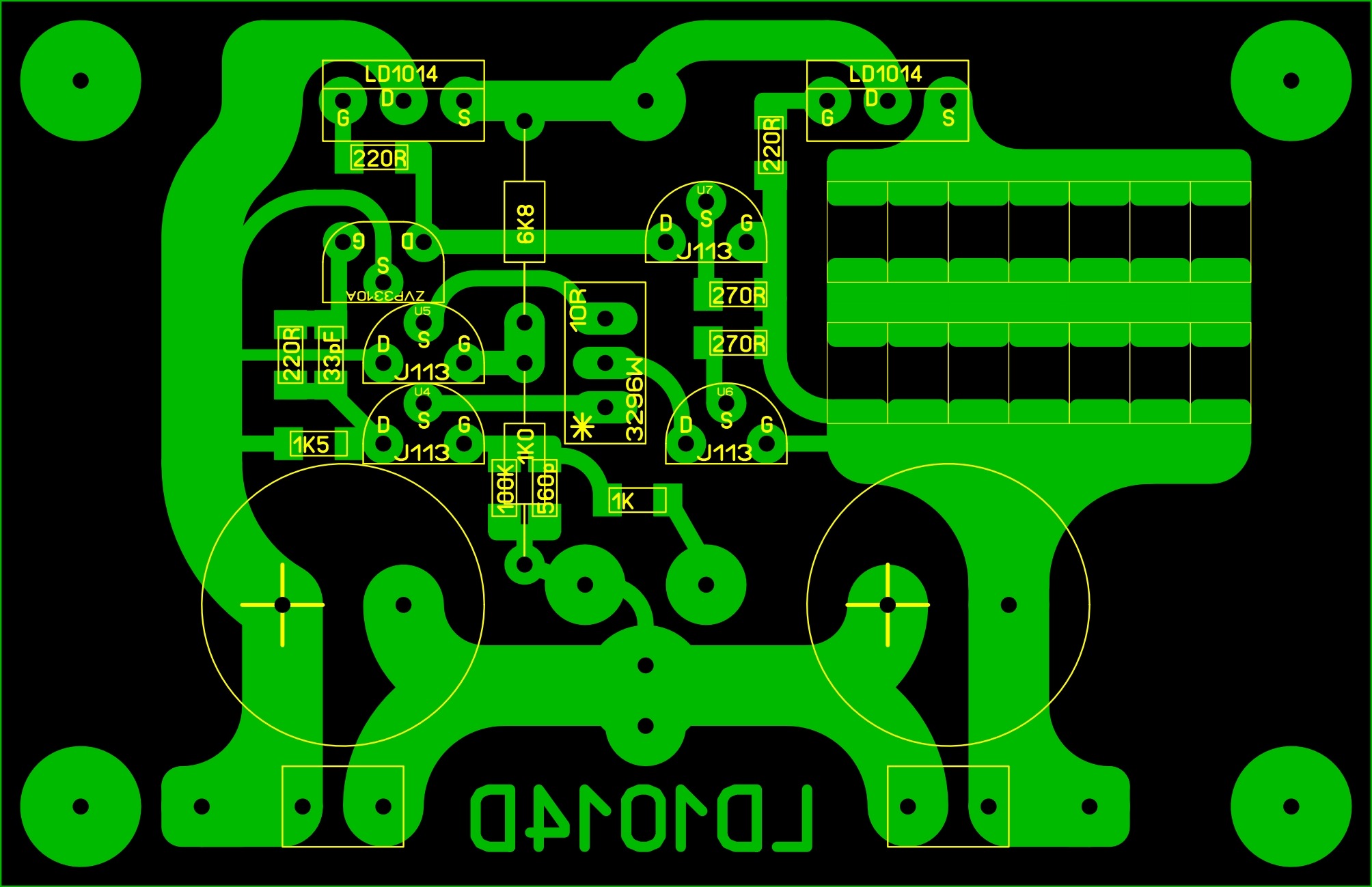

since I have 100 of these LUs, I wouldn't mind trying to build this one. One thing I would do is to combine both boards on a single one to cut down fab costs. How does the circuit do with PS rejection? Would reg PS help? Sorry if this is asked and answered already.

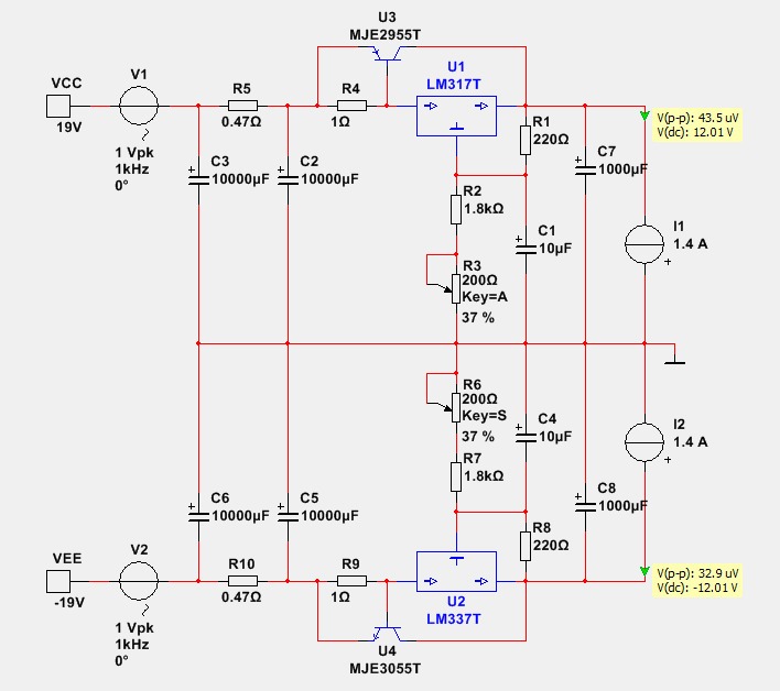

Now let's talk Power Supply for Small Amplifier.
The need is +/-12.0 Volt.
Transformer should be 2x15VAC.
Preferably 150 or 200VA.
300VA should not hurt for feeding both channels.
Here is a suggestion for supply circuit.
It is a Transistor Boosted LM317/LM337.
It is a simple way to get very precise supply.
That is also one way to do it.LM317+LM337 need 4V-5V droping between Vin and Vout for effective work. More easy to build a simple JLH voltage regulator.
I want the supply to be regulated.
There are many ways to do this.
Your suggestion is a good one.
Why this amplifier use +12V and -12V is because LU1014D can only take 24V.
Should there be diodes across the CE of 3055 & 2955?Now let's talk Power Supply for Small Amplifier.
