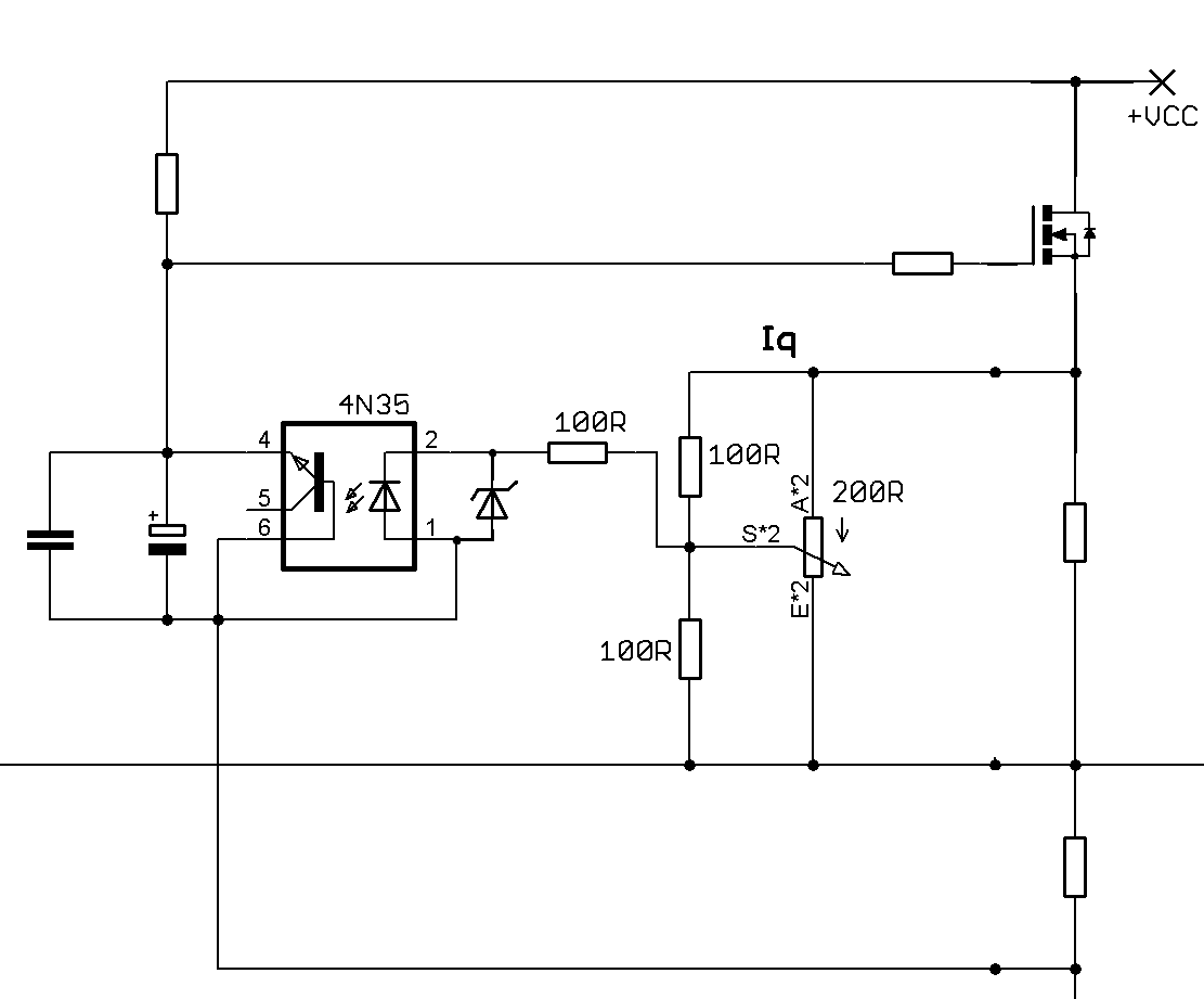

I already posted this one somewhere, when speaking about Best Papamp ever - M2 (though - Careful with that Axe, Eugene!........ I didn't drew it absolutely idiotproof - starting is with trimpot set all the way up):

Chaps, Another couple of questions..
Regards the 10uF Silmic in the signal path, what's the smallest value it can be reduced to and still function properly? Ie will a 2.2uF film cap or PIO etc work perfectly well? I know on the M2 this cap only has 5V DC across it, but I'm interested if a smaller capacitance value will chop off the bass etc.
For the other on-board caps what's the max voltage across each of them? Is it less than 10V for the 3300 uF item, as on the M2?

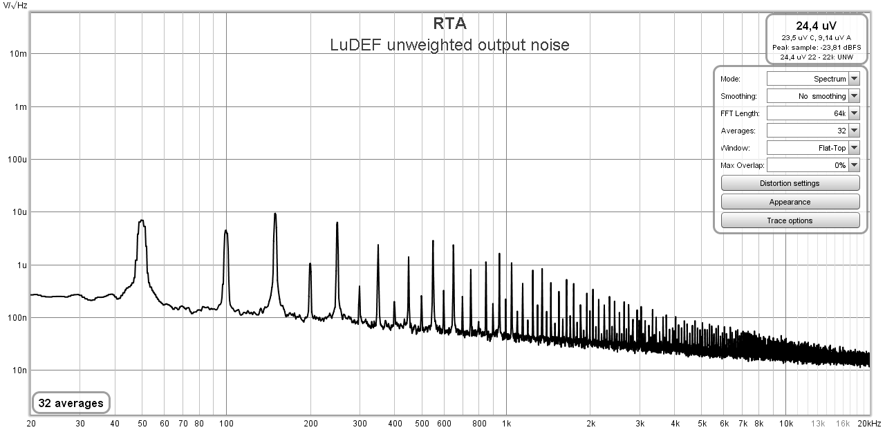

This is LuDEF output noise with PS having only several uV ripple and noise, so 9 uV at 50 Hz is not coming through power supply but is noise induced by power transformer stray field. Nothing to even mention.

I reckon that noise is getting in via the 'big' lytic caps.. SMT on the the back of the board is what I'll be doing

My LuDEF has Cinemags. This noise measurement was to illustrate that input transformer is not very sensitive to EMI.
Noise or ripple at amplifier supply rails is not directly transferred to the amp output. It is attenuated by amplifier PSRR. Nothing to worry even with 50 mV supply ripple.
