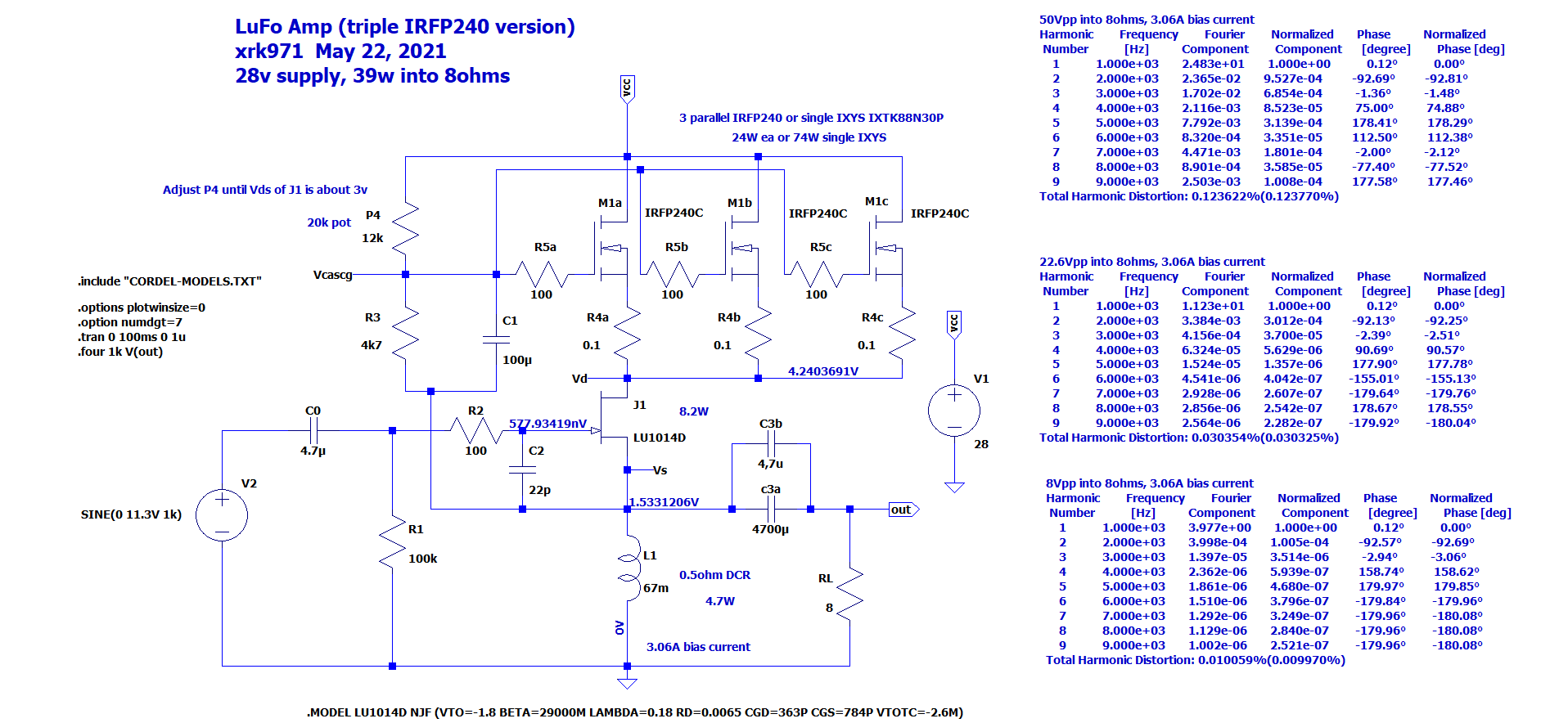

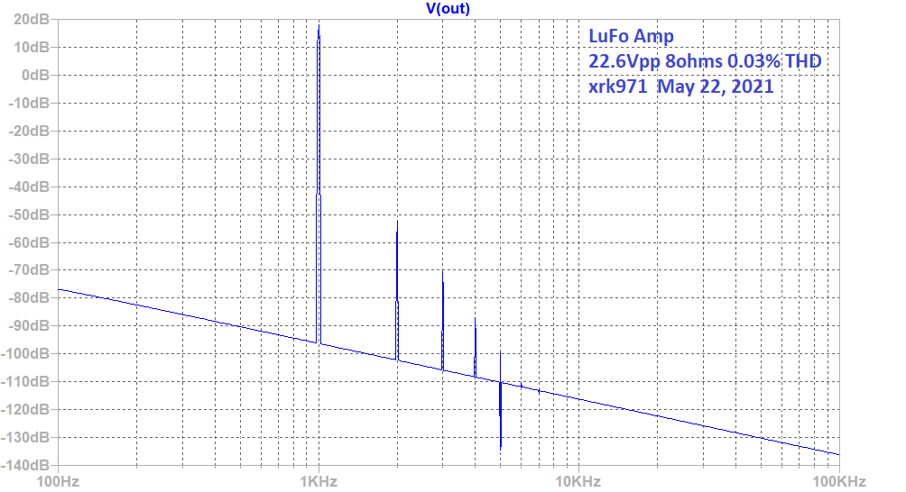

Here is the resulting schematic from LTSpice doodling. It has a minimal parts count, yet the performance is quite nice. With a 28v supply and about 3 amps of bias current, the simulations predict that it can get up to 39w into 8ohms before clip sets in. The THD at full power is a little over 0.13% but only 0.01% at 1w into 8ohms and 0.03% at 8w into 8ohms. Of course, all this is with a nice SE Class A harmonic profile that is dominant second order and monotonically descending higher orders.
Here is the schematic:

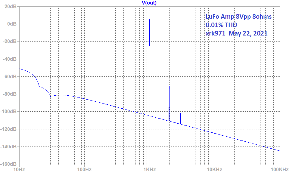

Here is the predicted FFT for 1w into 8ohms (8vpp) - it gets 0.01%THD and a beautiful harmonic profile:
At an average and rather loud level of 8w into 8ohms - it gets about 0.03% THD and still maintains a nice harmonic profile:

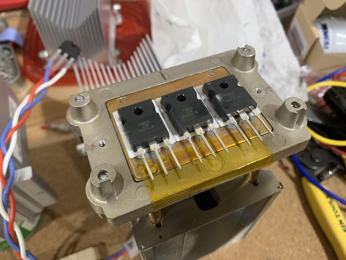

For the purposes of a proof of concept build, I am using CPU coolers and a Noctua fan since I have a pile of them and only 1 conventional 4U x 300mm chassis from Modushop, currently occupied by an Alpha Nirvana (which, btw, has the same output power and dual rails). But the PCB that JPS64 will be doing the layout for me will be a large conventional design with widely spaced MOSFETs (probably UMS compatible). Here is how I am stacking the three MOSFETs (some NOS Phillips PSMN020 150w's that Hugh Dean gave me a while ago) on the Dell CPU cooler, to which I will directly solder a veroboard and build the amp on:

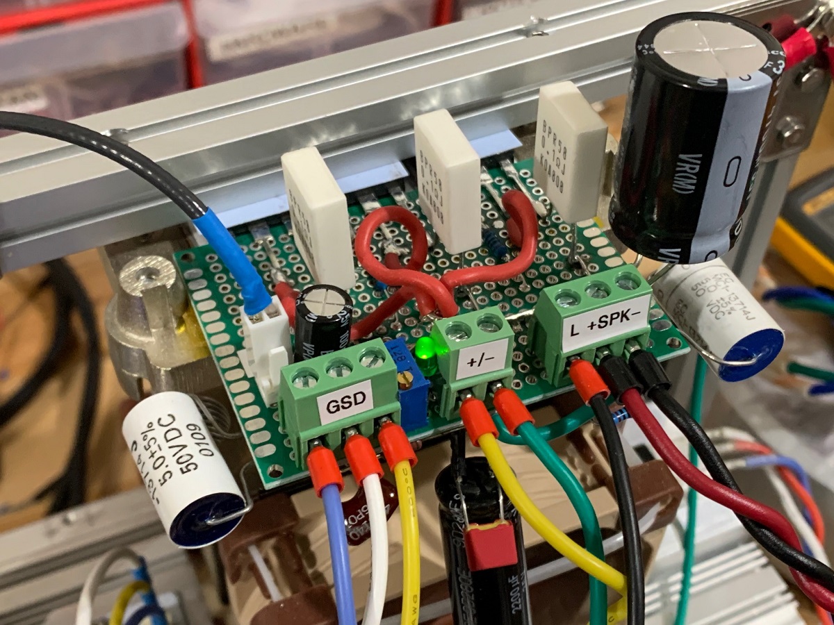

Here is how the LU1014D is mounted onto an IMS PCB adapter that lets it be used like a TO-247:

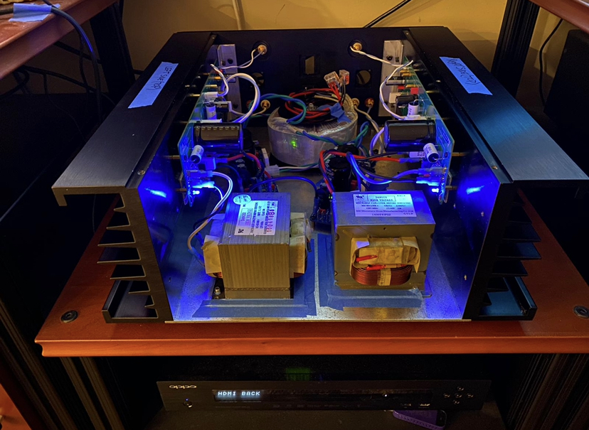

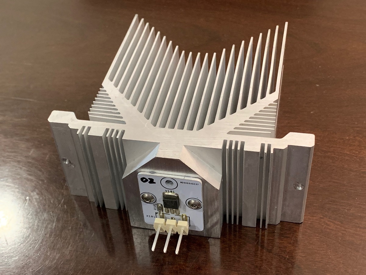

Here is a closeup of the completed amp - all of it fits on the little veroboard - except the LU1014D and the 67mH (0.5ohm DCR) microwave oven transformer (you can get surplus (MD 803AMR model) ones similar to this one on eBay), which are attached with 18ga silicone wire flying leads and pin end crimped tips for the screw terminal blocks:

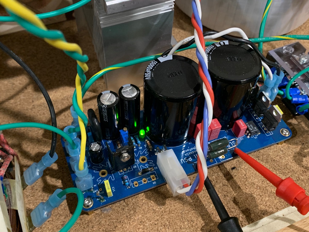

I am using an active bridge (LT4320) rectifier, with a CRC, and a BJT cap multiplier single rail PSU (I measured ripple under 3A load at less than 1mv rms). Although, I think this amp has decent PSRR due to the cascode feedback - so a conventional CRC might just work swell without audible hum:

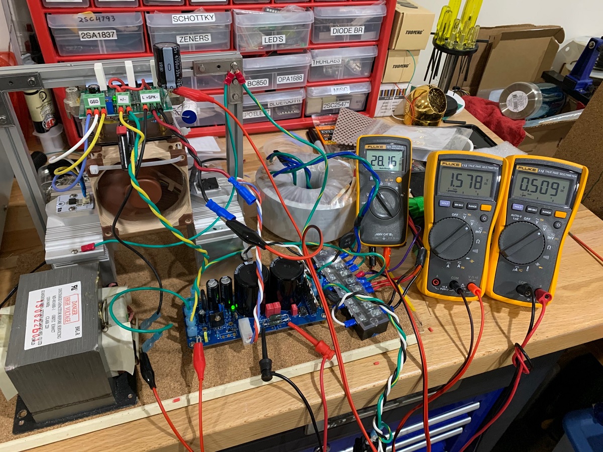

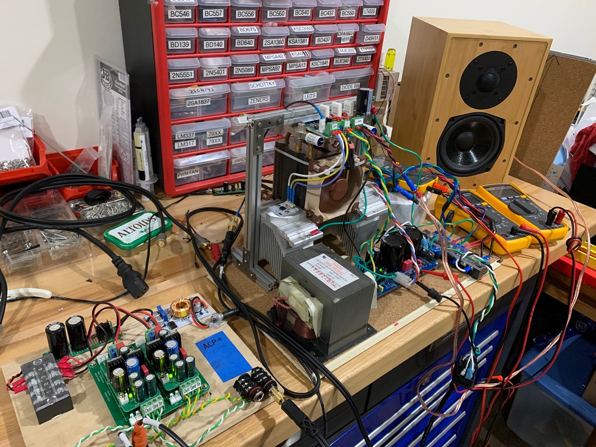

Here is the first power on test, the amp reached 3A bias current, the voltage at the LU1014D source pin was around 1.5v, and the voltage at the LU1014D drain pin was around 4.2v - pretty much spot on from the simulations. No magic smoke was emitted, and everything was stable. I adjusted the trimpot slightly to achieve about a 3v difference between the drain and source pin of the LU1014D:
I then connected the Pass ACP+ as the preamp - knowing that this will not achieve the full power since it does not have the ability to put out 50Vpp swing - but it will let me test the sound a reasonable volume:
Here it is playing music - it sounds great! I also tried it with a Melbourne preamp that can swing 55Vpp and it does indeed play loud. The bass impact is particularly good for a SE Class A amp. The combination of the low Rdson of the LU1014D and the reactive load of the 67mH microwave oven transformer (MOT) combine to give this amp a predicted damping factor of 157 at 50Hz:
This amp sounds very nice - smooth and similar to the MoFo, but with a different - more muscular feel, perhaps a bit less distortion. It certainly is easy to build and if you already have a MoFo, you are 80% there. It works fine at 20v or 24v too - just lower output power.
It is a simple and easy amp to build - you will need either a Hammond 193V inductor or pull one from an old microwave oven (or buy those on eBay for about $25) and a powerful preamp if you want to reach the full 39w potential.

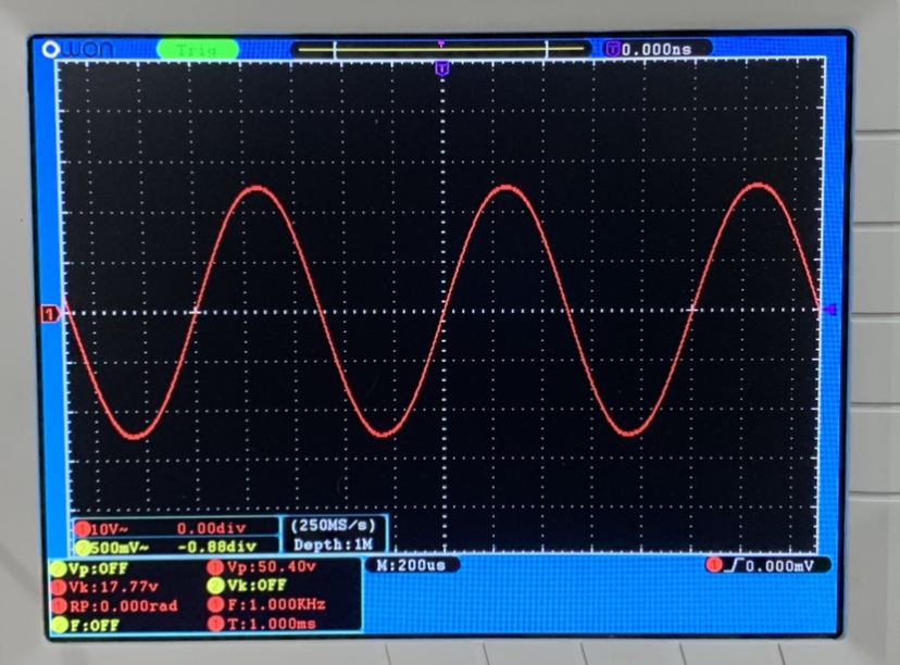

Edit May 26, 2021: max power before onset of clipping is 17.77vrms into 8ohms. That’s 39.5w.

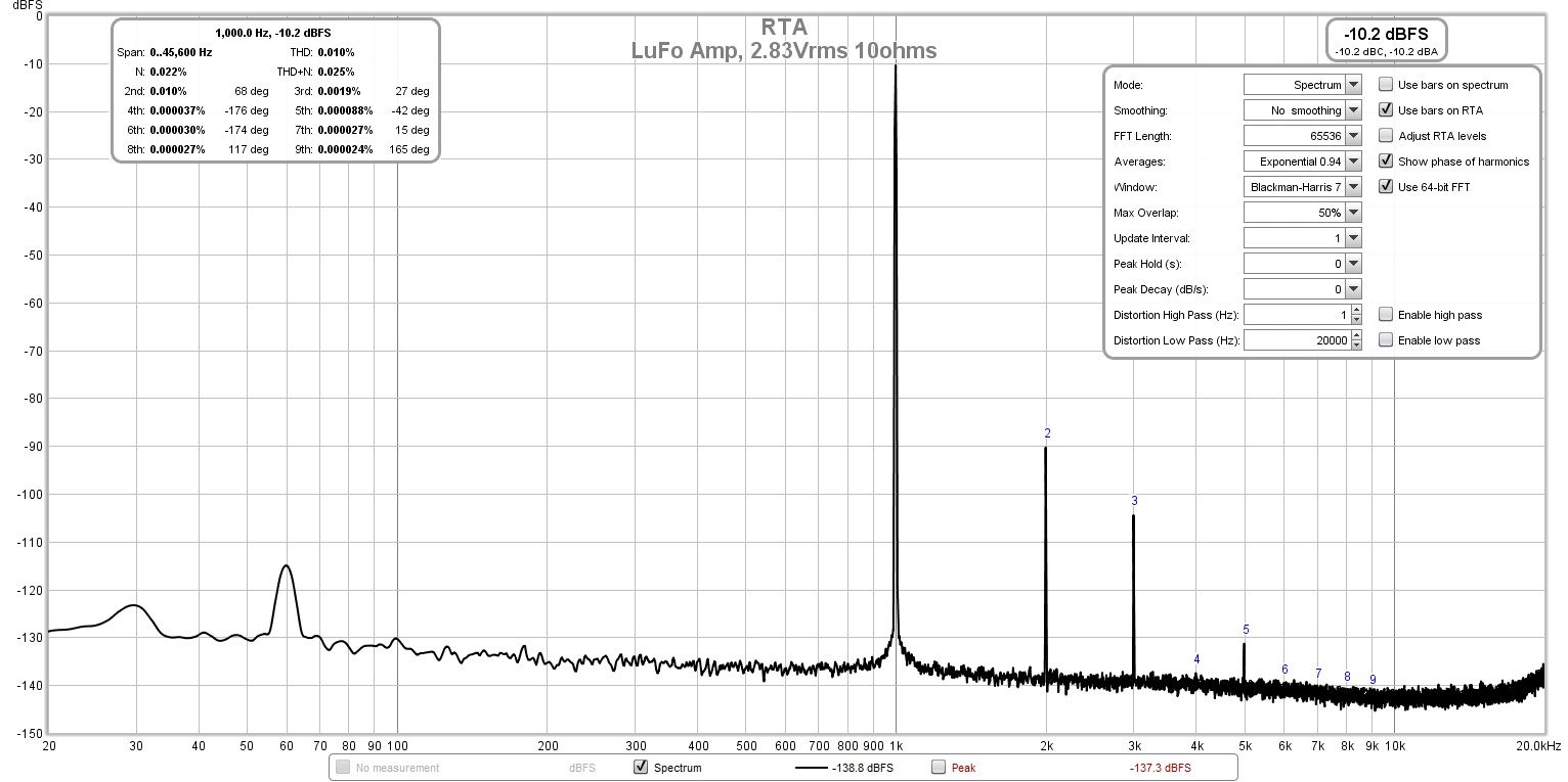

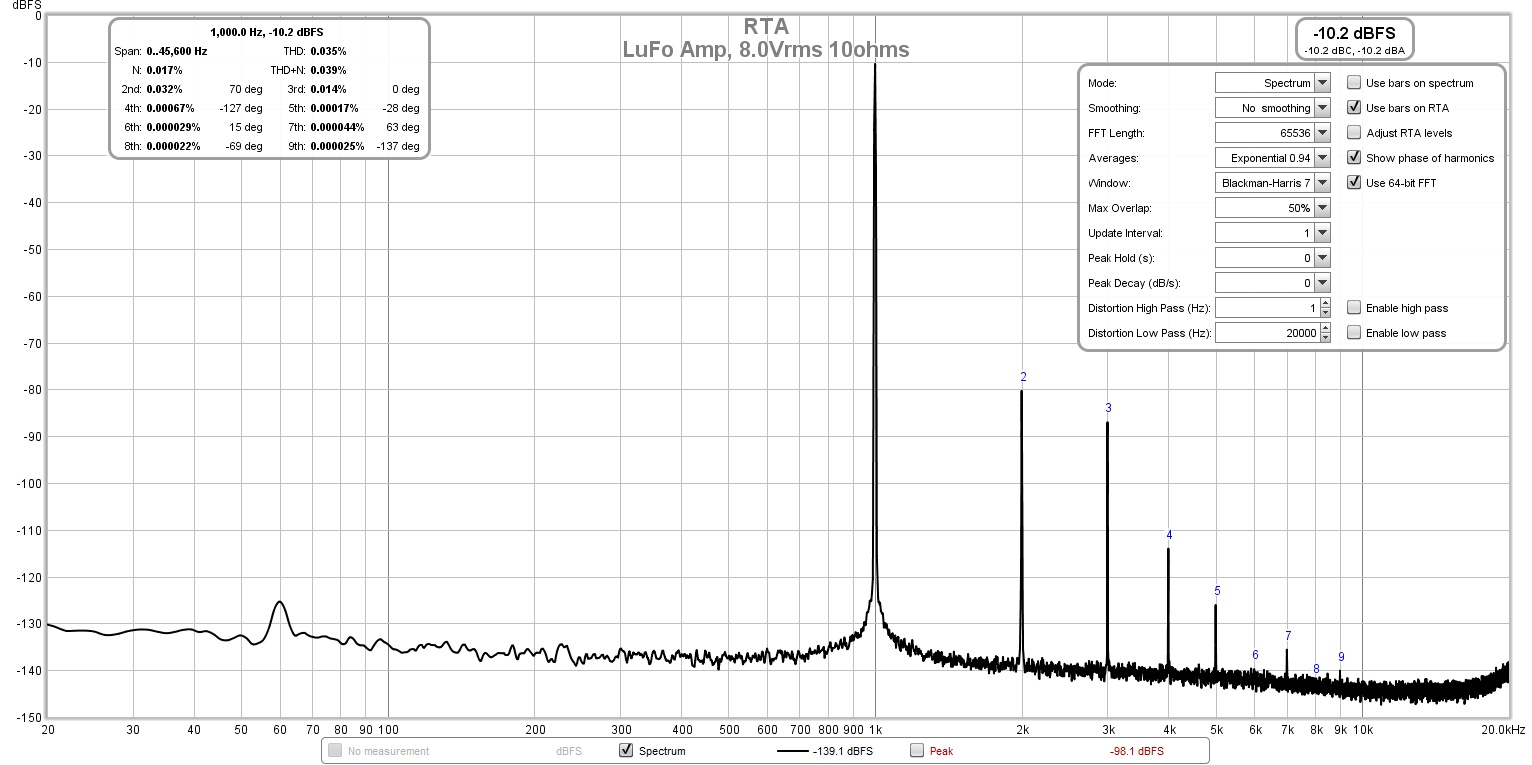

Edit May 24, 2021: Measurements for 1kHz 2.83vrms into 10ohms
8Vrms into 10ohms:

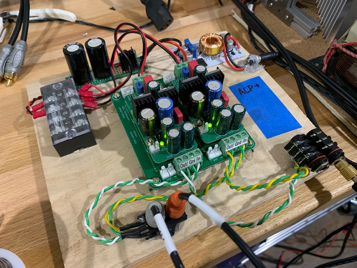

Prototype LuFo UMS compatible production board built by Vunce:
June 25, 2021 - Vunce’s verification build in stereo:

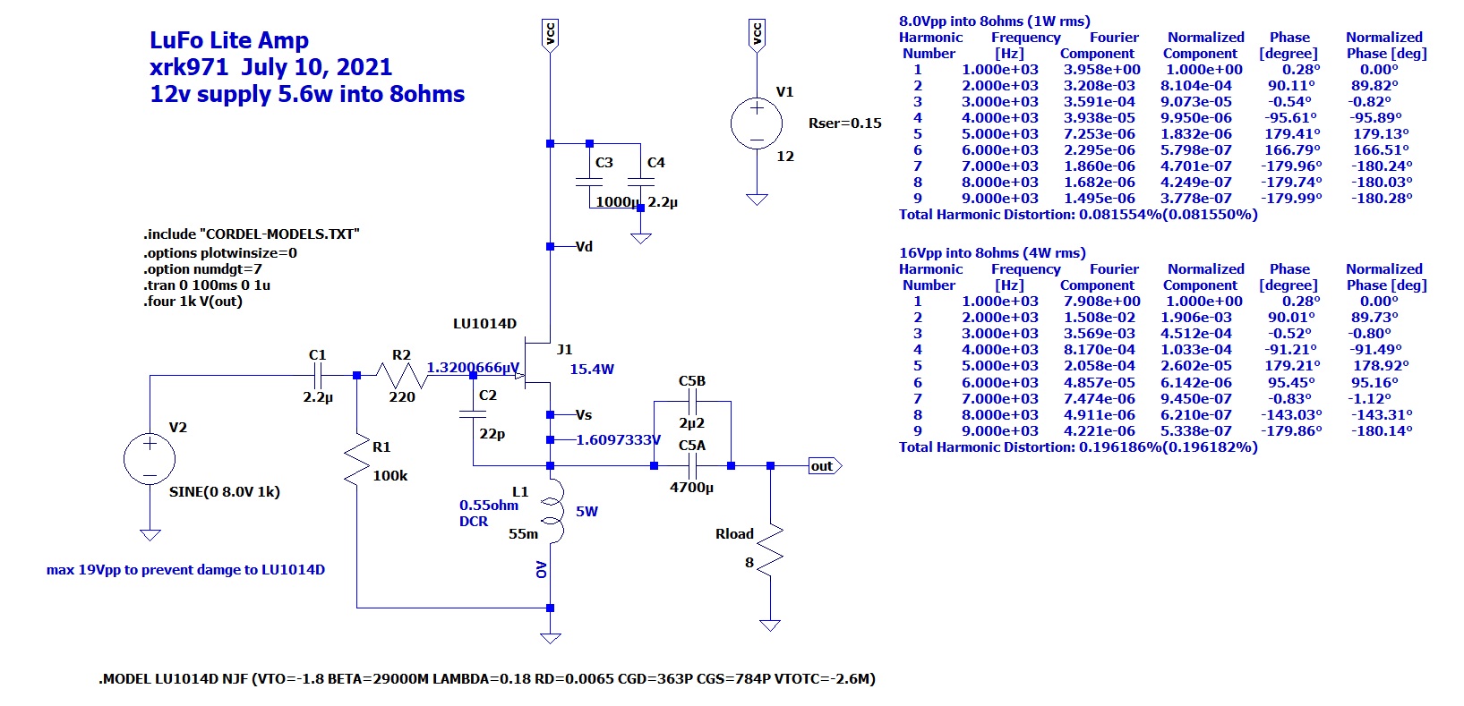

Edit July 10, 2021: LuFo Lite - a 5.6W 12vdc supply LuFo without a cascode:
