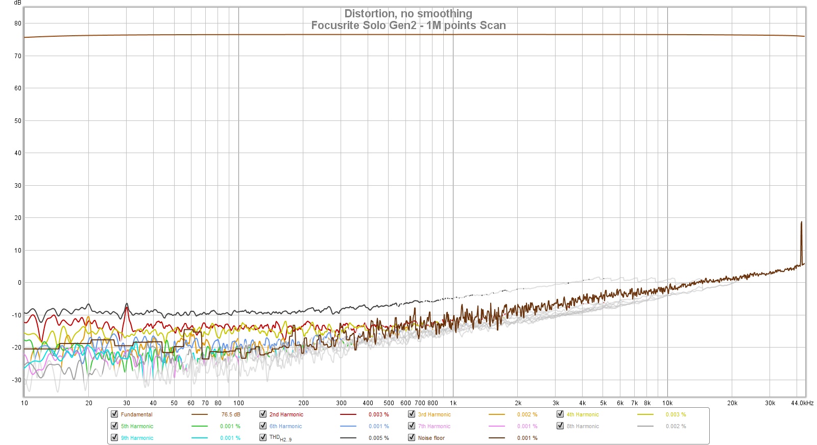

A frequency sweepusing REW will get yout the freqeuncy response as well as the variation of harmonics vs frequency.
Howto - Distortion Measurements with REW
Wtnh made a very nice diagram to show how to set this up (any sound interface with balanced input can work here - I typically use Focusrite 2i2 or 2i4):
877780d1600788493-howto-distortion-measurements-rew-emu-setup-png
Here is a distortion/amplitude vs frequency sweep of the Focusrite in loopback mode:
760764d1559613892-howto-distortion-measurements-rew-solo-gen2-freq-sweep-1m-jpg

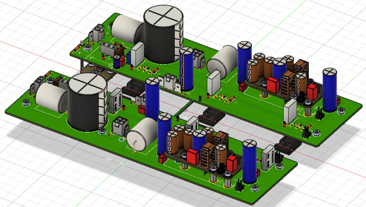

JPS64 has made some nice progress - here is the schematic and layout so far. If anyone has questions or comments/suggestions, please don't hesistate to ask. This is designed for use on a DIYA Store UMS comaptible heatsink for easy mounting.
We have made provisions for the optional M2X/Yarra format front end board mounting bolts. This will require you to use a separate power supply (to be provided by user). Or you can just use it as a 0dB gain amp like a MoFo or an F4. We also have optional connectors or direct solder flying leads for those who prefer that.
attachment.php
The rev 0a (initial) schematic is attached below as PDF.
Thank you, JPS64! Another beautiful, symmetric looking layout.

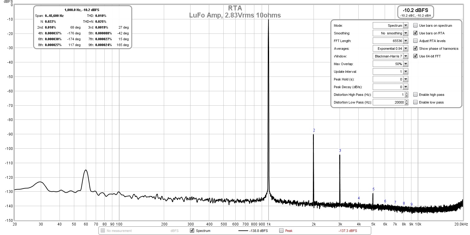

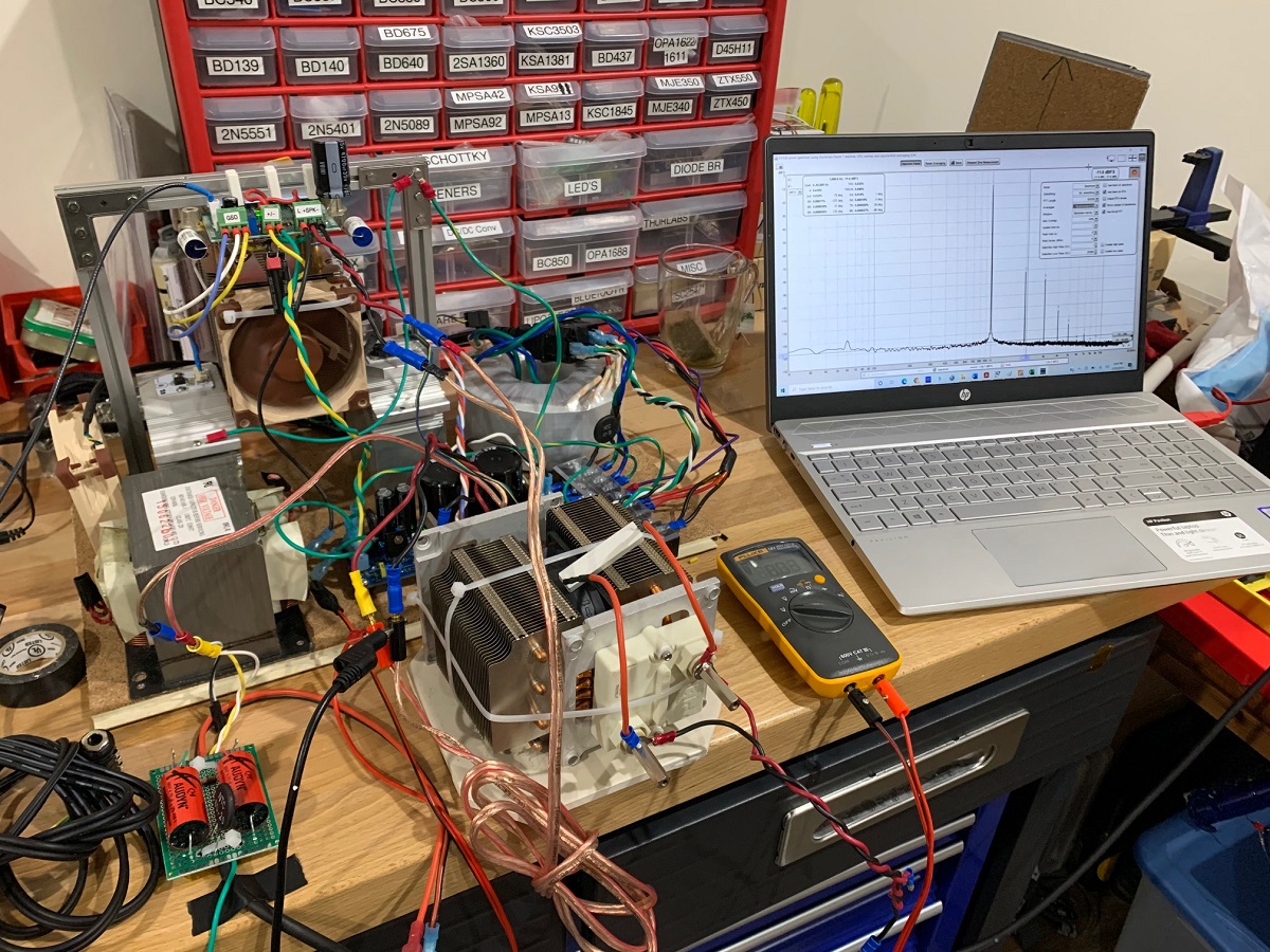

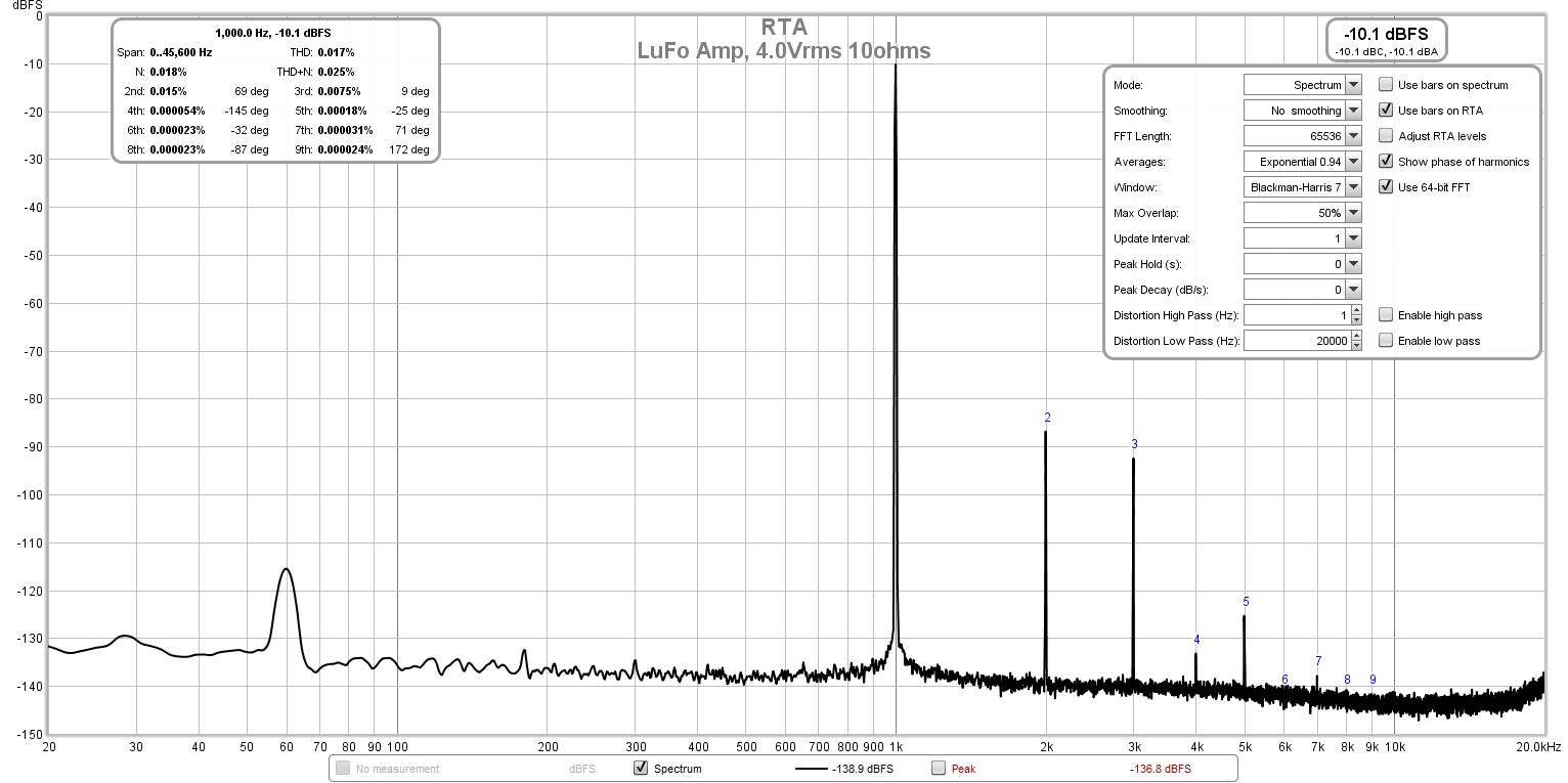

Once I have a chance to listen to an amp subjectively for several days, and I can hear all the things I like or don't like about it, I will then take measurements. The reason I do it this way is so I do not bias my subjective opinion with the data. As I said before, this amp sounds so good - perhaps one of the best amps I have heard. That usually means that it has very low noise, a good 2nd order dominant harmonic profile, and monotonically descending higher orders. It also means that usually, the third harmonic is about -10 to 15dB lower than the second harmonic, and there is very little of higher orders beyond 3rd or 4th at lower powers.
The measurement setup is same as I have used many times in the past: Focusrite 2i4 sound interface operating in ASIO mode, REW software, 10ohm non inductive EBG 300w thin film resistor, and balanced 10:1 signal attenutator for the inputs. This time, since this amp is not an ultra-low distortion amp, I used simply a 1kHz test tone FLAC file played by a high quality digital player (Cayin N3 with AKM4490 DAC). Fluke 101 meter to measure the RMS voltage. I am using the Aksa Lender as the preamp here to get some gain to drive the amp.
Photo of the setup, you can see the heatsinked dummy load resistor in the foreground and the balanced signal attenuator with the two 4.7uF 250v MKP film caps to couple the signal to the audio interface.
attachment.php

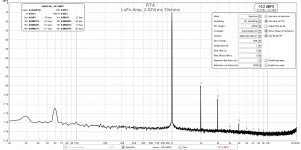

Here is 2.83Vrms into 10ohms - we get 0.010% THD and a harmonic profile very similar to predicted for 8ohms. There is a small bump at the 5th harmonic, although very low - this might be a problem at higher powers if it becomes too high. We will keep an eye on it. The noise floor is very low circa -125dB (not including the 60Hx bump) and clean and free of hash. There is a 60Hz bump, but I believe that is just pickup from the EMI in the air. It is still down at -105dB:

Here is 4.0Vrms into 10ohms - we get 0.017% THD:
attachment.php

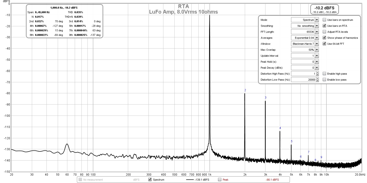

Here is 8.0Vrms into 10ohms (a quite loud playing level for average music), 0.035% THD and still a dominant second harmonic and lower higher orders. The 5th harmonic here is not a problem as it is just part of a progression of decreasing higher orders harmonics:
attachment.php
This amp measures very well. At this point, I could not do higher powers as my signal generator and preamp combo were not set up for it. So far, it is behaving very closely to the simulation. Looks like the grounding and the choice of PSU made for a very quiet amp as well.
