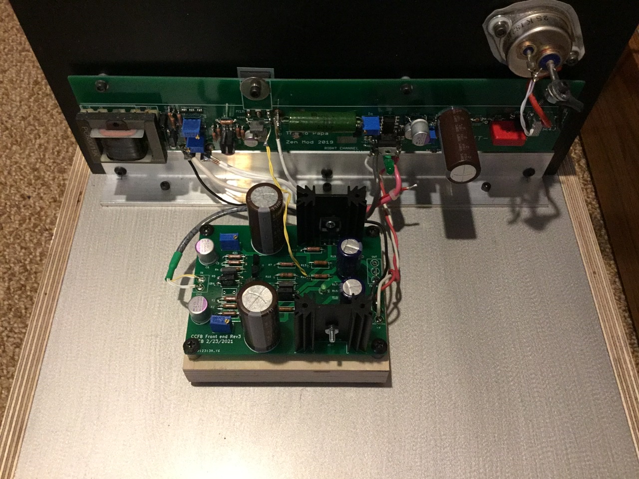

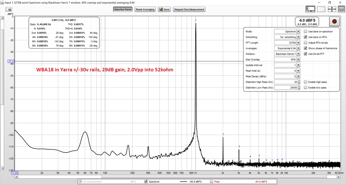

That’s great news - because there is already an M2X format WBA18 preamp module that can fit into the LuFo amp main board. One just needs to provide it +/-28v. Which could be done using the new double mezzanine DCDC with revised resistor programming values to achieve the lower voltages. Or use an external PSU (could utilize the existing secondaries from main transformer). Thanks for pointing that out. In fact, my memory is now jogged and I recall running the M2X format WBA18 at +/-30v:
Here was FFT with 29dB gain:
On my implementation I recall it ran rather hot - it could probably use a bit of a lower bias current if only driving preamp line level loads vs headphone loads.
Or one could use the WBA18 externally, which many people have built already from the giveaway.

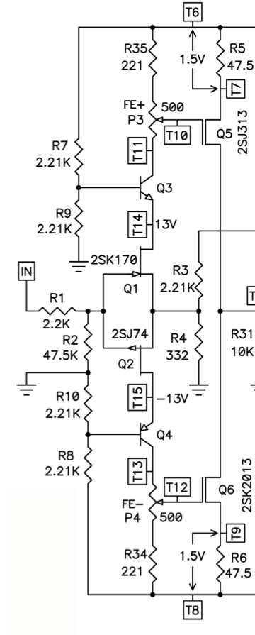

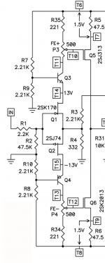

It is often interesting to look at the development history of the designs that we use. Here is a schematic of the original 'purple' BA2018 line stage, annotated by 6L6. This version originally used smaller output devices before being modified for use as a headphone amp. In this form, it was Ok to run at +/– 28V, perhaps with some care to keeping the outputs from getting too hot. I think some small tweaks to the output bias could make it safe to run at +/– 30V. Perhaps increasing the emitter degen resistors from 27Ω to 30Ω? There are small clip-on TO-92 heatsinks that could be used as well.

Is there a publicly available BA3 preamp PCB with cascoded input JFETs that can be run at + / - 30+ v? I suppose one could use the DIY store VFET PCBs.

That is a schematic. My ask was a PCB.
Sorry. I was just nodding in agreement when I realized the front end of the diyaudio VFET was a BA-3 lookalike!
Best,
Anand.
No, but here are the files. The rev 3 schematic is just updated values.
It has a few modifications but can be used for the original circuit as well.
