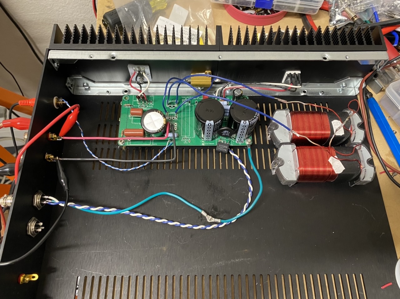

Jwjarch’s LuFo Lite is working out well on first verification build.
More details here:
LuFo Lite - a 1 Transistor SE Class A Headphone Amp
More details here:
- LuFo Amp - 39w SE Class A from 28v Rail
