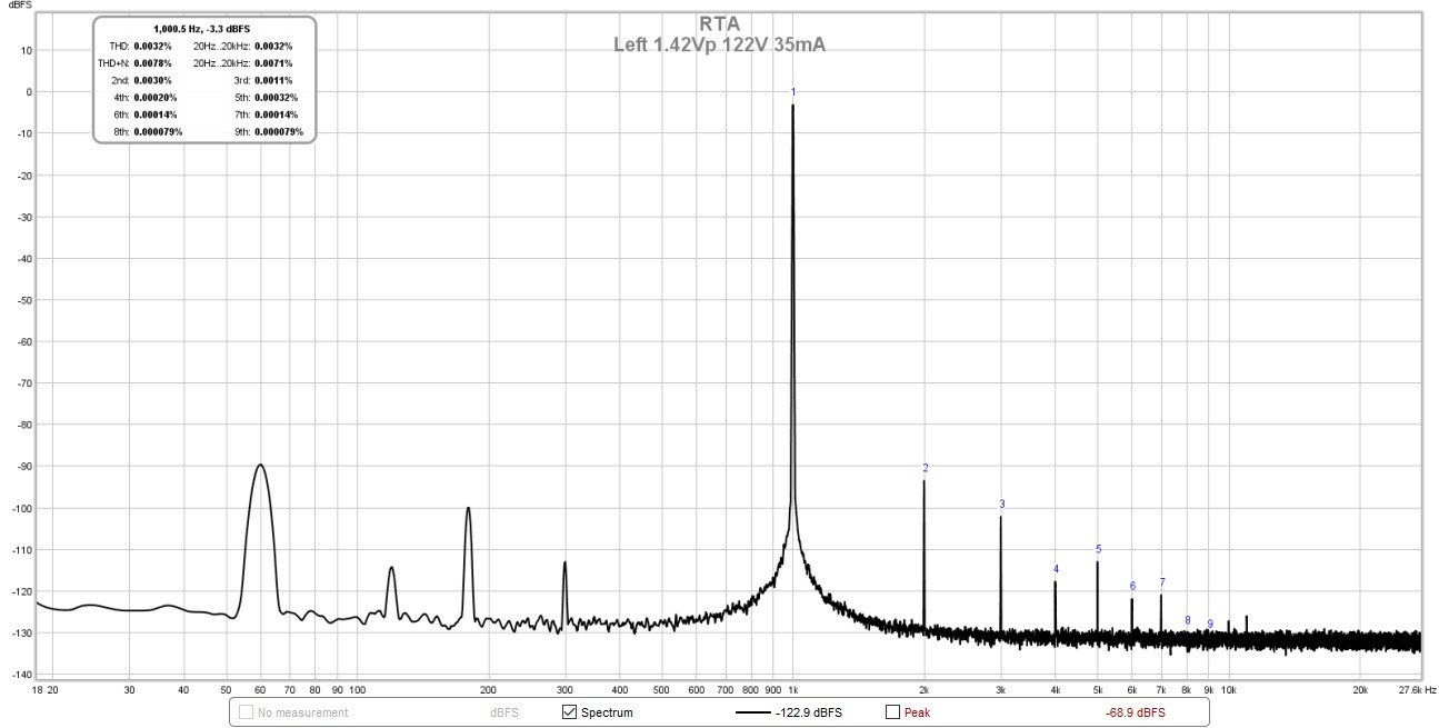

It's a funny thing. I thought that this was my first time using the Hammond 157G as choke loads, but that's not true. I had completely forgotten that I had used them in my 2SJ28-2SK180 amp build (https://www.diyaudio.com/community/threads/mo-chokes-building-2sj28-2sk180-monoblocks.370479/). I was looking at the notes of that amplifier and was surprised to see that I had used 157Gs. After reviewing the distortion results of the 157G loaded 2SJ28 VFET of that amp, I just had to try that operating point with the 2SK82s in the revised LuminAria.
Luckily, it was fairly easy to change the voltages. The LuminAria power supply is regulated to about 140V and when I converted to fixed bias, I used a RC stage to drop the Vd to compensate for no source resistor. So, it was just a matter of shorting out the voltage dropping resistor in the RC filter to get 140V at the choke.
After fiddling around with the the gate voltages, I managed to lower the distortions again. Good thing I checked the notes on my 2SJ28-2SK180 amp.

I built the CCS version with a pair of DN devices. Sounded awesome! Also had a negative bias on the gate with source at ground. But I am glad to hear pinholer is liking the choke loaded version. All roads lead to Rome, as ZM would say. :up:
