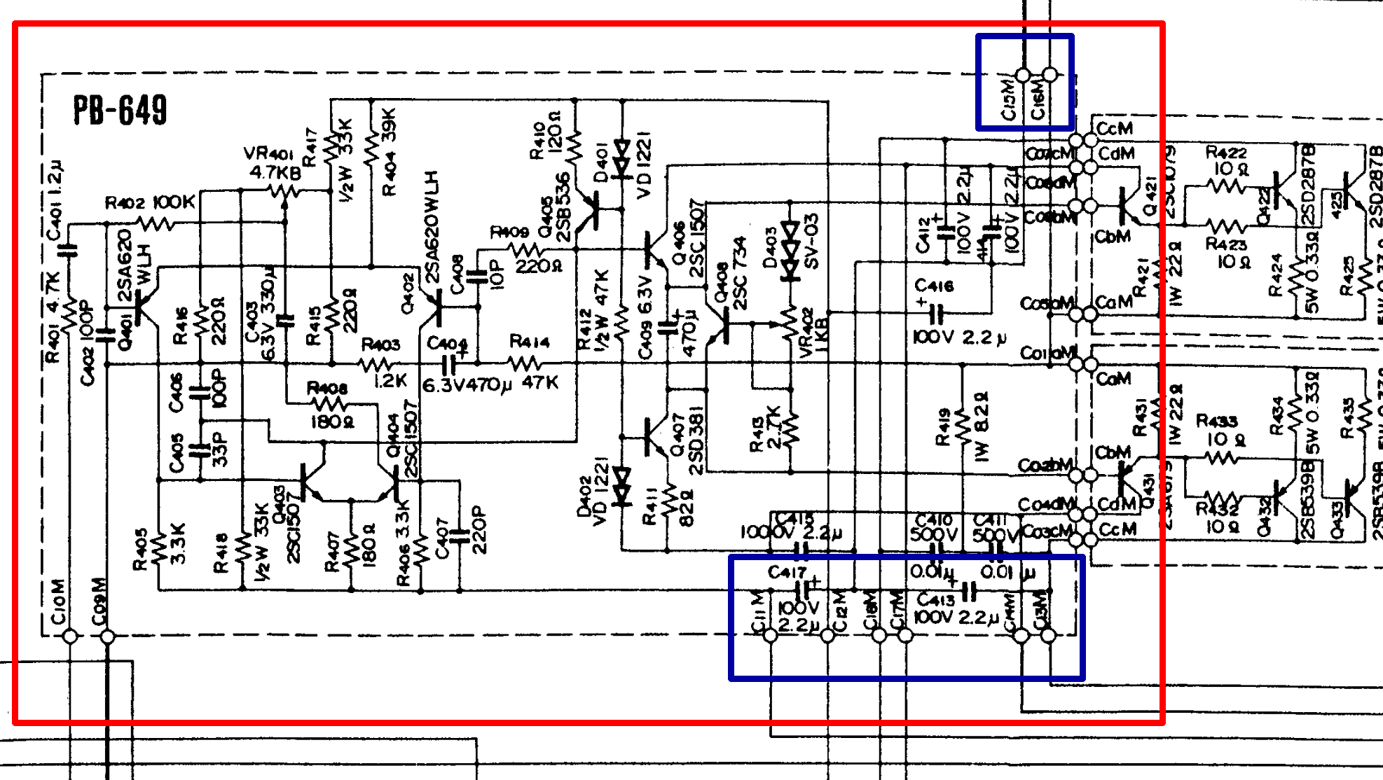

This is the answer for which I was waiting for, you said single channel will work and must give sound. I removed the inputs of PB649 @ connector C09M >C10M that is I think coming from pre stage to verify that there is no DC bias voltage coming from pre stage to drive stage.In my view, the -4 Volt offset on both speaker outputs L/R indicates that there is a common problem and then I end up with power board P647.
The amplifier should also be able to work with one power output board.
Your English is better than me. Yes. My friend who made copy of Musical Fidelity A1, He used complementary pair of transistors MJ series he suggested that I can get from him a pair of MJ802 PNP (TO3) package as a replacement for testing only, until I get 2SD287B. Power stage transistor. What you suggest.
Touch mute is also not working. I think Mute means no sound from amplifier or attenuate the sound once touch. Please guide if possible for you.

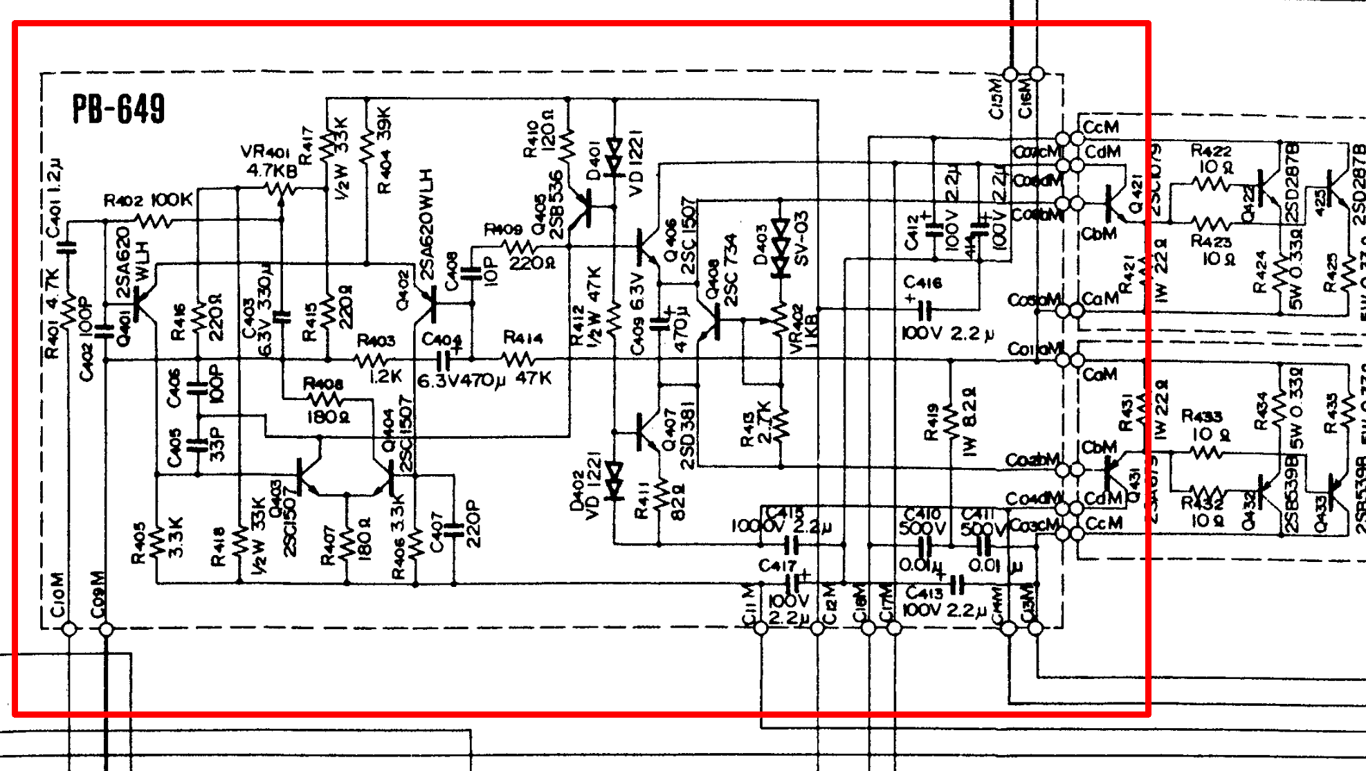

Now again your expert opinion required about board P649.
Referring to connector C11M>>>>C18M. Power supply (C18M,17MRed +55 volts then C16MBlue {seems output} then C15MBlack {0 reference volts} then C14,13MGrey {-55 volts}, then C12,11M {48Volts}
As per your guidance voltage should be 48 volts because of two zener diodes on both sides but here volts are 54 on C12,11M these should be 48. Let me calibrate from three trim pots on P647, may be it works. If not then it may be due to damaged zener diodes 24 volts which are in series. Let me find and reply here.

I would start at the front by measuring the voltages with ground as reference and start with Q901/Q902, especially what are the emitter voltages and what currents flow through them and so on. And also measure the alternating voltages on the bridge cell. And what is the ripple voltage after rectification?
And the measured maximum positive voltage of 54 Volt also remains on the low side. Forget that 48 Volt because that is a reference voltage for the power supply itself and is not the output voltages.
The 48 Volt is made with two 24 Volt zeners in series,
one is used in combination with an emitter follower (Q507/508) for the 24 Volt voltages that feed the pre amp.
The input connector on board P649 must be connected because the ground is important for P649.
