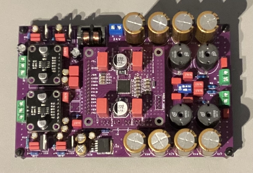

So... how does it sound!
Very nice card in my eyes! and full of possibilities...Bravo!

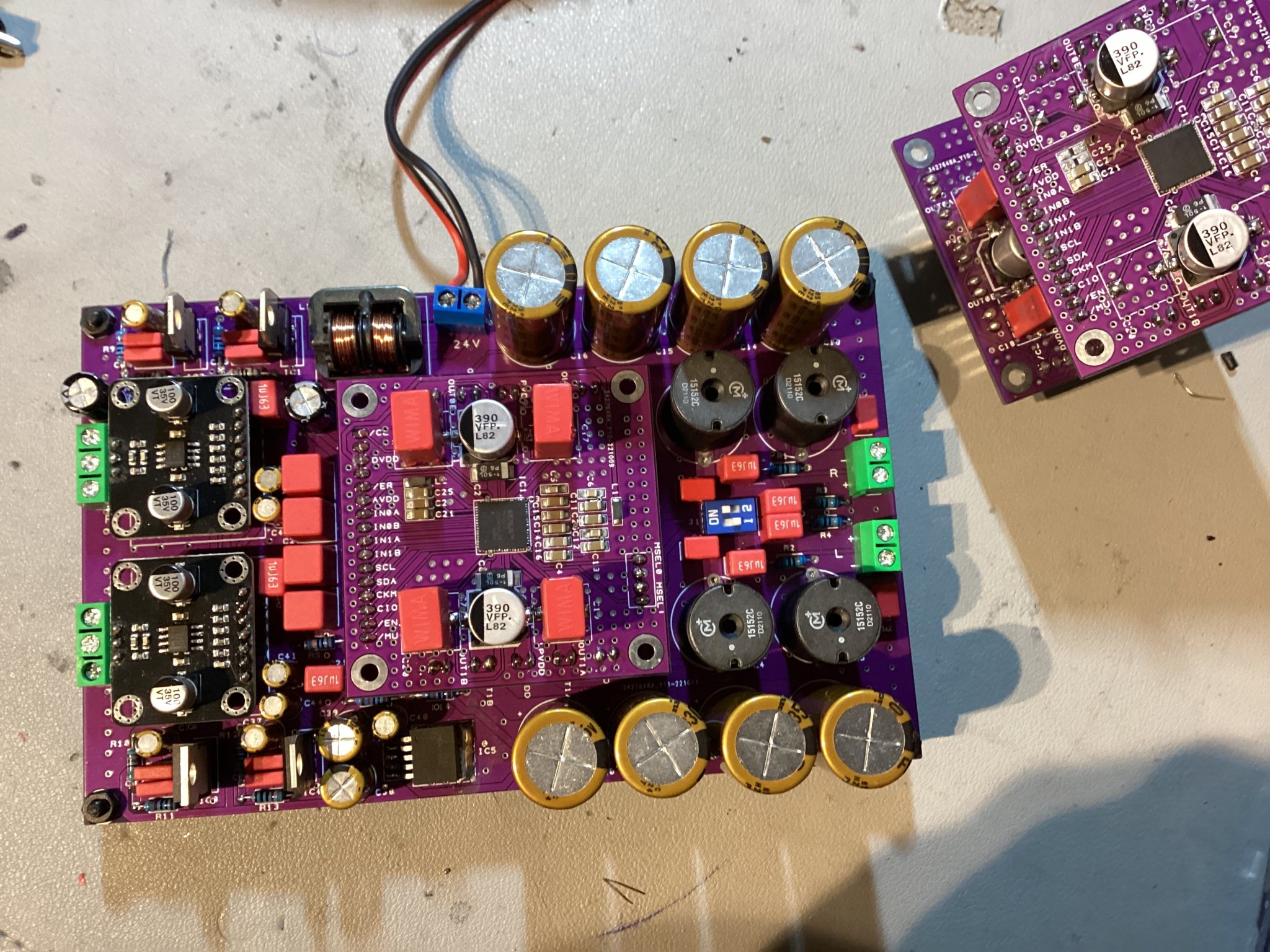

Just expect 5 MA12070 chips. Next weekend i will test them.
You sure know but please work ESD safe. I had a defective device from a member and experienced a defective chip myself after working non ESD safe (“just once won’t harm”, “hurry” etc.).
Both had an internal short, a crack in the IC and they did not have DC output thankfully.

Well, reliable is a bit of an assumption as it is still too young to judge it on that aspect. I have seen 2 defective ones till now that died all of a sudden. I am careful with MA12070 and no load, I think it does not like it to be powered on with no load.

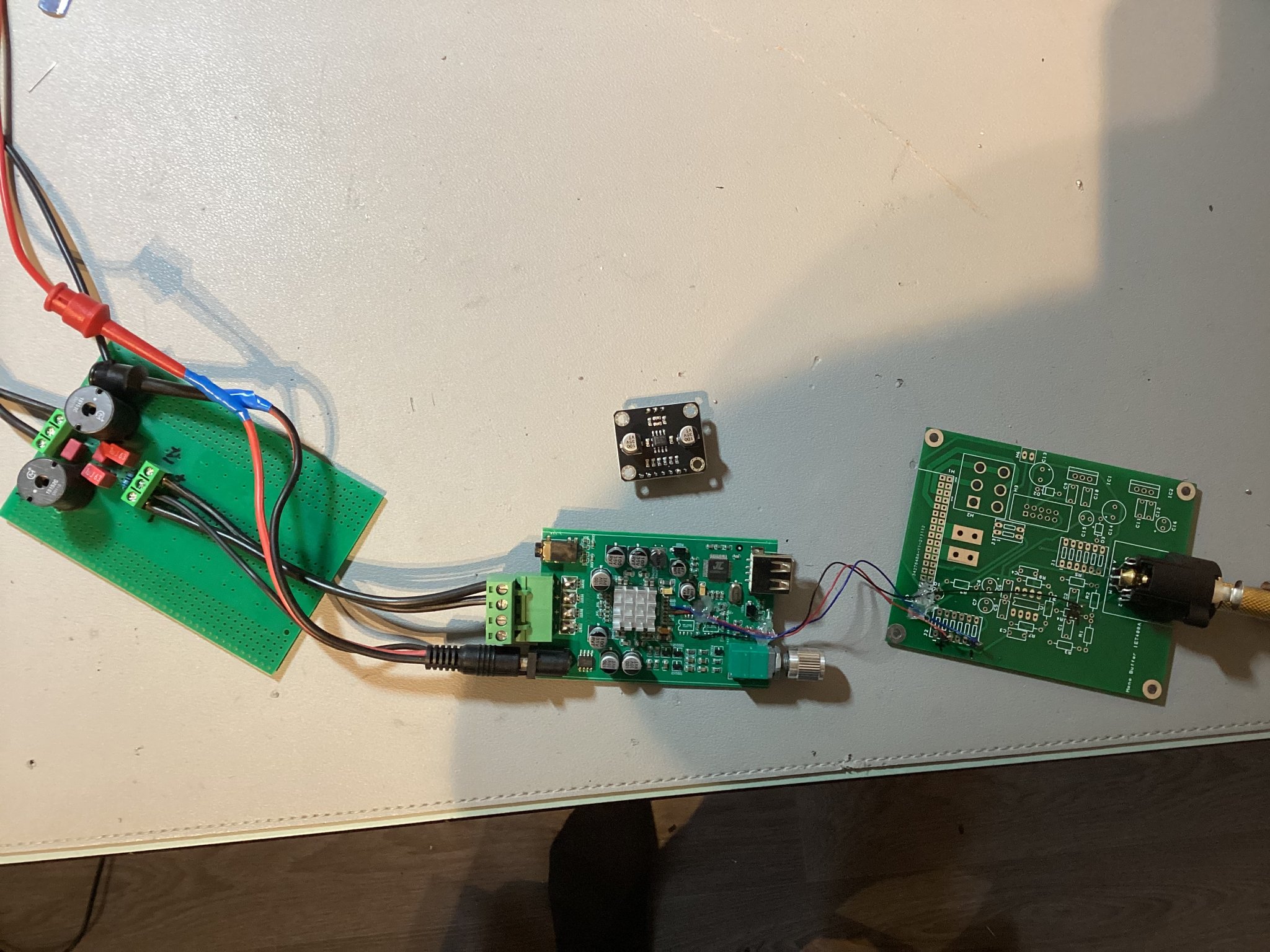

At last, after three faulty ma12070, this one is functioning.
The chip is very difficult to solder. Listen impression will follow soon.
Everything about this PCB looks lean and mean, even the opamps 🙂 I think it's enough to make several TPA32xx boards blush in terms of complexity and hopefully, sound quality too.
I have problems with blowing up channels. Had five chips and using now the last one. The sound is nothing else as my chinees ma12070 board. Besides it is very difficult to solder the chip. The amp plays a view days and the next time one channel is blow up.
Until yet my board is not sounding better. And leaves me with my first impression of a some what weak amplifier for my dynaudio speakers.
You might be getting oscillations and/or static issues due to fairly long-ish tracks associated with that MA12070 plug-in adaptor boar.
