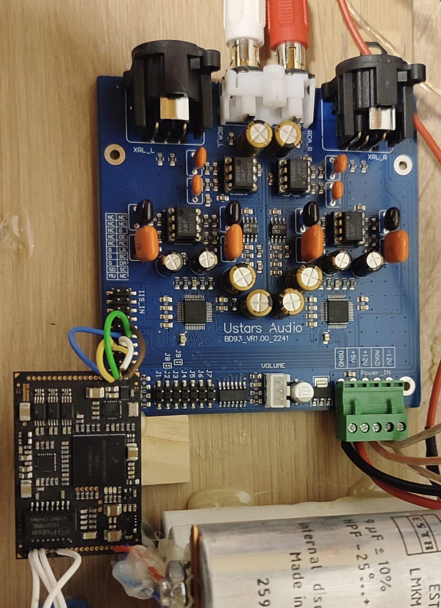

The least interesting part of DIY is the machining of the case...to integrate the DAC outputs with the rear panel.
I realized that the DAC card is available without the output connectors... That would have been simpler.
Thanks for the tip, for me it would also be way easier to connect the outputs by wires to the ports on the rear panel.I realized that the DAC card is available without the output connectors... That would have been simpler.

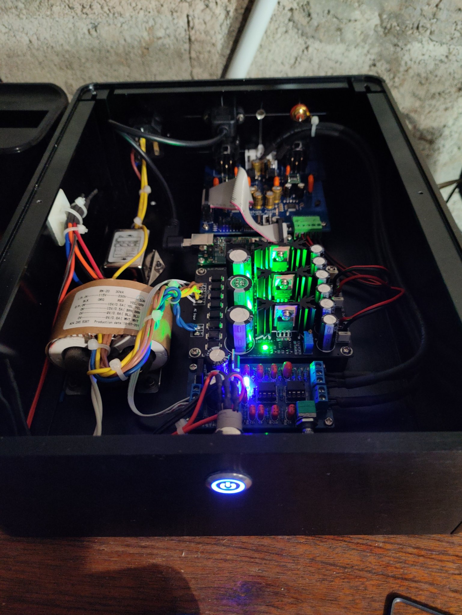

Way to long I2s cable.If it helps you...

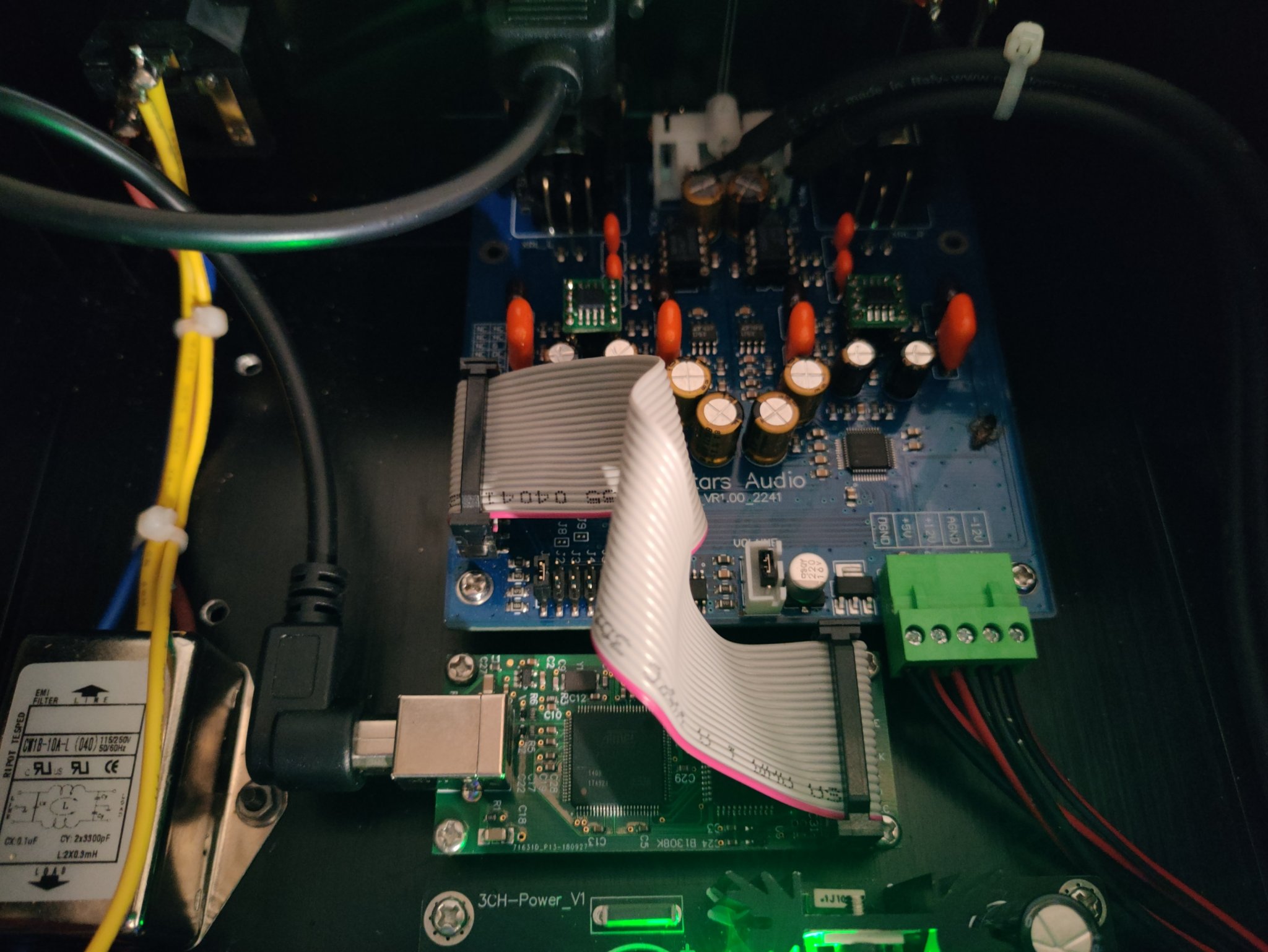

It's okay, 13 cm....Originally it was an IDE hard drive ribbon cable.
The ribbon cable delivered with this optional card is 10 cm.
No interference, nothing....Even when touching the ribbon cable with your fingers.

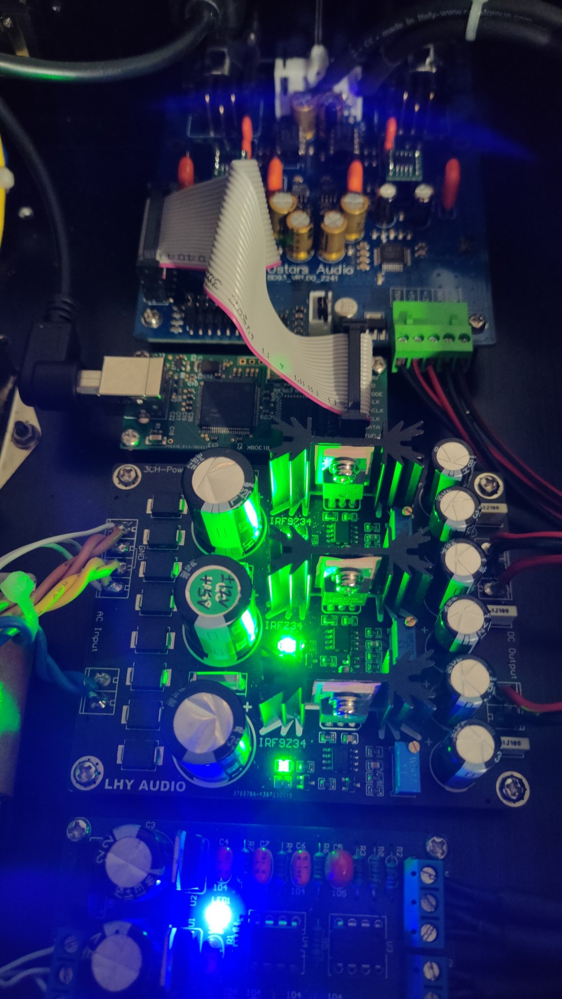

I replaced the double JRCs, as you guessed it with opa1656, the single JRCs for the rca remained in place.you cannot replace them with opa1656, try opa1655 or something else!
I like this card! It outperforms my smsl M300 ak 4497 dac....
