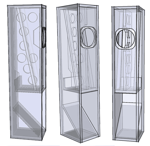

I'm using Maple Plywood 3/4 no void 10 ply. Biscuit joining all joints. The triangle at back of CC, can the slope of the triangle be arced? I can make a cove on the tablesaw. I was thinking of covering the exposed plywood edges with 1x3/4 Black Walnut. Which would mean plywood-wood-plywood joint on the corners. Good or bad? It'll be pretty. Mind you, that'll be all biscuit jointed, making the biscuits cross/interlock. Thinking of spacing them 3-4 inches apart.

Secips said:The triangle at back of CC, can the slope of the triangle be arced?
The purpose is to have an obstruction between the 2 port exits, so shape shouldn't be overly critical.
Chris built some like this... a lot of work, but gourgeous. I don't see any problems sonics wise.

Here's some half-chili-changs. I modified them a bit. I use a GR box and mounted the drive on the side. I decided on a GR box primarily because of the wide baffle. Located the driver, best guess using prime numbers, listening height and baffle width. The idea is to locate the speaker close to the sidewall and port firing into the center of the room. I could also couple the port onto the sidewall to get more bass. I'm playing around with them a I'll let you guys know how it works out. So far, its promising. I'm going to build a standard half-chili-chang to compare.

Just a quick word of warning here guys: shifting air-cavity dimensions to golden ratio or whatever is all very well (assuming I designed the original as a BR, not a QW box) -but it also means the waveguide shape will change, away from the original profile, which is carefully selected. So I can't guarantee it will work the way it's intended to in advance.

Anyway, some quick notes. Compared to the Fostex 15L VB. Bass is not as punchy but more articulate. Acoustic bass sounds far better. The Fostex is too punchy for my tastes anyway, gets tiresome after awhile. Imaging, details, timbre all much improved. Need to listen to it more... and test. I suspect that a hole around 1k is gone or reduced markedly.
