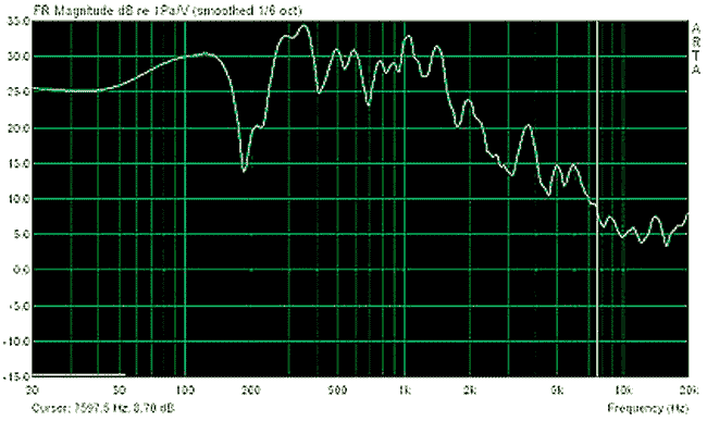

Found some time to take some measurements. I am complete Noob on this. So bear with me. I need help. Hopefully I get my LAUD system operational not easy to find a computer with ISA ports. More familiar with that one. Haven't done this since before I went to grad school. But I'm having fun
FR Graph of FE167E with mods. Taken at 1 meter. I've put some felt on the spider, diaphragm, basket and magnet. Used poster tac, which is like blutac for damping. The felt tamed a peak at about 7k. Although there is that hole around 4.5k working on it. I really like the idea of modifying the driver itself, rather than correcting it via XO. Its like a holistic approach

Here's the FR of the port. Taken at the port mouth. As you can see the is quite a bit of sound coming from it. Tuning the port via felt damping.
With 4 inches clearance around port. I find this amount of damping to sound best. But, its a work in progress.
Here's with 8 inches clearance around the port. There's a peak at around 10k that made everything too etched and sibilant.
As I've said, I need help. The speaker has a very open sound. Like a bipole. The sound coming from the port is mostly ambient reverberant sound. Gives a sense of "air." Worth investigating. I'm willing to do it. Just more fun for me. Its just going to take awhile. Well.... a long time
. I'm planning on increasing the bracing/deflectors to possibly reduce the felt damping. Seems to consistently give the sound more "air." If that doesn't work, I'll try different driver locations. Anyway, that's it for now. Thanks in advance for any help.
Historically, horns with too much scattered energy (self comb filtering) have their last reflection zone before the mouth damped with felt, ditto one of any parallel walls: http://www.audioanthology.com/audio3.htm

Thank You. Sir. I've got my homework cut out for me. So far..
![2220377839_1473c26cc2.jpg](https://farm3.static.flickr.com/2030/2220377839_1473c26cc2.jpg)
This is with the felt 8 inches away from port. I'll start reducing the felt inside the box.

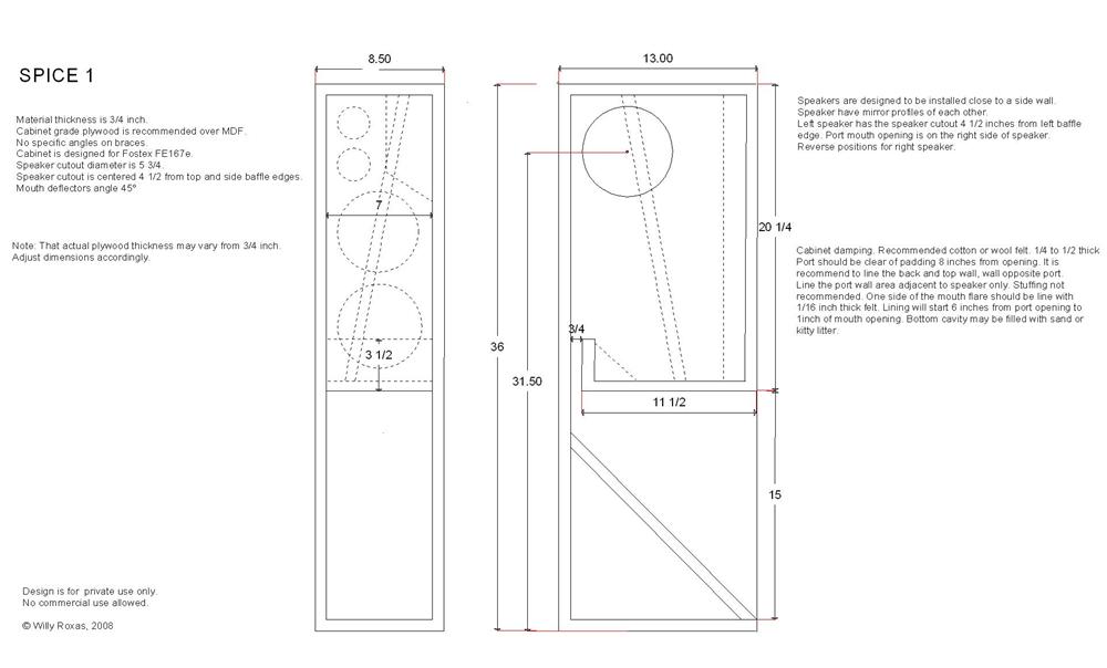

Well, I finally got to finish this speaker. Sorry, I didn't post sooner. On the greater scheme of things this is pretty low. Besides, its been real quiet here these past few days.
The port FR is OK. Just gives the right reinforcement to the imaging. A decreasing slope as it approaches more directional frequencies. Thanks GM.
This one is for the woodworkers and music lovers out there, the real DIYers. Nothing like the tactile feel of the real world. The aromas and feel of the wood as you work with them or the sound of a piano, like Lynne Arriale's, rendition of "I Loves You, Porgy" played like only a woman can play it. (DMP, With Words Unspoken) Simple things but pretty high on my list. Anyway, I've been warming up to plywood lately
As for the speaker, well its got a sound to it. A different character. That is why the tuning of the box is important. It really like "voicing" and not trying to get as much bass as possible out of it. Its an like an instrument, imparting its own character. You just have to hear it for yourself. Just add-to-taste
Thanks to P10 and Scottmoose.
Here are the plans. From the Good Ol' US of A!
