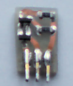

A limited amount of SMT work is possible to do by hand. Resistors, capacitors and SOT-23 transistors are easy. SOIC packages are difficult, but possible. I never managed anything smaller than that.
Attached is a photo of a PCB with SMT components I drew by hand. Admittedly I did design the PCB on a computer beforehand, but I could just as easily have done that on a piece of paper. The trick is, after drawing it with an etch-resist pen, use a knife or other pointy object to remove any etch-resist bridging traces. That lets you get some quite fine trace widths.

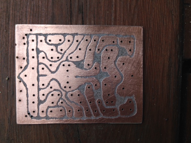

This weekend I made a PCB by the manual "old school" method for a one-off simple board but using a slightly different method.
1. Cover PCB in masking or painters tape. Thin tape with weak glue works best, I used painters tape.
2. Draw traces on tape.
3. Cut out along trace edges and remove the tape where the TRACES go. Where the tape is will be etched away.
4. Spray with a light coat of (automotive) primer. Primer dries faster than paint and automotive primer likes to stick to clean metal.
5. Wait 15 minutes for the primer to dry and remove the tape.
6. Etch. The primer will protect the copper. I use hydrochloric acid and peroxide as an etchant and it didn't even affect the primer after an hour.
7. Remove the primer with lacquer/acetone/sandpaper (I actually used my fingernails to remove 95% of it then sanded lightly with wet 600 grit).
This method doesn't have the problem of etchant lifting the tape or getting under the edges.
