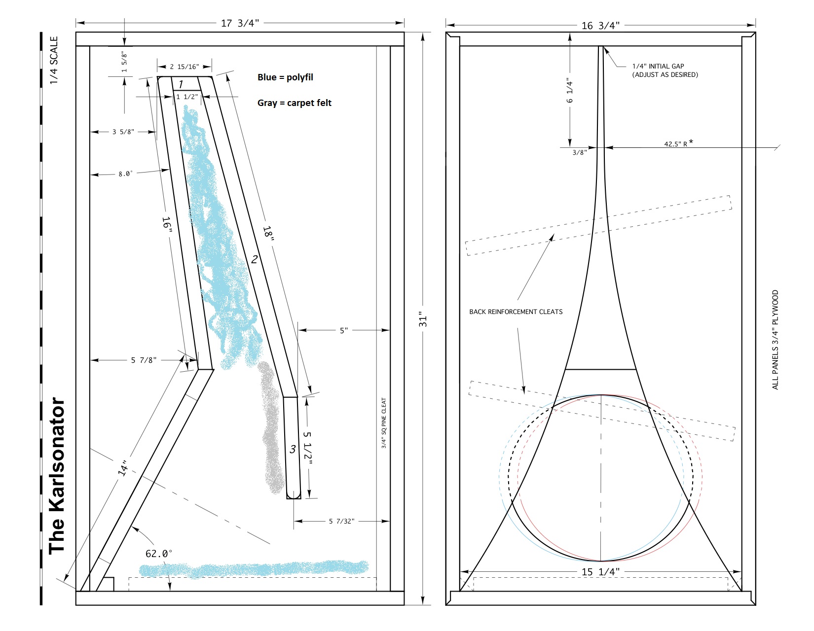

Awesome, thanks! I'm planning on making a 90 liter cab with 4" port and will experiment with fill and or dampening. My notch filter shout fix the midrange shout issues. What do you think of this plan of mine?
By the way, I was going to place the 4" port about 12" off the bottom of the cabinet, center ered wide to side. I'd love to try the Zu bottom vent, but don't have a reliable way to tune something like that. My dirty weekends have fantastic bass with the crazy bottom horn vent.
90 L falls within the 'window' between sealed and the pioneer's Vas/1.44, so OK, though assuming a 100 W max, Hornresp 'says' it takes a 5" dia. vent to get it down enough, so 4" may need damping using the 'click' test: Click Test | GM210 | Flickr
With such an acoustically small cab [max flat = ~402 L with only ~20 W max], looks like a ~ 33 Hz tuning yields flattest response, but recommend trying Fs first as a frame of reference since the room dominates down low.

Thanks for the info guys. Just for clarity sake, I "AM" building these cabinets for the Eminence Beta 12LTA. Although I'd prefer not to run a notch filter, I also don't want to do too much with physical modifications to the speaker itself. I am however not opposed at all to removing the dust cap if necessary. It seems like adding a phase plug has minimal effect and in my case probably won't make any difference. I guess we'll have to see.

This is an absolutely awesome idea and design. I am totally looking for something retro like this. I guess I need to do some more homework. Would you mind sharing the exact dimensions, venting if there is any, as well as dampening with me? I'd really appreciate it. Honestly I never even thought of a speaker cabinet design like this. Thank you very much.!.
here's the Karlsolnator 12 plan - the "stub" above the driver is the most critical place to damp and should be stuffed to taste with polyfil. Bonded Dacron or carpet felt could be used on other spots.
