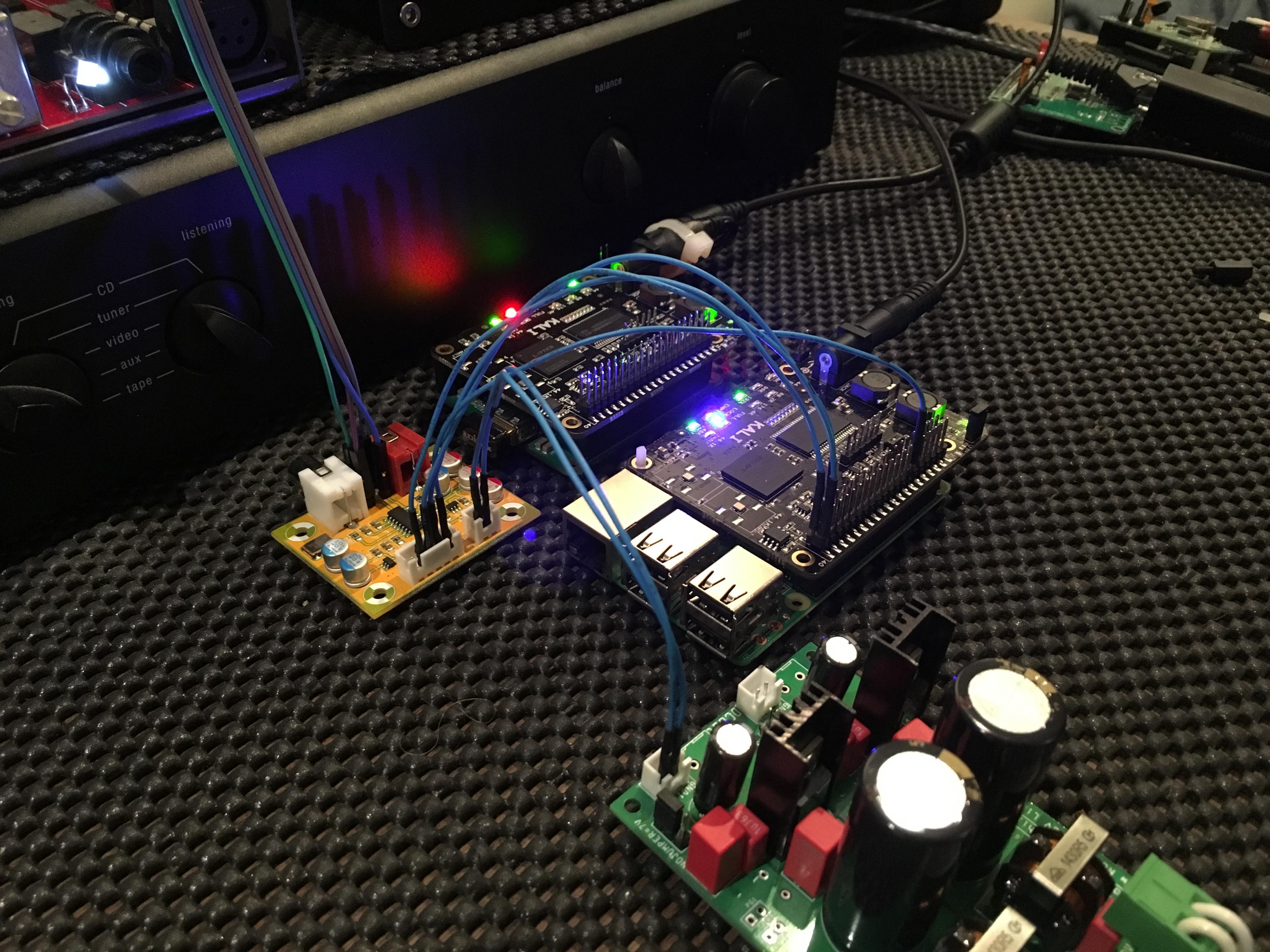

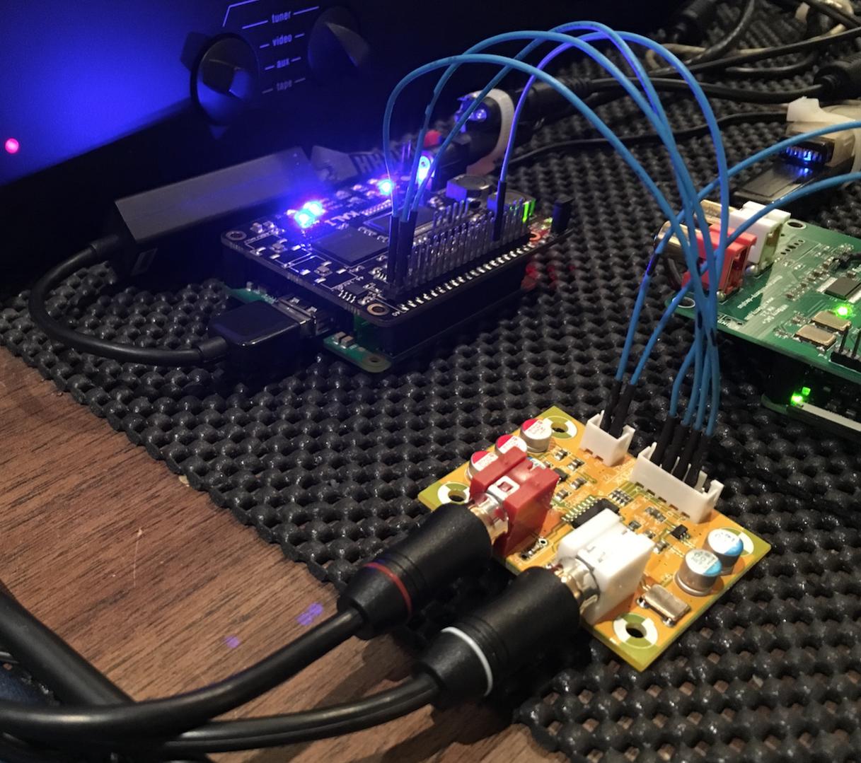

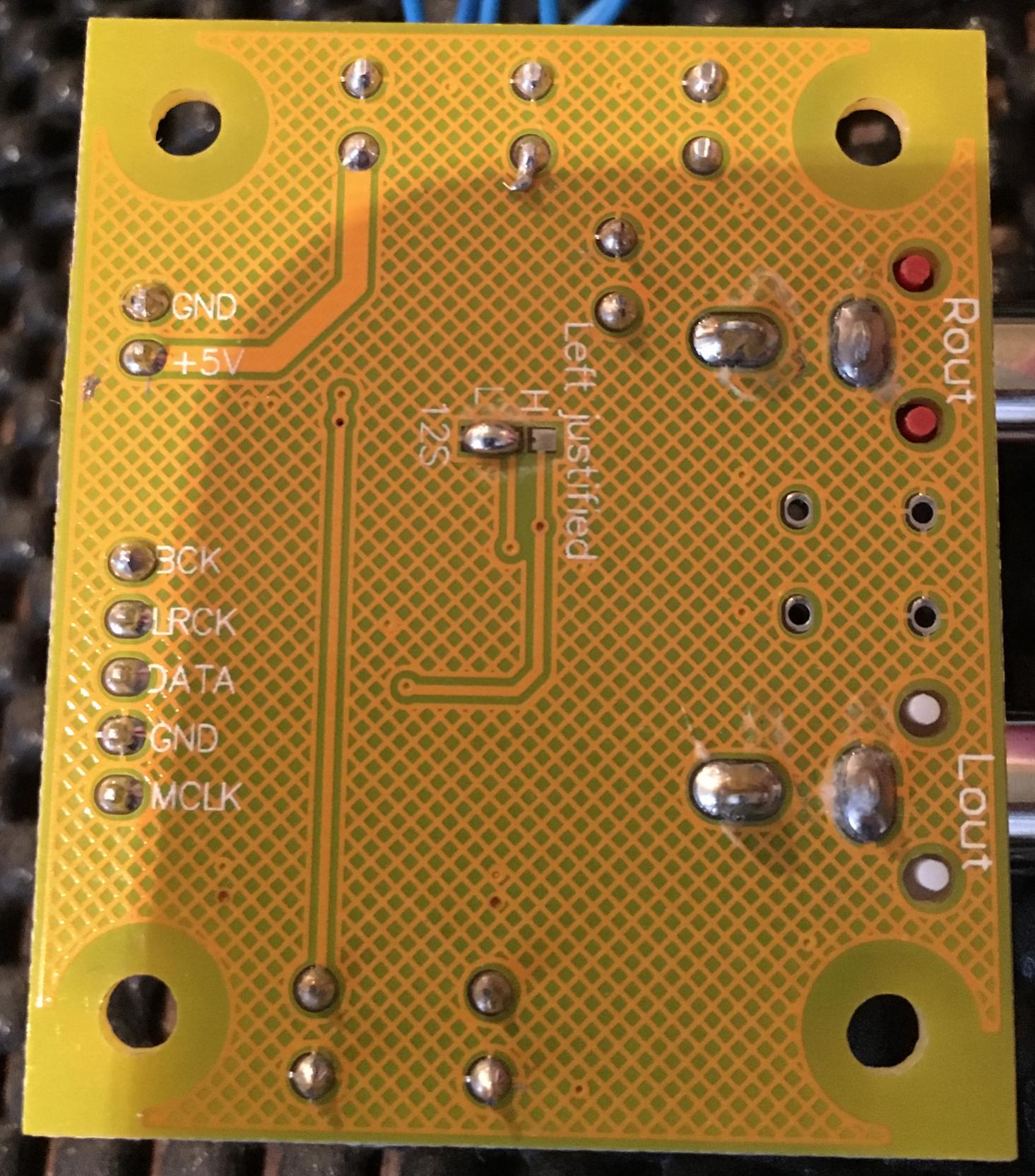

On the subject of MCLK & ESS9023...
I looked around for the most stripped down & fairly common Sabre board and bought this one for 9 bucks... to experiment with i2s from raw pi/D+PRO/Digi+PRO/Kali192/kali384 etc... and to have a saber chip laying around.
Could you guys take a quick look to see how to enable external MCLK on this one... maybe remove the 100R resistor? Its a teradac 2.1, no documentation.
Connecting MCLK as is just mutes the output.
Edit: tried harder to get to their site, it finally responded: http://www.teradak.com/products/84.html Still a little vague & bad english...
Thanks!
Thanks!

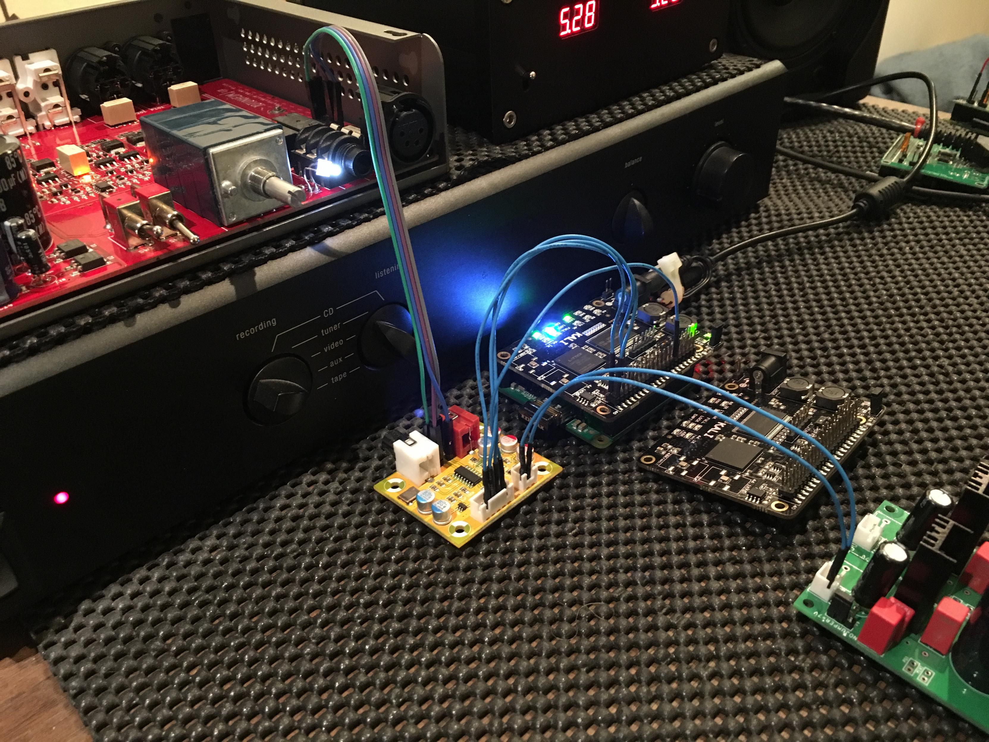

Scott,
First confirm that the right-most resistor in the 75R resistor array connects to both the MCLK pin on the header on one side AND to pin 13 on the ES9023 on the other side (fourth from the top right as shown in the picture).
If so, I agree with Dimdim.
OTOH, this is one of those situations where how well it works is HIGHLY dependent on how it is connected. Shorter is better. Note in the picture I posted of EUVL's ES9022 board that the output of the clock on that board is one 0604 SMD resistor away from pin 13.
You'd do best to keep those connecting wires to 1" or shorter.
Oh, and I just realized you are connecting to the MCLK output of the HFBD+P instead of a Kali. Not sure that'd be any better than the onboard clock and the ESS ASRC. Will be curious to hear your report.

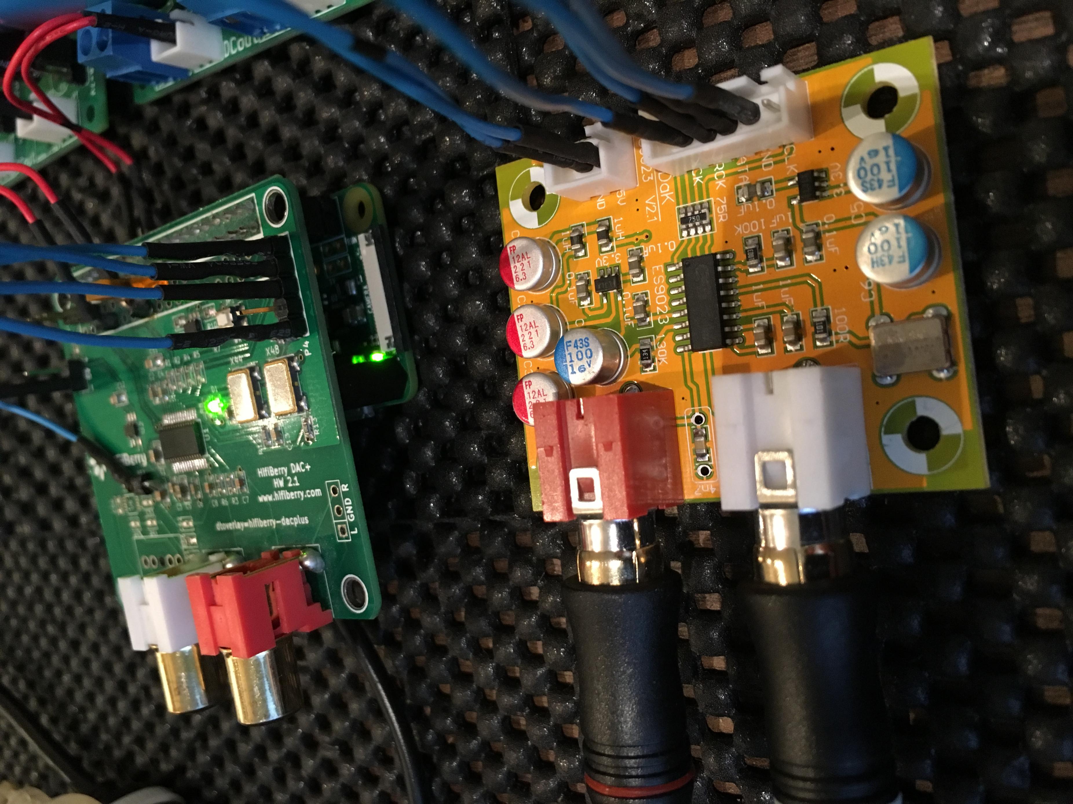

I have a couple of those lying around here.. It looks like removing the 100R resistor will do the trick.
I used this board to do my initial testing on Kali. She made a pretty substantial difference..
I didn't try connecting an external MCLK though.
Thanks! That's what I'll try re: the resistor.

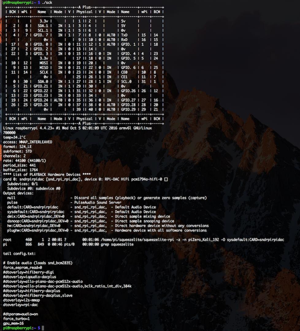

Do you happen to remember your *kernel/dtoverlay* setup when you had it hooked up to the kali? I'm getting dead silence.
I'm using Clive's 384 kernel & squeezelite 80x -- this board works straight from the pi, from i2s out on the D+PRO, but not on the kali192 (did not try the kali384 yet)
I was running the ES9023 I2S overlay on Archphile.. It worked both with and without the Kali if I remember correctly.
I can't really imagine what could be wrong. Is Kali outputting an I2S signal?

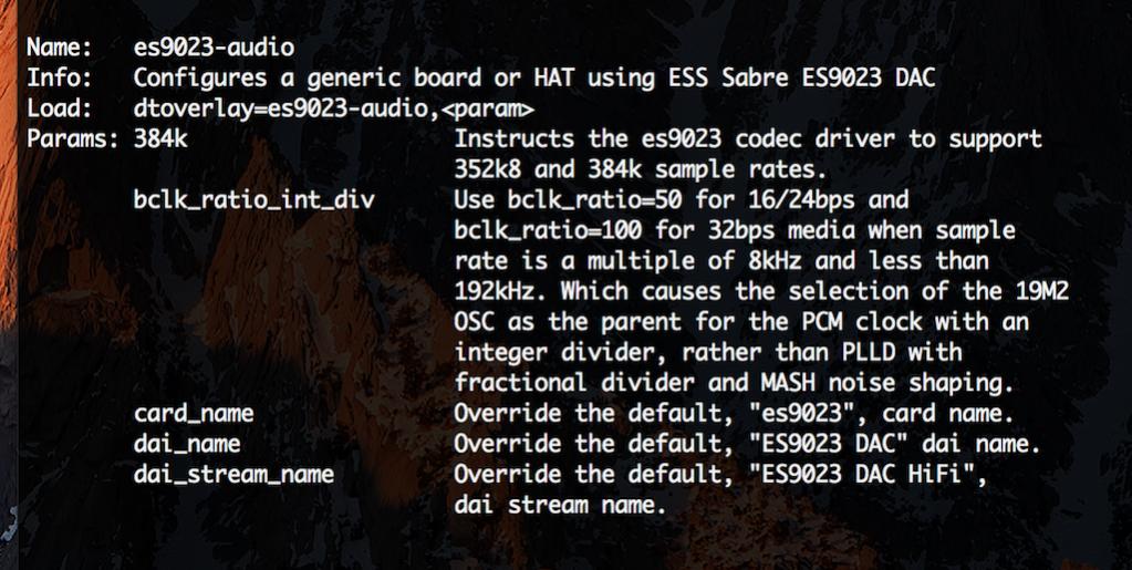

What's the config.txt entry for the ESS9023 overlay? (See pic in prev post, my config.txt is there, that does work *without* the kali (raw pi) and with the kali the LED's seem correct) -- but yeah... maybe that shouldn't matter--
I'll try some more things, swap around etc. Thanks!
Found the overlay (dtoverlay=es9023-audio,384k) @Dimdim, thanks-- However, interesting I could only get it to work on the Kali384, not the Kali192. I'll try some more experimenting, it's a little finicky on the kali's (need to cycle power, etc) yet thru raw pi, or D+PRO, it's rock solid & hard to break it (couldn't)
And by the way, the es9023 works at 384K? The specs always say 192... is that concept similar to the PCM51xx & oversample bypass?

Scott,
Yes... it does.
Agreed re: i2s, meant for board traces-- getting things working here tho, trying to understand i2s more completely, how Clive's linux works, misc. etc.
I need to listen some more before removing the resistor for ext. MCLK... will def. report back about it!
