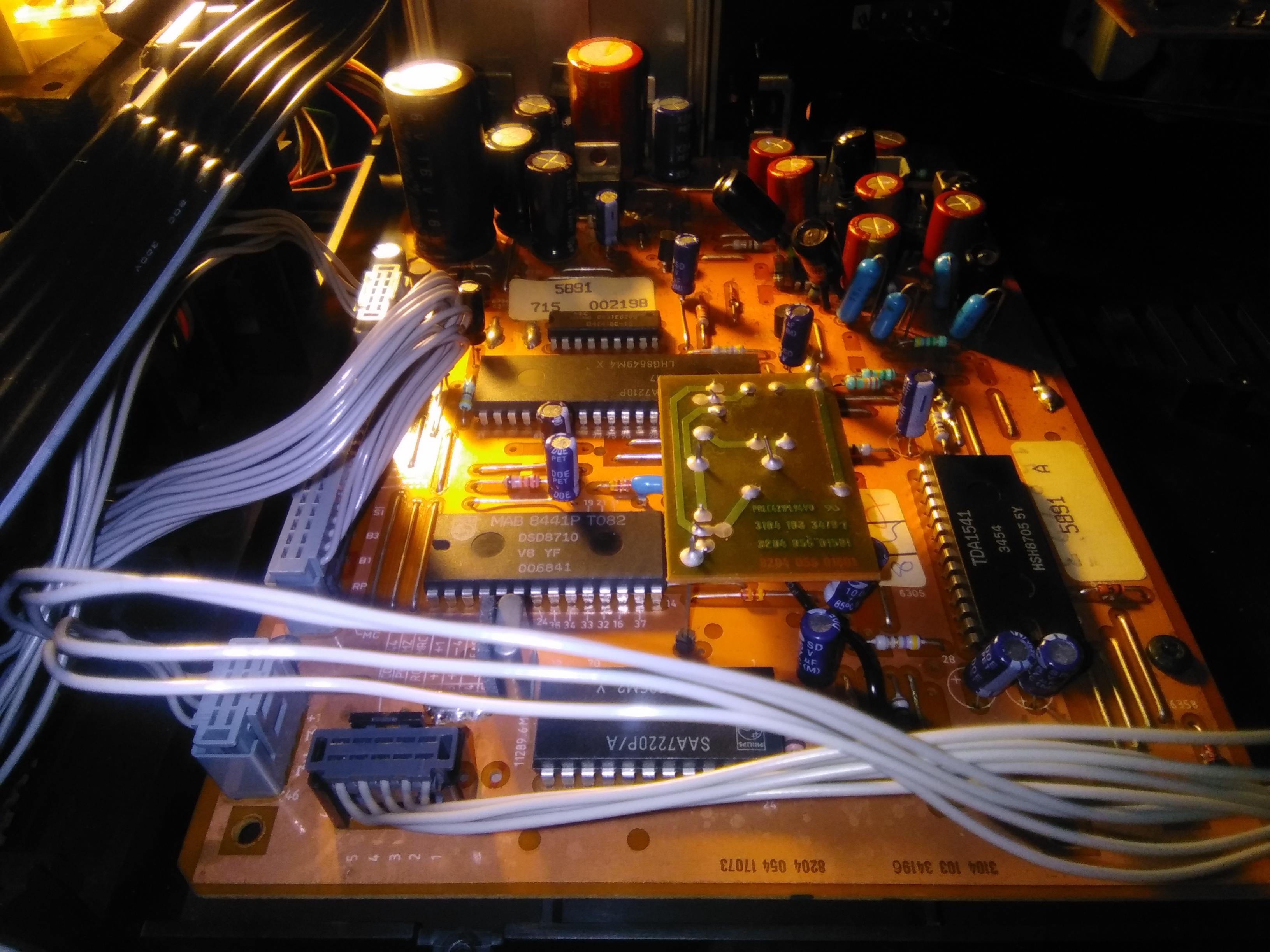

I've got a few CD Players but the one I use most is a CD273, mainly because I like the Size and it plays well.
Is anything worth changing, Any recommendations?
Op amps already able to be swapped and most caps have been changed due to its age, But any worthy gains that can be achieved?.

For example would it benefit from a stable temperature compensated crystal?

I'd start by replacing those blue Philips electrolytic caps as they're usually low in capacitance, the 33uF on the circuit board under the transport can give issues towards the end of discs. You can use common radial types as replacements.
Also, use bi-polar caps or even film caps on the output of the Opamps.
Install sockets for Opamps and try different ones.
As mentioned, a clock upgrade has decent improvements

Many thanks for that, I'll work my way through the rest of those caps, the ones on the transport are all replaced just the main board and one at the front of the display left.
At the moment it has OPA2134 as the IC sockets id already done.
Would any of these be a prefered match?
Also as far as the clock is concerned any advise on either of these? (the last two requiring TCXO)

Try the NE5532 and LM833 first. These will go straight in as they're dual bipolar Opamps. Check the datasheets for the others to see if they're the same.
Those clocks seem ok, check you have the correct frequency as the one you're replacing, I think they're are fine but just to make sure. Keep the wires as short as you can
Have you tried bipolar caps on the output of the Opamps? Also, good practice to put a ceramic capacitor, around 0.1uF (104) across the DC supply pins of the Opamps

My players clock is 11.2896 so thats what ive ordered, I will be able to mount it extremely close to the original position so should be able to keep the cable very short.
Im waiting for some Nichicon MUSE 47uf caps I ordered last week for the output caps but hoping I can find some polyester caps amongst odds and sods laying around.
"Any prefered value for these output caps"?
I will also add the ceramic across pin 4,8 of the op amps as i've plenty of those around, thanks for the tip.
I was thinking to bypass the SAA7020 but i'm not convinced (any thoughts)

I had read its preferred to give the SAA7020 its own dedicated power supply?

Which of the non oversampling mods would you recommend? just wire bypass or using 74HC175N

According to a description:
1. Locate the "LEG 1" on the underside of 1541 and 7220 chips
2. On 7220 cut both traces as close as possible to legs 15 and 16
3. On 1541 cut trace as close as pos on leg 1
4. Using a thin wire connect the 1541 and 7220 : leg 1 to 1, 2 to 2, and 3 to 3.
5. Connect the 7220 leg 23 to the de-modulator chip 7210 leg 11. If the mute trick does not work, you must float (isolate) the leg 11 on SAA7210 before connecting it to SAA7220P 's leg 23.

Yes thanks I'd seen that on lampizator as well, But I was referring too which method is preferred and looking for personal experiences with non oversampling mods rather than the procedure of doing it.

I believe increasing the caps to the bottom right can have a good improvement. I'll be trying that. They're 47uF on mine, may go upto 220uF.
I have two caps left in the power supply as they tested good. The Elna's around the Opamps I've not removed yet but I'd need smaller caps there if I'm to fit some sockets to try other Opamps. I'll try some LM833, LM4562 and some Burr Brown's when they arrive.
The Opamp output caps were two 100uF's back to back = 50uF but they tested the worst in the unit. I did try some 10uF Nichicon Muse BP but found some 22uF BP Cerefines I pulled from an old Denon player sounded better.
Also thinking of removing the muting transistors 🤔
