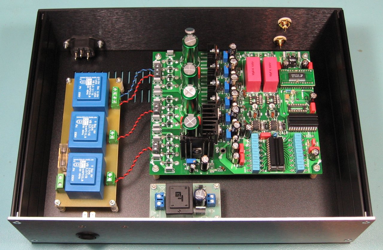

Hi Ray,
Is that one of the kits from Analogmetric?
Regards
Pete
Thanks guys!
Yep, it's the AnalogMetric PCB. I think it's a nice and simple way to start my TDA1541 adventure. The 7220 doesn't have it's own supply, but all the chips do have their own voltage regulator(s). There's room for an oscillator and 4040 to do some direct clocking, but i've re-wired it so the CS8414's clock signals are used. I want to start at the beginning first and see what happens if the clocking is improved.
Ray
Ray
