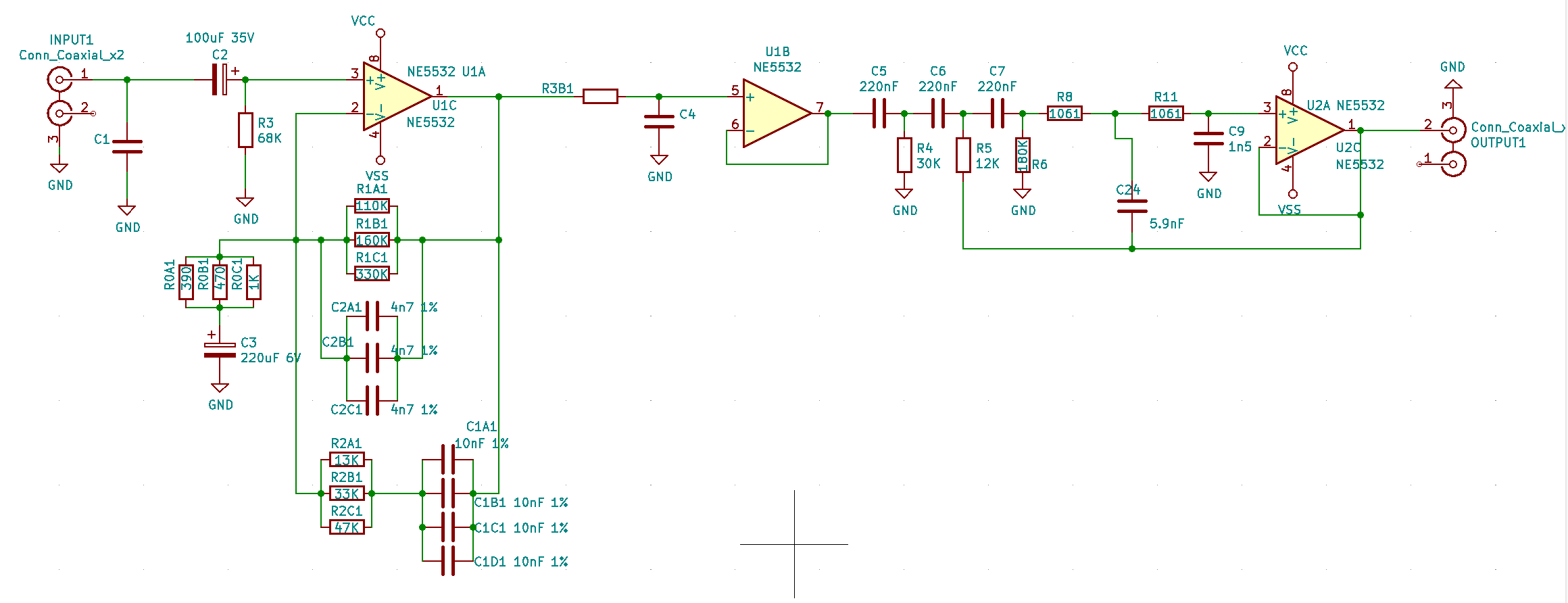

Here are my design decisions:
* MM-only version,
* Input capacitance to be adjusted by soldering in proper THT capacitor by the owner or me (not ideal, but definitely the best from noise prospective)
* Linear double +/-15V power supply
* Gain +30 dB at 1kHz. To achieve the best headroom
* IEC amendment removed: this is opinionated, but my neighborhood doesn't care
* 3-rd order Butterworth subsonic filter using a single opamp
* NE5532 as first stage
* ADA4075-2 as a subsonic filter buffer and output stage

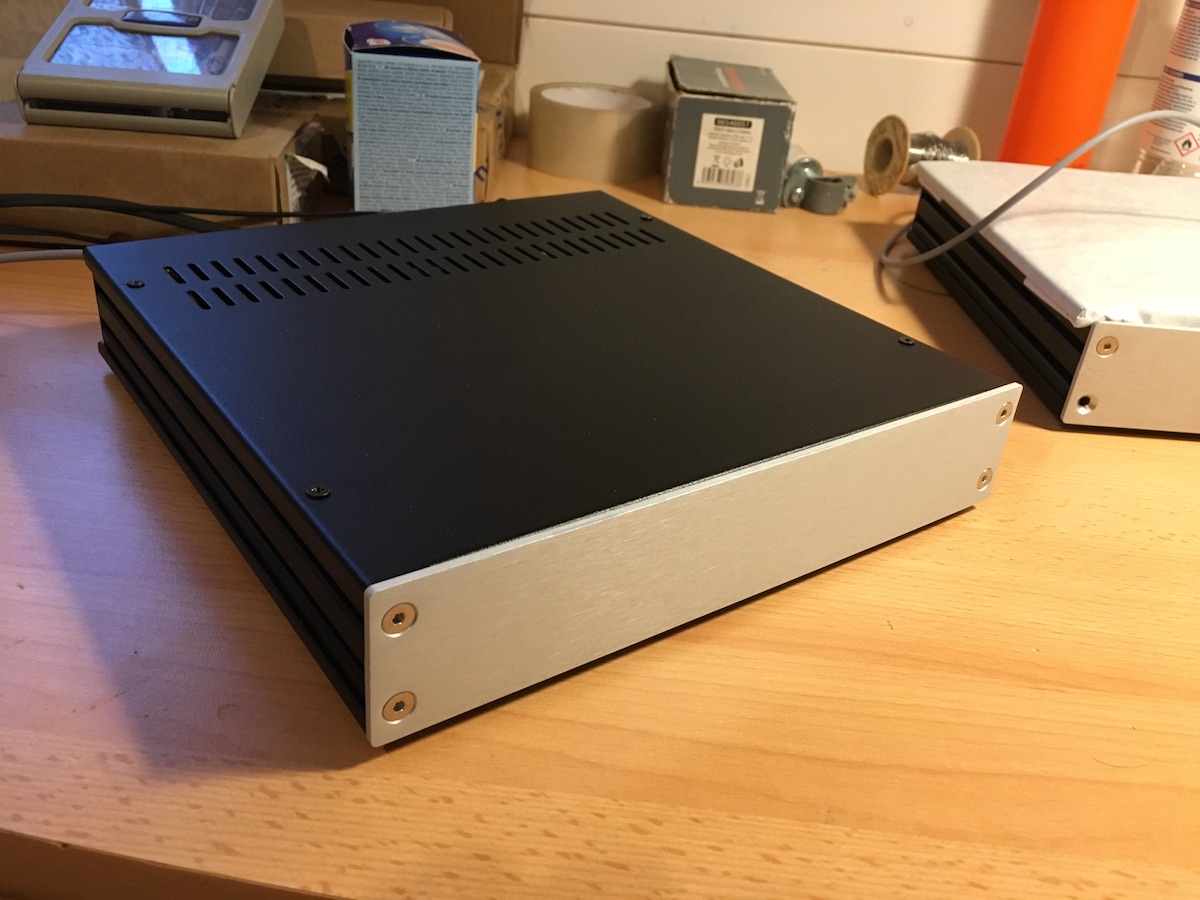

* Power supply in a separate enclosure, which is meant to be placed at least 1m from preamp
* Anti-interference HF filter in power supply

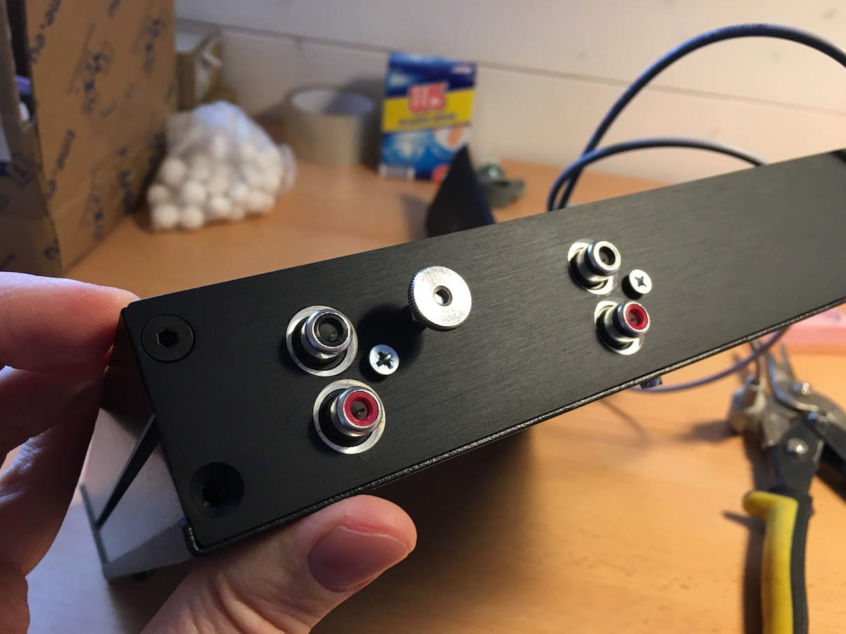

* 2 x aluminium enclosures of approx. 20x20x4cm
* SMD components
In RIAA EQ network at least 3 x 1% capacitors are used in order to compensate capacity tolerance. Also I'm using multiple 1% resistors in filters. In subsonic filtering I'm using a polypropylene THT caps, they are compact and proven to have no distortion (see the book for a reference on research articles). Aluminium electrolytic caps are used to decouple DC on input and output. Their capacitance is relatively high, so they don't cause audible distortion.

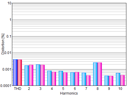

Also see pictures attached. THD/Noise/Crosstalk was measured using RME Fireface 400 and DSSF3 Real time analyser software.
Regarding RIAA tolerance. Deviations on low frequencies are caused by subsonic filter, and on high frequencies there is likely a error due to a measurement method. I plan to re-measure and update the post.
Overall my goal was precision, low noise and low cost, and I think these goals were met.
