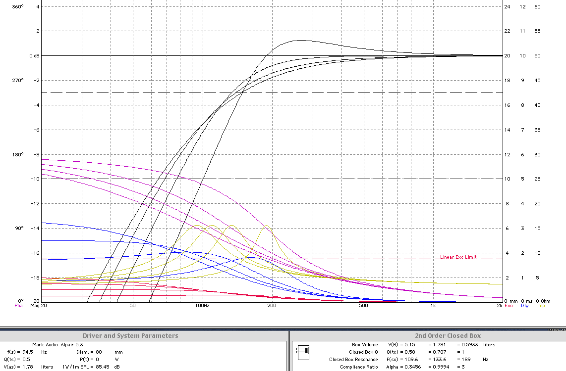

Hi! I have an oportunity to buy a pair of Alpair 5.3 deivers for a good prize and replace my fountek FE85 in a FAST system with tb w5-1138. Im just wondering if it will be able to be crossed at 200hz or lower when it’s mounted in a sealed enclosure with 1 liter internal volume? If anyone has any thoughts it’s much appriciated!
Typically one would XO these a bit higher (250-400Hz).
The Alpair will, IMO, decidely be a better mid/tweeter than the Fountek.
Sealed looks like closer to 1.7 litres need to get a box Q of 0.707 and an F(-3) of about 133 Hz.
Ideally one would want to cross at least an octave above that, unless you want to use the 2nd order sealed box roll-off as part of the filter.

wow thanks for quick and great replys.
Crossover: I dont know really yet how i will go about exactly but either PLLXO or active, probably not DSP.
BOX: I haven´t built the box yet but like alot of other builders I´m trying to keep size down, but 1,7 liters instead of 1 is not a problem.

I use mine in a 11.5L sealed enclosure because i like it with low QTC. But you could get away with smaller. For a QTC of 0.707 (what is theoretical the best) this driver need a 6,6L. You could go to 4L sealed but then you are pushing it to high qtc (0.850). Smaller will give a response peak at the bottom end. All will go low genough for a 2nd order at 200Hz, i use mine with a 1st order at 250Hz.
