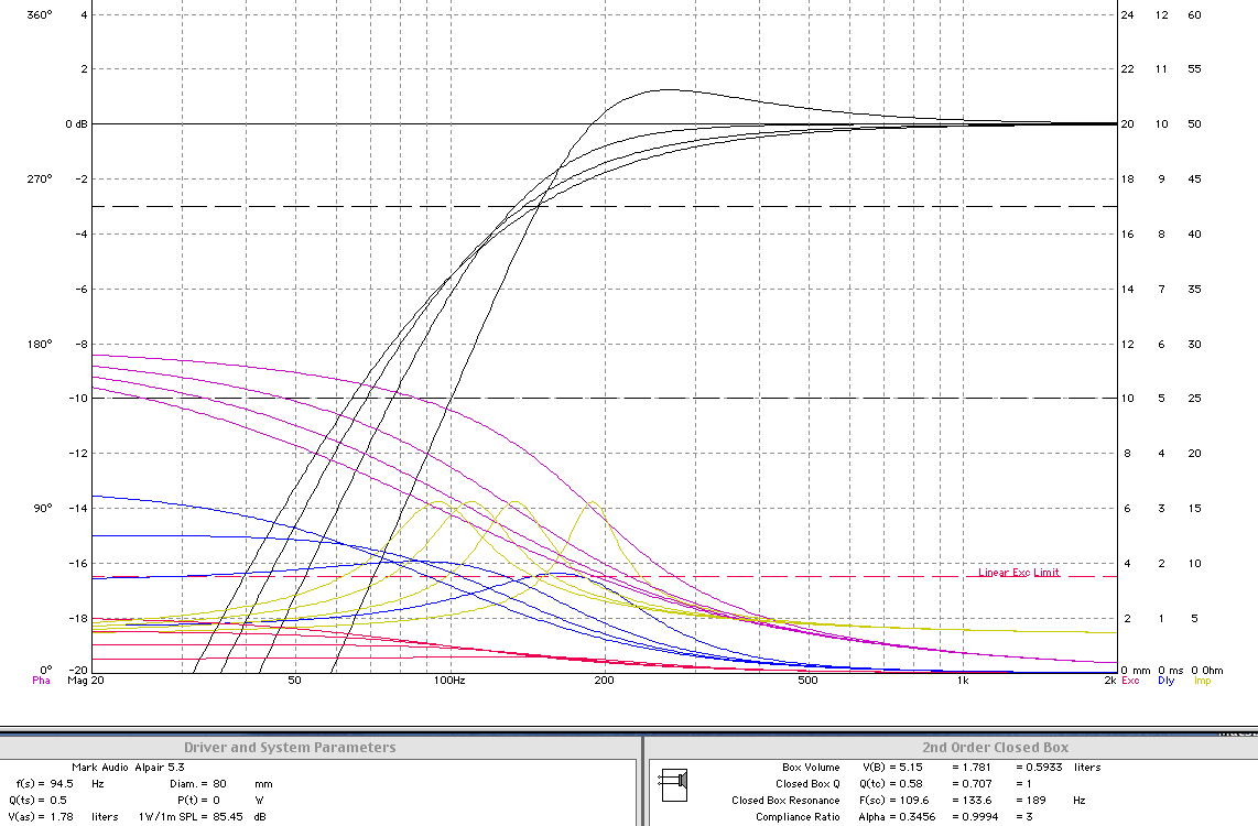

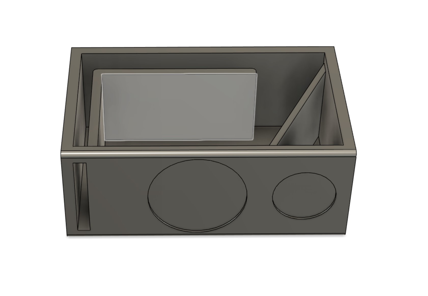

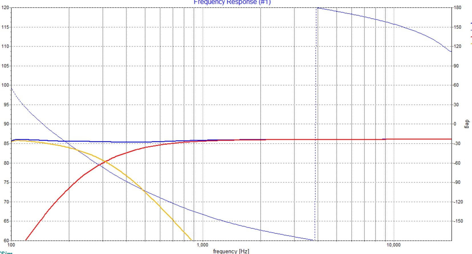

I'm planning a fast/waw bookshelf with alpair 5.3 and a tang band w5 1138smf.
It will be a 46cm tall 18cm wide and 28cm deep. Reflex port tuned to 37-38 hz. The tang band w5 is around 9.7 without the port. The alpair 5 has about 1.7 liters closed enclosure.
crossover point is around 310 Hz. I hope it will deliver the results

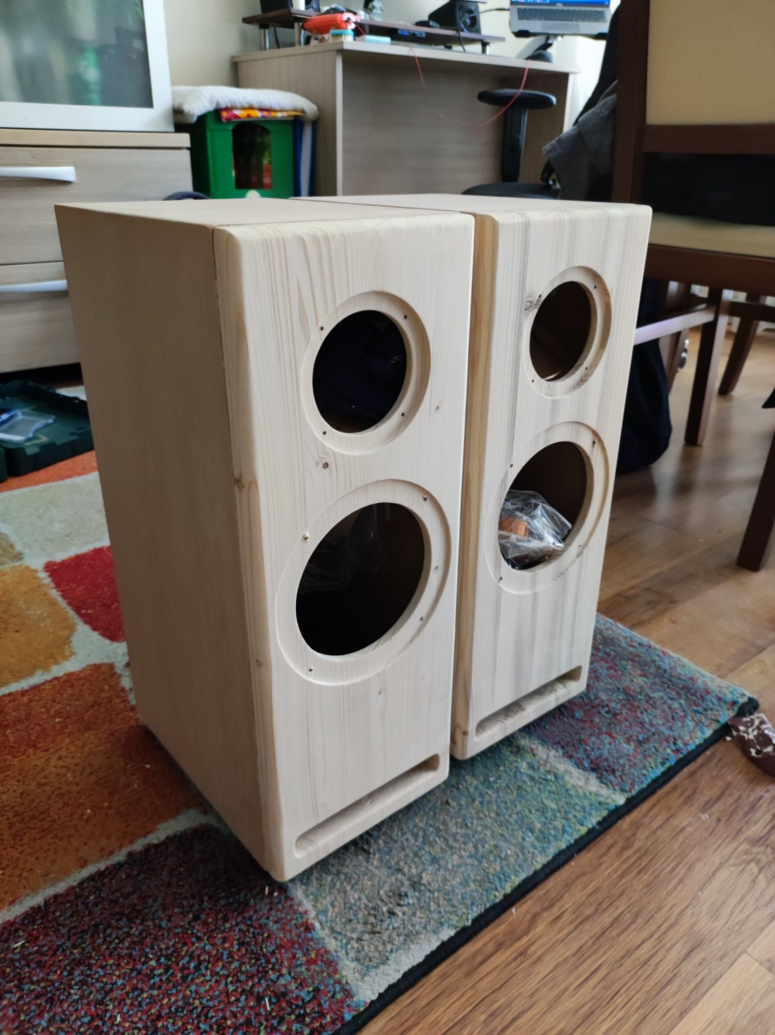

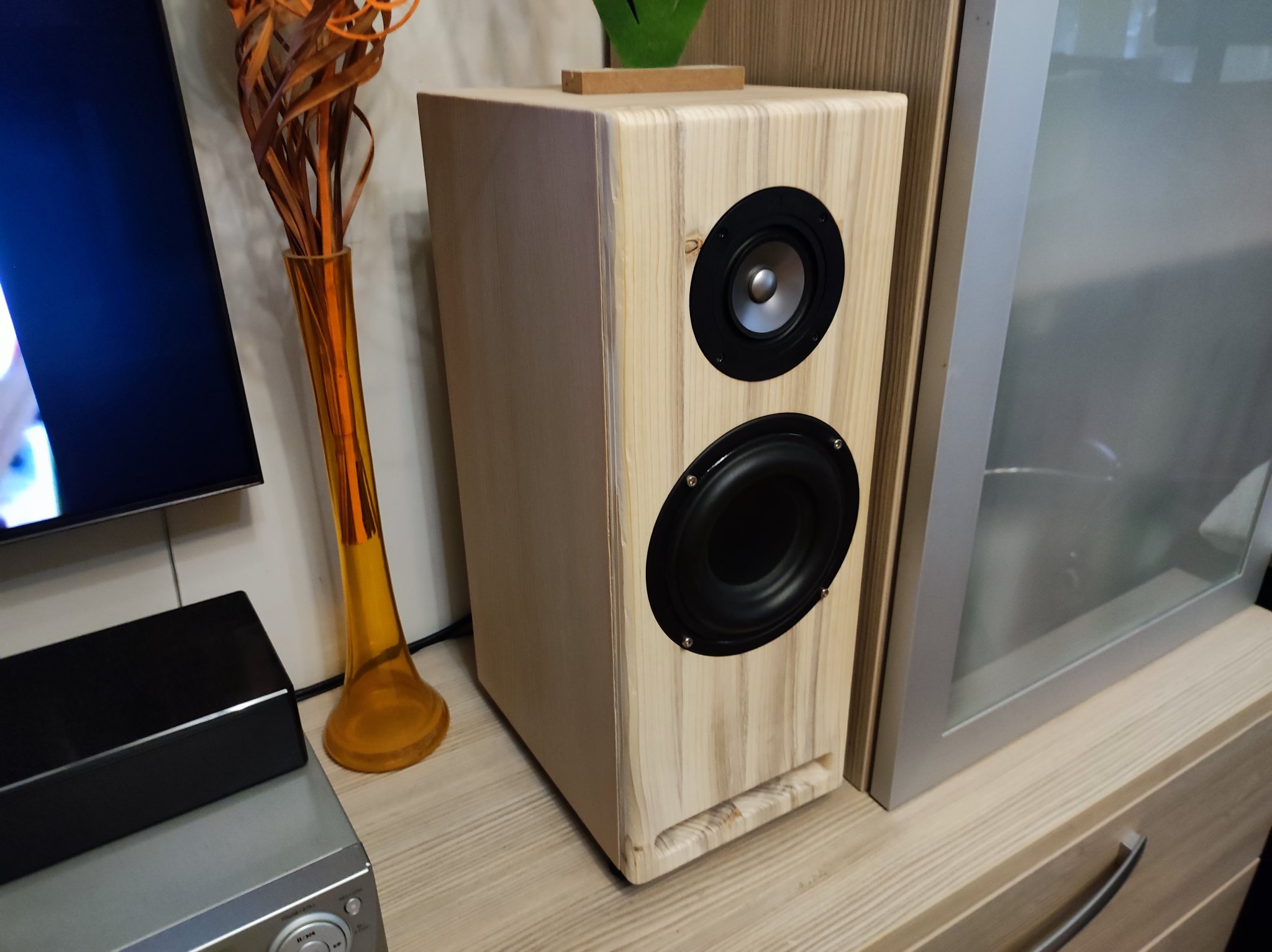

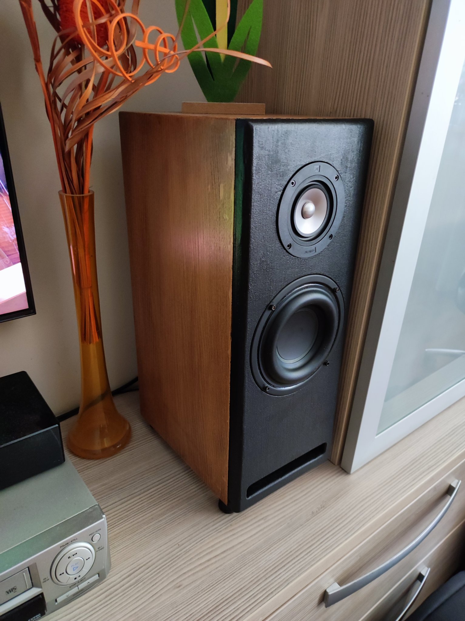

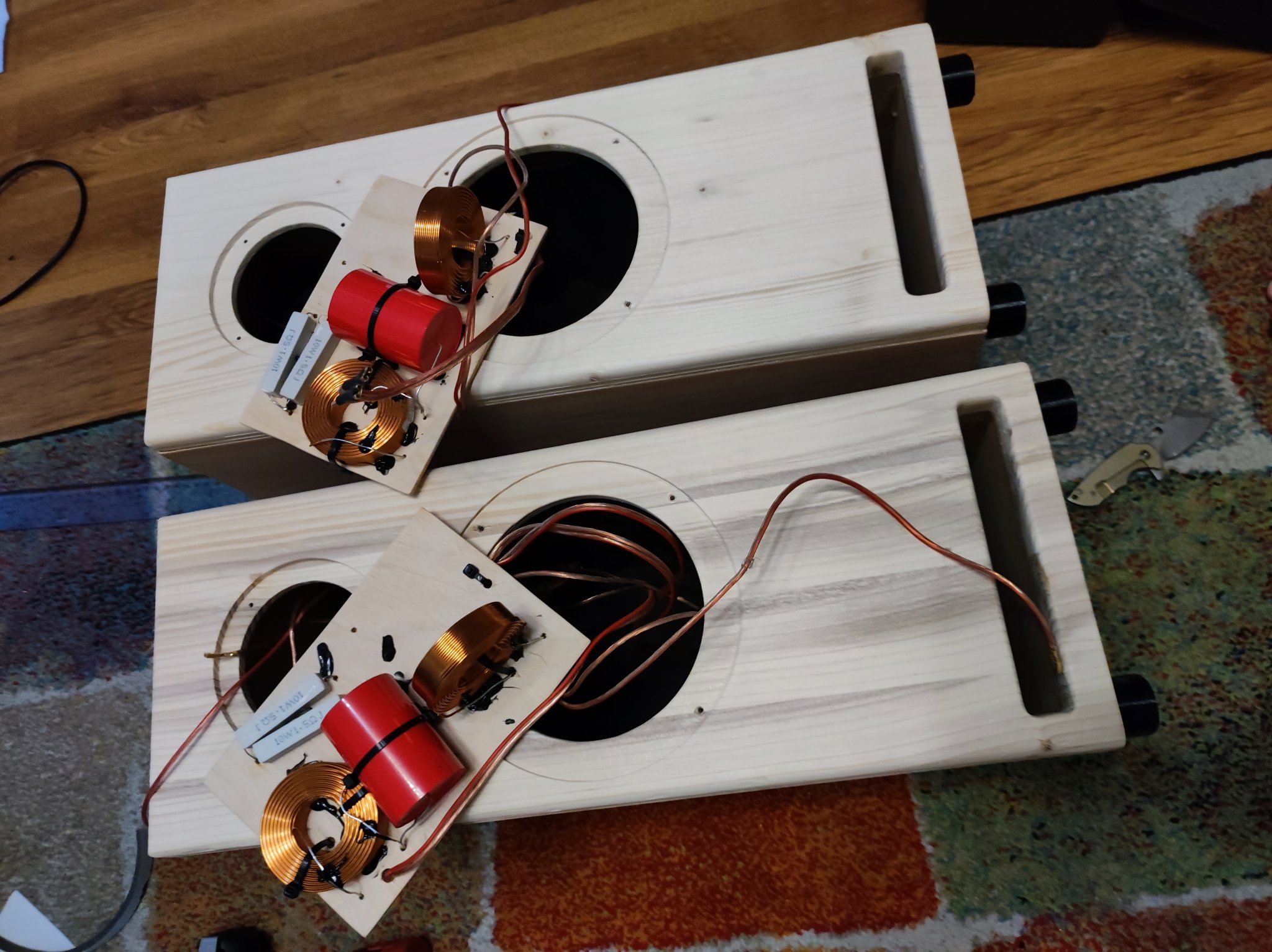

Hi, Yes its considered to be finished, and the results are really good.
Although Im not totally pleased with my woodwork so I think I will rebuild it on next summer with epique 5.5 woofers. (I dont have too much space)
Its my first hi-fi speaker build, and I learned a lot. Everything changes the sound very much. I tried some internal cables, and all sounded totally different. Even swapping the resistors. I ended up janzen silver cables on the mid high, and janzen superes resistors. So these sound awesome. Im using a yamaha rx-v 685 Ht amp, but by itself for music it is terrible. I have added a fosi tb10d to the front pre-out and its magic...

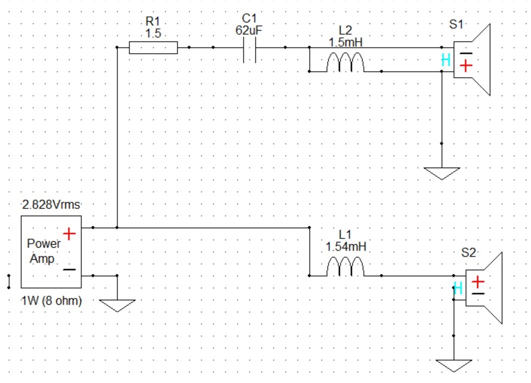

Thanks, the draw of the xo is up there. To match the volume of the alpair and the woofer i have raised the replaced the resistor to a 6.8 ohm 10w janzen. (The woofers are not too sensitive) The capacitors are some polyfilm ones 250v, and the coils are also janzen 1.5mh 0.6 ohm or so... At first i would check the woofers and box design for it with virtuixcad.
