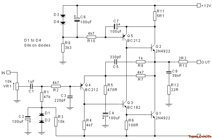

both of which I have showed here on this forum
Hmmm, this is just a combination of two well known circuits, both of which I have showed here on this forum. The input is the buffer as shown by JLH, the second part is as I described in Mpp thread to tweak JLHs headphone amp. Does this designer frequent DIY audio ??
Anyway it will sound and measure very well indeed.
Could you provide the link?

here is the original JLH headphone amp circuit --- RNMarsh
I bought about 2 yrs ago a JLH headphone amp being promoted on this DIYAudio site.... it doesnt measure as well, either. What else can i say. I even paid about $450 for a finished product off a headphone only site and wasnt pleased with the results, either. Now that one also sits unused as more wasted money. :-( It was all IC based.... but couldnt drive low Z headphones well... even with a buffer IC after the opamp. The sound matters. Measurements matter. Seemingly small changes matter.

JLH amp IC based? the sold u a fake.
A real JLH circuit is in my do do list (after yours, yay!)
I just looked at my comment - some of it didnt come thru.... the JLH was bought off this forum/dyiaudio headphones here. Not IC. Others tried were IC based. There are many to choose from. Some are copies of others work- like JLH. Some are improvements on others work. I am here only to help with my headphone amp... its dirivation is discussed in detail in Linear Audio publication.
