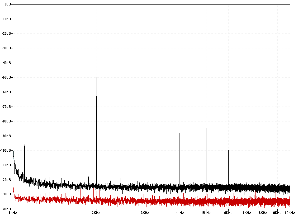

I did a first THD test, albeit without any load connected (sound card input only). Not sure whether this has any negative impact, but the values I measured surely leave something to be desired...
Generator was the soundcard itself, set to 1kHz and -12dBFS, which is 1VRMS. The loopback test measured 0.00018% THD and 0.0035% THD+N, see the red trace below.
With the amp in between and the volume pot turned down to compensate for the amp's gain, I now read 0.42% THD and THD+N, see the black trace.
I suppose this will look even worse with a load connected... To figure that out, I'm planning to build a Jack-adapter which permits to connect a headphone and a multimeter for offset adjustment at the same time to the output socket.
Up till now the 500R trimmer were only adjusted to measure 220R like R9/R10 via multimeter and the 1k trimmer used to null out offset. Do you think it's easily possible to get such bad results simply due to bad alignment?
EDIT: Just checked the other channel: It is even worse, reading 1.72% THD! (Graph scale is in dBV)

I got it! :cool:
After messing around with several resistors (which really is no fun at all on a tightly-packed, plated-through perfboard), I can finally say that 220R instead of 249R for R9/R10 was a bad decision :eek:. My first thought was to use them 'cause I had them, and finally I forgot to order 249R, so I had to use them...
Well, I went with 470R instead now, which is just covered by the 500R trimmers' range. Together with 2k2 (instead of 3k3) for R2/R3, I arrived at the following values now:
103mA bias current
13,2mA through R9, so roughly 13mA through the diode string
3,1mA through R2
2,20V (instead of 2,56V!) for the diode strings
Looks fine to me, so far. Only downside is, I had to drop the rails by 2V, because +-12,5V at those currents is a little too much for a 2x12V 2x5VA toroid. Luckily I went with 2 LEDs in series to a Zener at the Adj-Pin of LM317/337 regulators, so I simply had to short them out.
After some warming-up I re-measured the THD, still without a proper load and prior to any fine-tuning except offset trimming. Values in parentheses are from the first measurement.
THD: 0.13% (0.42%)
k2: -60.83dBV (-49.70dBV)
k3: -61.63dBV (-52.06dBV)
k4: -112.75dBV (-74.61dBV)
k5: -102.94dBV (-84.45dBV)
k6: -124.23dBV (-99.66dBV)
Much better now. I have to admit though, that I skimped on the matching... I did not want to buy a big bunch of transistors, so I opted for twice as much and simply matched for Vbe. So I presume THD-wise there's not an awful lot more to gain, but at least the offset is well behaved.
