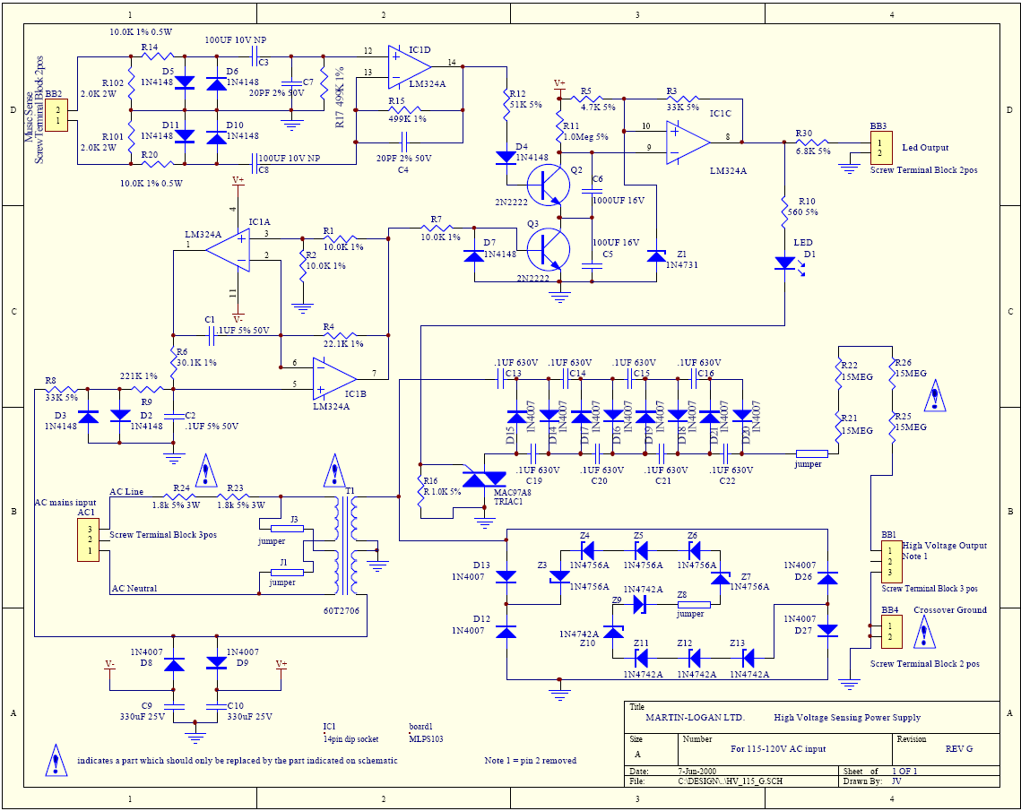

Finally had some time to get back to this -
Looks like pin 1 and 4 on LM311 are tied, so that means only single rail +12VDC voltage?
Also sent ML a schematic request for the BCFS7HVg power supply board
- as far as the 5 pin connector, the PDF doesn't give any details on the pinout, but if it is like the SPIRE:
pin 1 will be +12Vdc
pin 2 will be ground
pin 3 will be -12Vdc
pin 4 will be ON/OFF control to power amp (same signal going to the LED connector)
pin 5 NC
You can cross-check by measuring continuity with the LM311 opamp pins.
LM311 pin 1 should be ground
LM311 pin 4 should be -12V
LM311 pin 8 should be +12V

Looks like pin 1 and 4 on LM311 are tied, so that means only single rail +12VDC voltage? Also sent ML a schematic request for the BCFS7HVg power supply board
Hmmmm….yup, that means they are using the LM311 in single supply mode. Wonder why
But, that doesn’t tell us if the supply pins are connected to (+12V and ground), or (+12 and -12V)…either combination could function as a single supply.
That would be great if ML can supply a schematic.

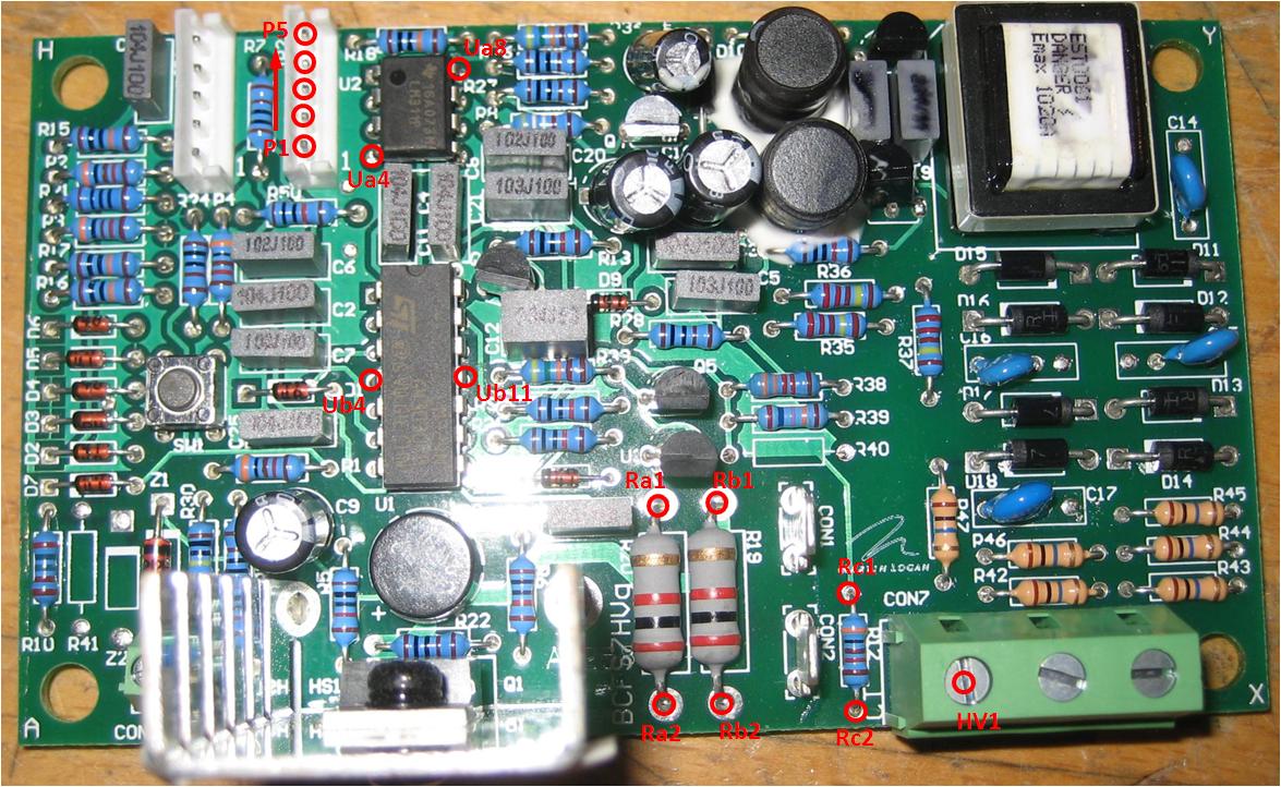

In the mean time, I outlined a few continuity tests below that will help identify if +12V/-12V are being used (or just +12V/ground), and which pins to hook the power to. See attached pic for identification of the various test points. Let me know what you find out, or if you have any questions.
Using DVM determine IC power connections to which Input connector pins (P1 thru P5):
LM311 Power Pins 4 & 8
- Ua4 has low resistance connection to pin Px?
- Ua8 has low resistance connection to pin Px?
LM324 Power Pins 4 & 11
- Ub4 has low resistance connection to pin Px?
- Ub11 has low resistance connection to pin Px?
Using DVM determine HV ground connections:
- Rc1 has low resistance connection to pin Px?
- confirm Rc2 has low resistance connection to HV1
Using DVM determine audio input ground connections:
- Terminal CON1 has low resistance connection to Ra1, Ra2, Rb1, or Rb2?
- Terminal CON2 has low resistance connection to Ra1, Ra2, Rb1, or Rb2?
The two remaining ends of Ra and Rb not having low resistance connection to CON1 or CON2
- should have low resistance connection to each other. Confirm.
- should have low resistance connection to Rc1 or Rc2? Determine which one.
By low resistance connection, I mean < 1 ohm.
By Px I mean which of the 5 input connector pins, P1 thru P5.

OK, here we go Answers in RED
- Ua4 has low resistance connection to pin P3
- Ua8 has low resistance connection to pin P1
- Ub4 has low resistance connection to pin P1
- Ub11 has low resistance connection to pin P3
- Rc1 has low resistance connection to pin P2
- confirm Rc2 has low resistance connection to HV1 - YES
- Terminal CON1 has low resistance connection to Rb1
The two remaining ends of Ra and Rb not having low resistance connection to CON1 or CON2 - YES - NEITHER
- has low resistance connection to each other. Confirm. YES, AND SHORTED TO HV1
- has low resistance connection to Rc2

Excellent!
Every test confirms that the power pins 1 thru 3 are arranged the same as the Spire.
Hook these up and apply an audio signal to CON1 & CON2 and you should be in business.
pin 1 = +12Vdc
pin 2 = ground
pin 3 = -12Vdc
You should not need to connect anything to pins 4 or 5.
For reference, the Spire had an ON/OFF control signal(ON=+12V, OFF=-12V) on pin 4 going back the the power amp module, and pin 5 for was not connected to anything.

OK, great. Got it...
Also, this is what I see on other connections:
HV1 goes to the Step Up Transformer Center tap
HV2 (other side from HV1) is Bias Voltage to diaphragm
Spade Con1 is one side of step up tranny to Stator
Spade Con1 is other side of step up tranny to Stator
Correct?
And one more thing - what does switch do?

All correct. (well, I'm assuming the 2nd Con1 was supposed to be Con2)
The small momentary switch discharges the the auto ON/OFF capacitor.
So, if you want to turn off the HV supply while testing or troubleshooting and don't want to wait 10-15minutes for it turn off by itself, just push the button.

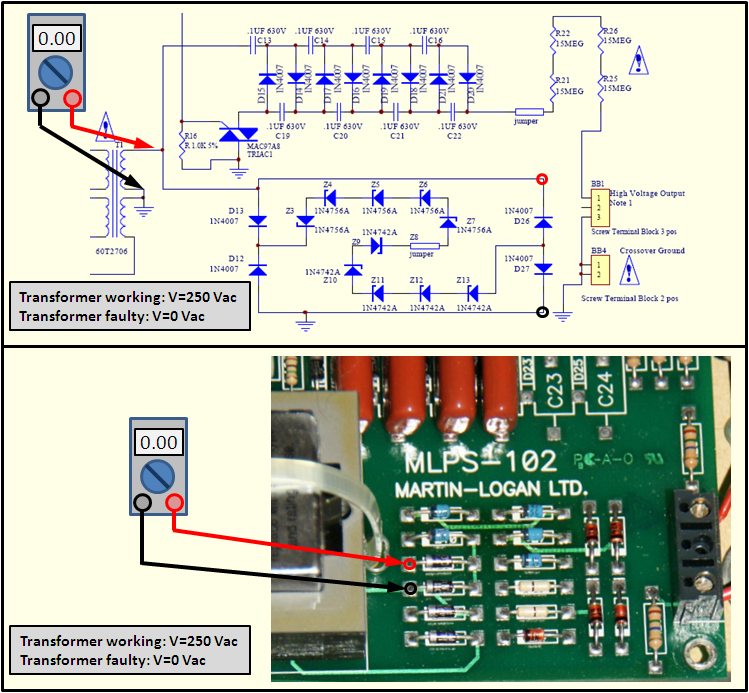

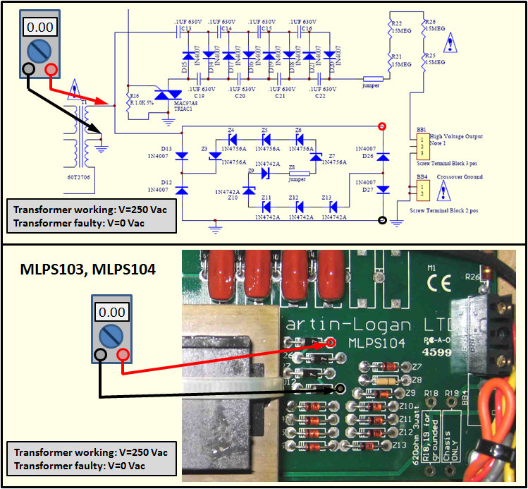

Usually the first step in diagnosing cases where one ESL is working and the other isn’t, is to remove the back and swap the HV power supply board between the two channels. If the problem follows the board over to the other ESL, you know the problem lies with the board. If the problem stays with the same ESL you know the problem is with the panel or wiring between board and panel. Since the ESL faded rather suddenly, I am pretty certain that the problem lies with the board, but best to run the swap test to make sure.
Once you have the backs off and can see the HV power supply boards, you can also run a couple other tests if the board swap indicates a bad board. Let us know what you find out.
1) Confirm that the red LED on the board comes on when the ESL is plugged in and music is being played
2) If LED on the board is lit, confirm that you are getting about 250VAC at the output of the HV transformer.
Attached is a copy of the schematic for the Aerius power supply board, along with locations to make the 250VAC measurement mentioned above if your board version is the MLPS-102. If it is a different version, post which one so we can identify where to make the measurements.
