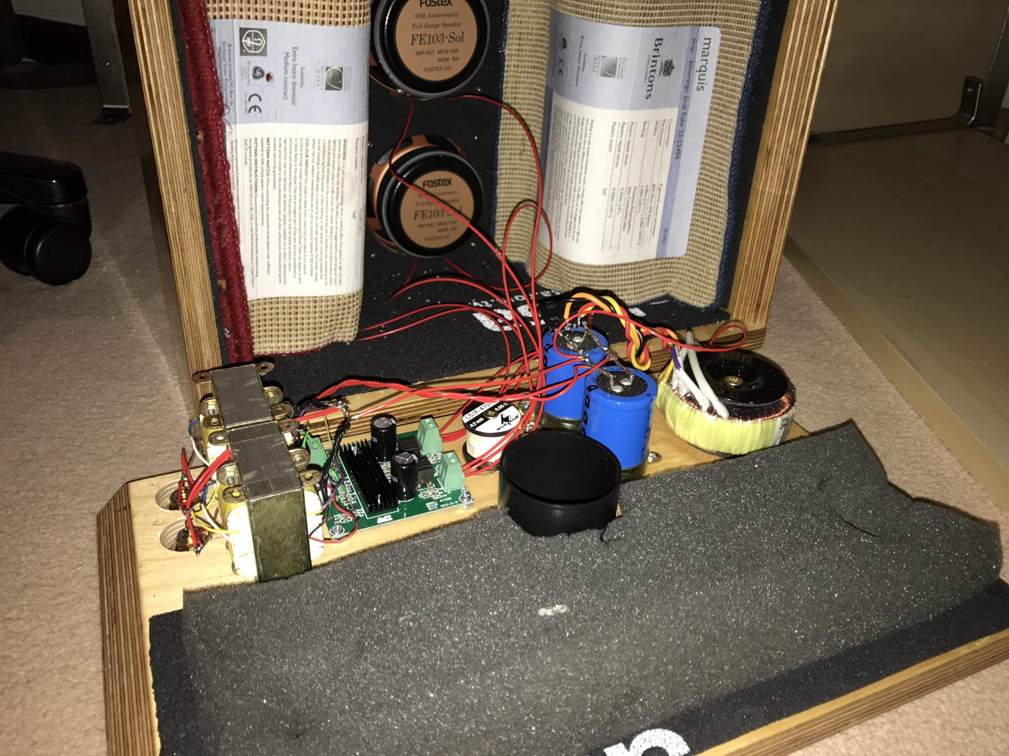

The main limitation that I can see with the current design is that the sum and difference drivers share one cabinet volume. Due to the nature of most stereo recordings (bass is shared evenly over L & R) the difference drivers mainly replay mid & high frequencies. If I had the space i'd install a pipe between the rear of the two difference drivers filled with damping material. This would isolate the two equal but opposite drivers from the main cabinet volume. Then it would be much simpler to optimise the bass performance as the two sum drivers would be working into a defined volume with a single port.
I finally got round to introducing a limited amount of isolation between the sum and difference drivers, using some handy carpet samples. This has definitely reduced the mid and HF leaking from one channel to the other (mid high mono content now isn't audible via the difference drivers).
I did one other change that has been very worthwhile. I changed the two sum drivers from operating in parallel at all frequencies to being a 1.5 way pair using a 4.7mH inductor on the lower driver. I did some very rough calculations and figured that the lower driver would roll in +6dB at the baffle step (600-700Hz from memory, but a guess given the angled cabinet baffle). This has added lower mid and bass weight and also significantly improved the HF dispersion, which was compromised with two full range drivers covering HF.

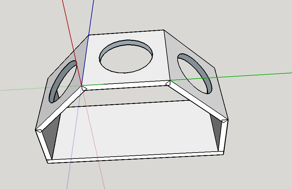

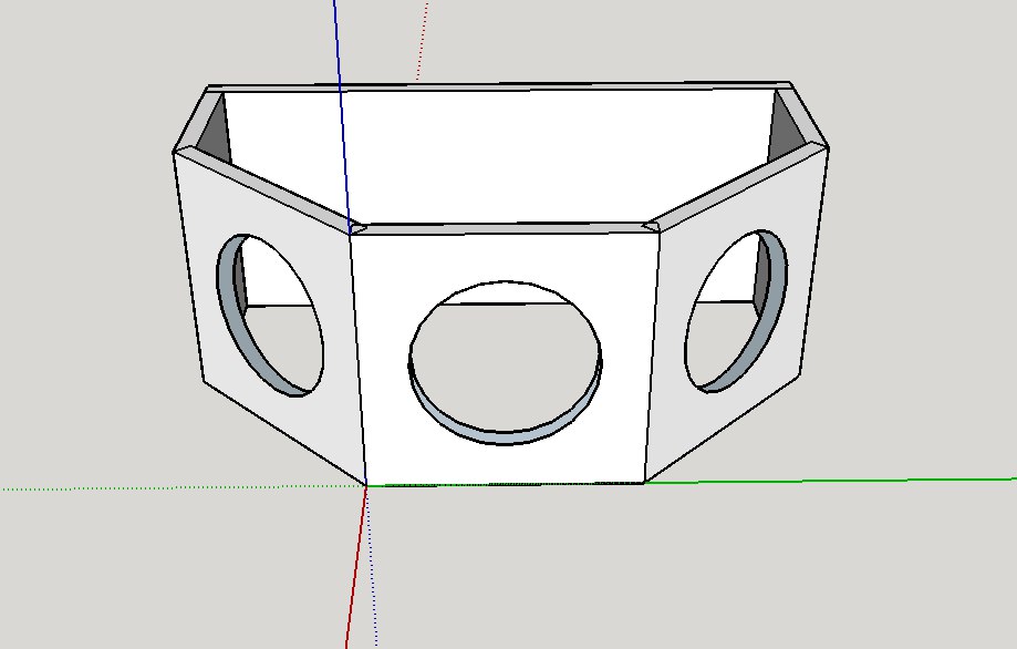

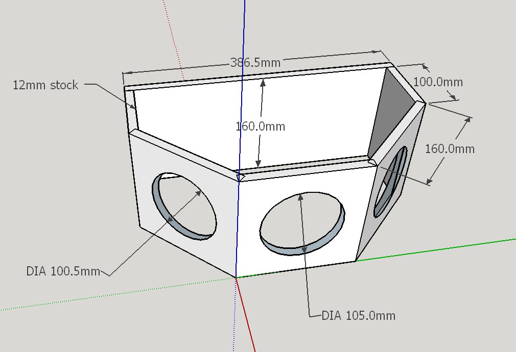

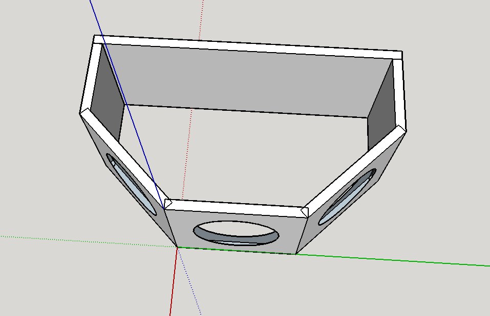

A friend gave me a pair of cheap paper-cone full range speakers. I figured they'd make a nice trio with my other cheap paper-cone full range speaker. 😀😀 I turned to this thread for inspiration and made some quick drawings. My quick calculations show that this makes a sealed enclosure of approx.10 liters. Design is for 4" drivers, adjust the hole for whatever driver you're using. Hope this is useful. Any comments or correction please feel free.
