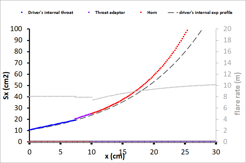

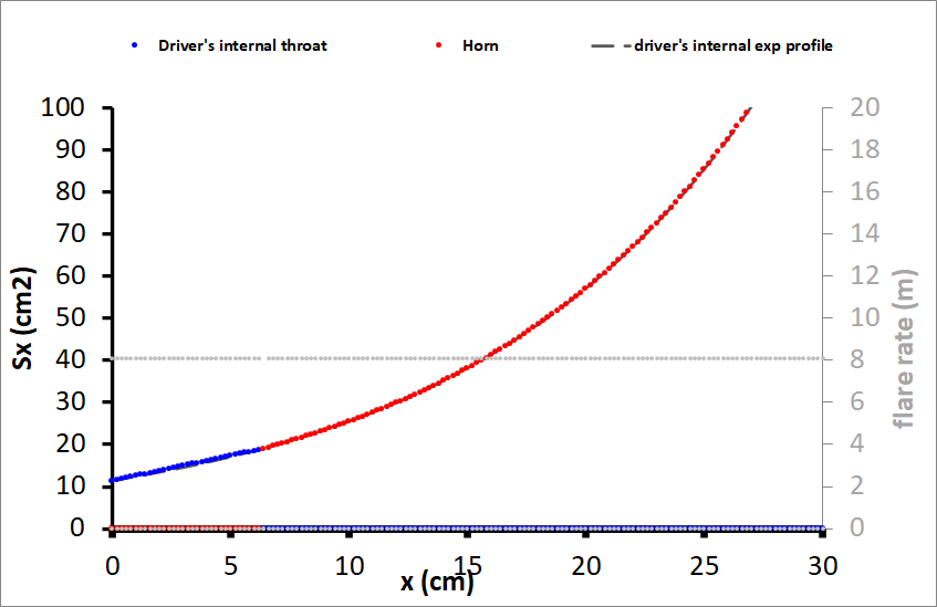

2) Starting from the geometry of the compression driver's internal throat (see 1 above), there is technically only ONE exponential horn that matches it perfectly without introducing any discontinuity in the expansion profile, and that is a horn having the exact same flare rate m.
In the example below, we see plots of the expansion profile (Sx) and flare rate (m) along distance from phase plug (x), for the JBL 2450J driver.
In this particular case, the internal throat geometry has an equivalent exponential flare rate m = 8.1, and the best (only, really) matching exponential horn has the same m and Fc = 220 Hz.
If instead we opt for a hypex horn with T < 1, then m varies (increases) with distance x, and there are a number of combinations of T and Fc in Salmon's equation that lead to a flare rate m that starts out at the same value as the driver's internal equivalent exponential flare rate m.
One such example is given below, once again for the JBL 2450J driver; the horn is Hypex, with Fc = 320Hz and T = 0.7 (does that ring a bell? ;-) those are the exact same parameters as the TAD TH-4001 horn!)

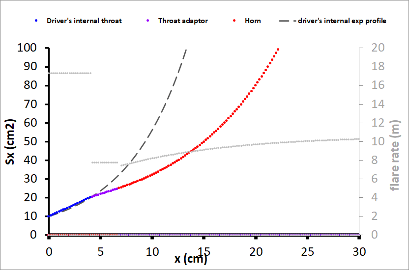

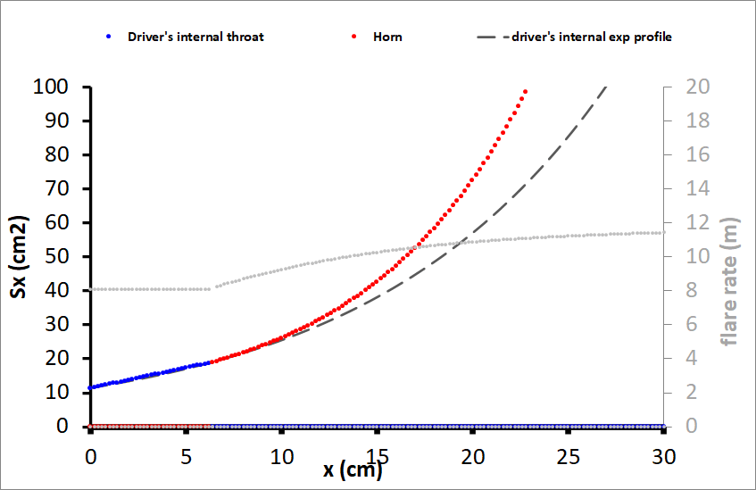

3) Now we introduce the throat adaptor. This is a necessary evil when we want to mate a driver's circular exit to a horn that has a non-circular throat. Ideally, it would be preferable to avoid the adaptor completely, and just have a horn with a round entry throat, and a smooth internal transition from circular to rectangular (if desired for directivity control) cross-section.
But in the real world, for many horns, there is in fact a throat adaptor, which has the difficult task of performing the transition from circular to rectangular cross-section, while maintaining to the best extent possible the same flare rate as that of the driver's internal throat (which, as per 2 above, also needs to match the horn's own flare rate - if the horn is exponential - or its INITIAL flare rate - if the horn is Hypex).
See below one more example, once again for the case of the JBL 2450J driver and a Hypex horn with Fc = 320Hz and T=0.7.
But in this case the horn throat is larger (S3 = 29.4 cm2, vs the driver's exit area S2 = 18.9 cm2), and between the two there is a 5.4cm-long throat adapter (the expansion of which along x is - for simplicity's sake - assumed to be linear, but for which we can also calculate an equivalent exponential flare rate, just like we did for the driver's internal throat):
OK, in a nutshell, THIS is how I see the issue of obtaining the "best" match between a compression driver and a horn.
As you see, there isn't much leeway, really. Only a very few driver & horn pairs can really work optimally (from the point of view of ensuring a smooth hand-over in terms expansion profile). All others are a bit of a kludge.

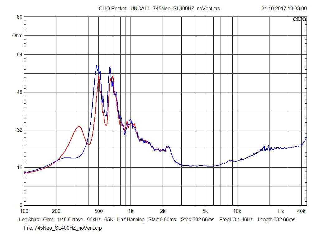

But the Radian drivers are somewhat strange. I had a 745Neo and it had a suspicious hole in the back cover. Asking the Radina folks it is intended to protect the diaphragm. For normal home listening levels this hole could be closed (I will not take any responsibilities about driver issues for larger levels!). So if there is a ventilation hole in the back cover/cap then close it and measure again the impedance ;-)

red=open, blue=closed.
The 745neo was attached to SL400Hz with a way too small mouth area so ignore the double peak as it should be mostly horn related.

@docali Thanks, I will measure this. Something else I want to try is running this driver without back cover, like Troy (Joseph Crowe) runs other drivers. Also it would not be hard to add an extra ring to increase the volume of the rear chamber so as to stuff it with wool felt. There is room to experiment and see if the performance for home hifi use can be improved. Long to do list

But then take care about diaphragm alignment when you unscrew the back cover. What I found insane with the 745Neo that the screws of the back cover at the same time fixed the diaphragm! This is a no go for me. I am not sure if the larger drivers have the same issue but if you are unsure how to correctly align a diaphragm then hands off ;-)@docali Thanks, I will measure this. Something else I want to try is running this driver without back cover, like Troy (Joseph Crowe) runs other drivers. Also it would not be hard to add an extra ring to increase the volume of the rear chamber so as to stuff it with wool felt. There is room to experiment and see if the performance for home hifi use can be improved. Long to do list![]()
This will dramatically decrease efficiency. But to increase the rear volume would be an interesting experiment.@docali Thanks, I will measure this. Something else I want to try is running this driver without back cover, like Troy (Joseph Crowe) runs other drivers. Also it would not be hard to add an extra ring to increase the volume of the rear chamber so as to stuff it with wool felt. There is room to experiment and see if the performance for home hifi use can be improved. Long to do list![]()
