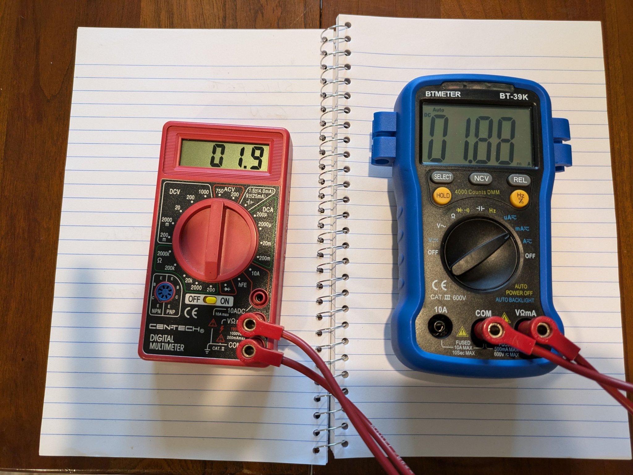

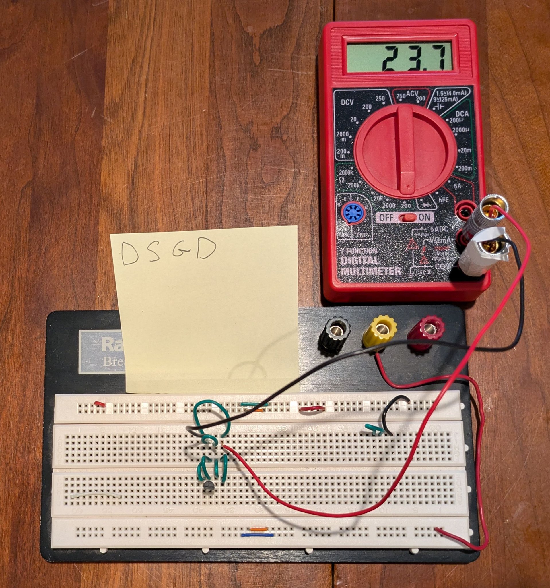

Here is the rig in its finished form. The rig has a Harbor Freight USD $7.00 multimeter and a plug-in proto board. The JFET is tested for D-S resistance with G-S shorted. The test current is 1.88 mA. The next post will show how the test current is determined.
The red Harbor Freight DMM is placed in the 200 ohm measurement range. The other DMM is placed in the mA current measurement range. The red DMM is forcing 1.88 mA to measure on the 200 ohm range. It turns out that 1.88 mA is a relatively good current for characterizing a JFET to go into a JFET Beast build.
This measurement is a J111. The D-S resistance at Vgs = 0 at 1.88 mA of current is 23.7 ohms. The measurement requires about 90 seconds to settle. 2 minutes is what I use to let the measurement settle. I have plotted the settling time with a graphical sourcemeter for a large number of JFETs and 2 minutes appears to work.

Hello ZM. I agree. I am working with a designer friend to make a more solid measurement rig. That will cost $$$. I wanted this thread to show a very inexpensive and easy way to take measurements for matching.

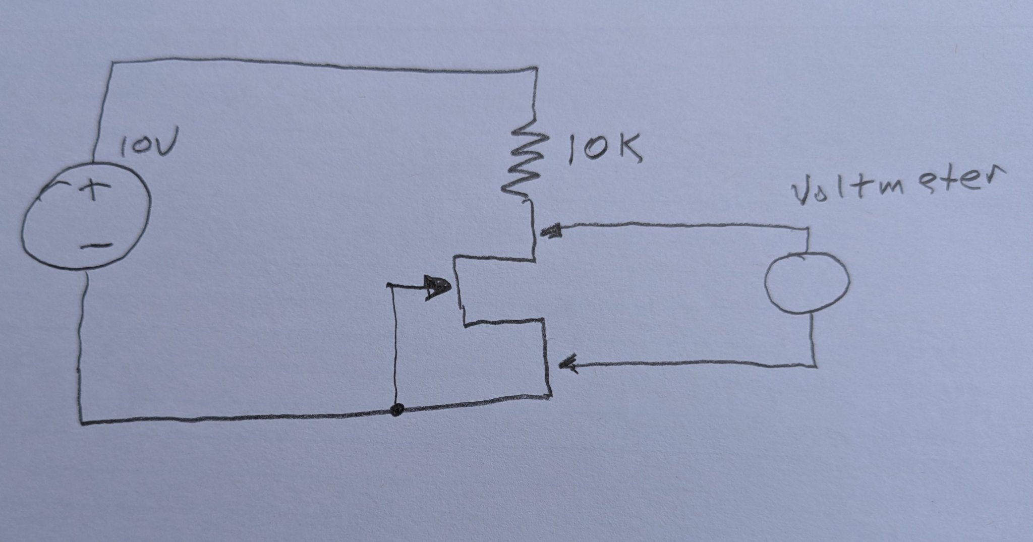

I have pivoted on what to use for simple and inexpensive matching of a large pile of JFETs.
This takes me back a zillion years on how to plot the impedance vs frequency of a loudspeaker.
This rig only requires
1. 10 volt power supply
2. 10k resistor
3. Proto board with wires
1mV reading on the voltmeter equals 1 ohm D-S resistance of the JFET. Most inexpensive multimeters have a 200mV range yielding 3 significant digits for 10 ohms through 99 ohms.
The J111 that I used to evaluate the rig measures 24.89 ohms using a $7000 sourcemeter. It measures 25.04 ohms on the resistive divider rig.
The current through the JFET is nominally 1mA.
This will work for matching JFETs for mini JFET Beast builds.
