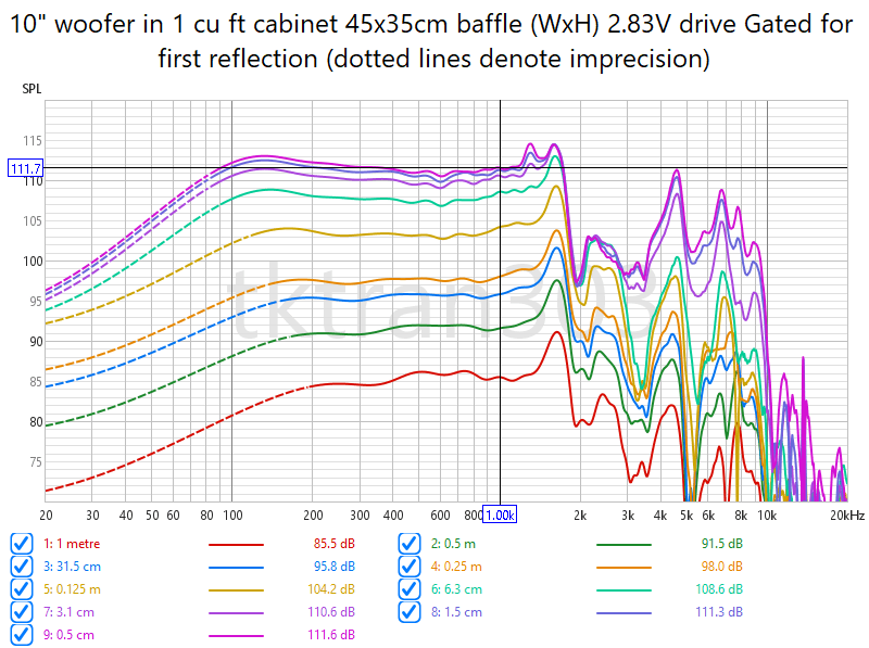

I come with data...
At 1KHz, the difference between 1m and 1cm is 26dB.
Measured according to:
https://kimmosaunisto.net/Software/VituixCAD/VituixCAD_Measurement_REW.pdf
Don't shoot the microphone (messenger)
This have been very educational for me. Thank you @Hörnli and @IamJF

When I do nearfield measurements, I adjust the voltage so that the mic is driven to 100 dB or less. I actually shoot for right at 100 dB. I am not sure what the advantage would be to use a full 2.83 V, which can correspond to very high SPL?
During the merger process, the NF response gets adjusted up/down to match the gated response, so ??? what are we doing here?

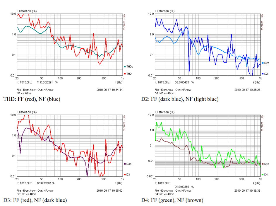

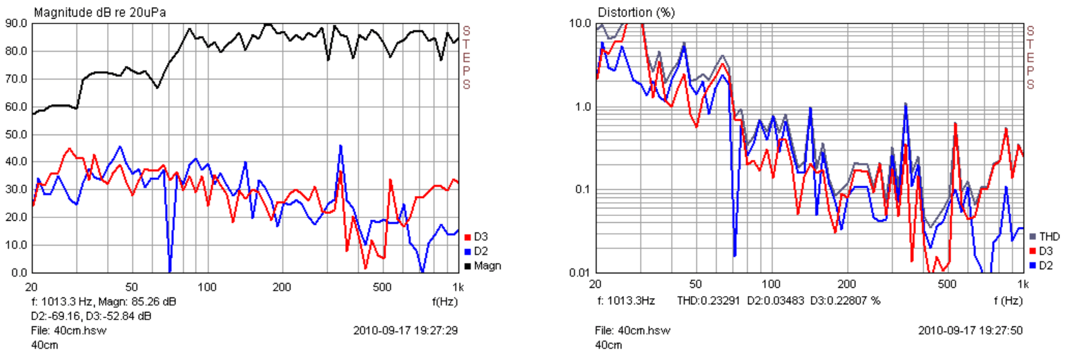

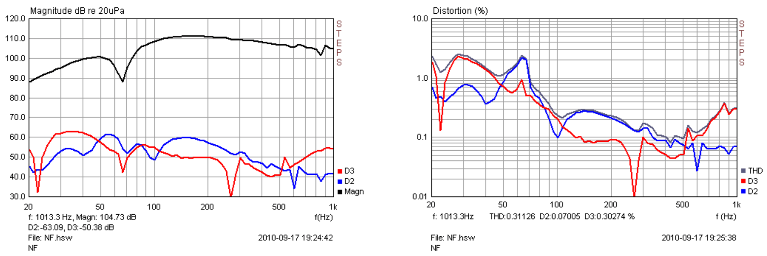

But when looking at distortion, we lose accuracy if trying to measure indoors. At 1m, or 1/2 meter, or even 31.6cm. This applies whether we use the sine sweep method or the stepped sine method...
Below is an excerpt of distortion measurements taken at 40cm, 25cm and nearfield conditions:
"With increasing distance, the room influence becomes more noticeable in both frequency and distortion traces.
[Below] is a direct comparison of % distortion traces for nearfield and 40cm measurements.
Increasing distance not only makes the traces noisier, but it also contributes to overall apparent distortion"
"The examples demonstrate the factors to be considered when making reproducible distortion measurements. They include signal and sound pressure levels, the quality of the microphone and its distance from the speaker, and the contribution of room reflections. The measurement setup should account for these factors as much as possible in order to optimise results."
Reference:
3.2.1. Factors influencing distortion measurements, pages 10-14 of
https://artalabs.hr/AppNotes/STEPS_Tutorial_Version_2_4_English.pdf

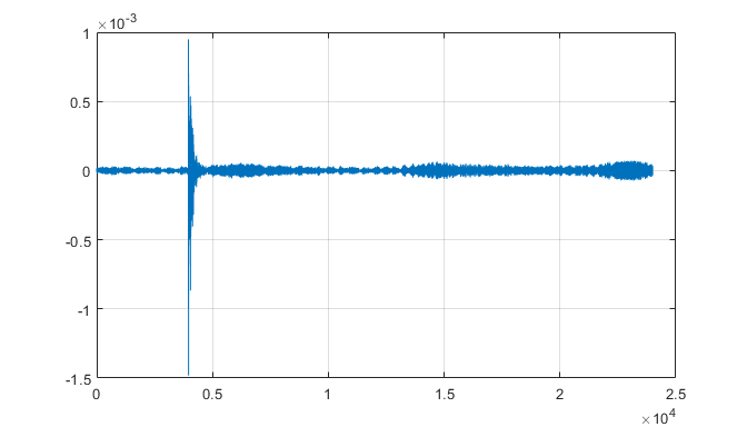

If so, what do you think of :That's Ok, I am a mathematician, well, a mathematical statistician...
xspk = original exponential sine sweep + 0.5 sec of silence
xmic = recording of the output
rir1=impzest(xspk,xmic,'WarmupRuns',0);
xres=xmic-filter(rir1,1,xmic);
tres=xres(1:end-0.5*fs);
x1=xspk(1:end-0.5*fs);
x2=x1.*x1;
x2=x2-mean(x2);
x2=x2*std(x1)/std(x2);
x2=cat(1,x2,zeros(fs/2,1));
rir2=impzest(x2,tres,'WarmupRuns',0);
The rir2 would have lots of noise before and after the true IR(second harm) which however can be windowed out. The FFT(windowed rir2) = matched-filter fit estimate for 2nd harmonic
The same can be repeated for Nth harmonic

I don't know, I'd have to see all the details, can you post the complete code, with more information on how the system is set up?If so, what do you think of :
