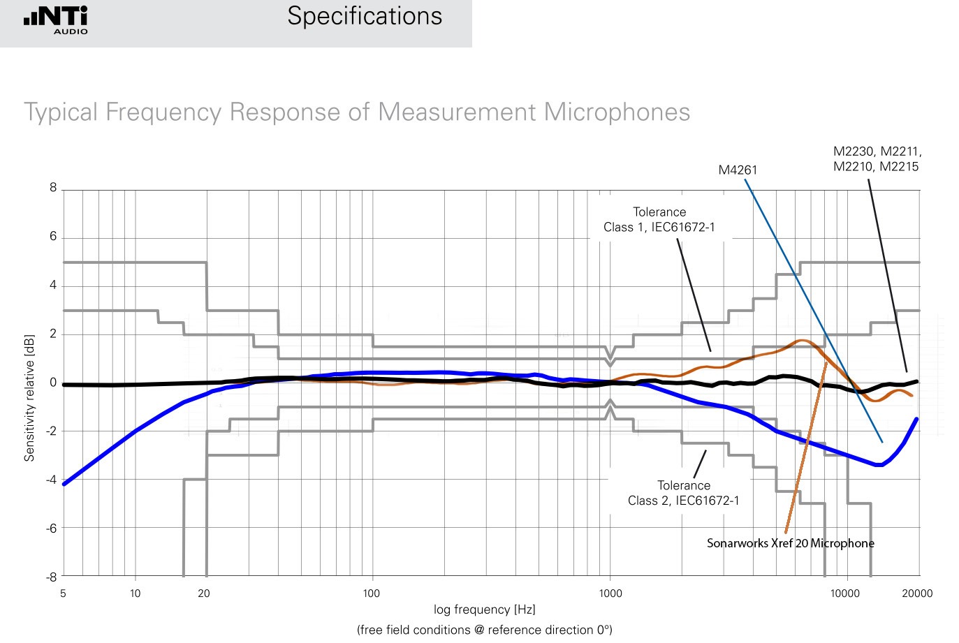

Yes the one for Sound Level Meters, for whatever reason Mic manufacturers use it in their specifications.The only Classes I am aware of, is for microphones with IEC-61672-1 standards for official acoustic measurements.
This isn't true, but with the standard being expensive and not open it is hard to know exactly what is the difference. All I can find is that it must meet the frequency response and be stable within certain heat, and humidity ranges. That seems to be the kicker and why only very few of the cheaper microphones claim to be Class 1 rated overall.Class 1 only concerns frequency linearity pre-calibration for a microphone.
E.g isemCon's data sheet states "Its class 1 frequency response (NOTE: NOT A CLASS 1 MICROPHONE)*"
The Class 1 frequency response covers quite a lot of mics so it may not be particularly useful in selecting a home measuring mic anyway.

I think the designation: “class 1” is only intended for SPL-meters. IEC6172. A Measurement Microphone wouldn’t qualify as “class 1” because it’s not an SPL-meter. Perhaps then a “class 1” mic meets more of the parameters for a class 1 SPL-meter than just the linearity?
IEC61094-4 (which I think lasted less than a year before being removed) concerned Measurement Microphones and did have many parameters but I believe not designated as “class 1 or 2”.
-anyway, it’s really just “academic”. I’m sure the M215 will be far more stable than any electret mic’s - including the Earthworks mic’s.

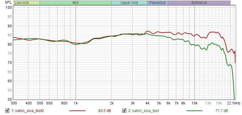

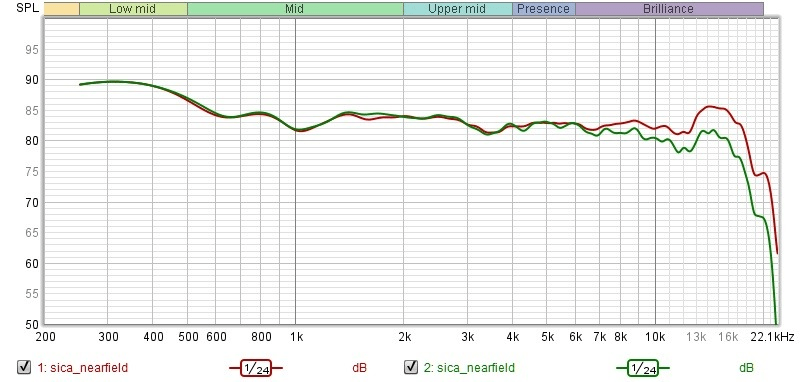

I have 3 measurement mics
1) MiniDSP UMIK-1: bought 4 years ago
2) Dayton EMM-6: bought 2 years ago
3) Sonarworks SoundID reference mic: bought less than a year ago
Here is a comparison between the EMM-6 & UMIK-1 mics measuring a driver (with mics & driver kept at almost the exact same location and height)
Red trace is that of the dayton emm-6 and green trace is that of the minidsp umik-1
Here is a comparison between the Sound ID & UMIK-1 mics measuring a driver (with mics & driver kept at almost the exact same location and height)
This time, the red trace is that of the minidsp umik-1 and green trace is that of the Sound ID
(Unlike the legend in the above pic, driver was measured from 1m away and not measured nearfield)
To my ears, the sound calibrated with the soundID reference sounds the most balanced among the 3 mics.
Only God knows which one of them is the most accurate (although I like to believe it is the Sonarworks SoundID reference).

Have you ever checked the allowed tolerances for a Class 1 microphone?Yes the one for Sound Level Meters, for whatever reason Mic manufacturers use it in their specifications.
It's fine for general acoustics, but for loudspeaker design, no thanks.
What the IEC-61672-1 standard does, like any other standard, is to ensure a default platform or reference.
In this case, to make sure that acoustic engineering companies all test and measure according the same reference.
Since there are many legal implications involved, like environmental and safety laws, this is basically mandatory.
Totally not interesting for loudspeaker design.
It's mostly just paperwork you pay for and like I said, even the tolerances themselves are meh.
To lazy to dig up the official documents I have stored somewhere, but this graph will give you the basic idea;

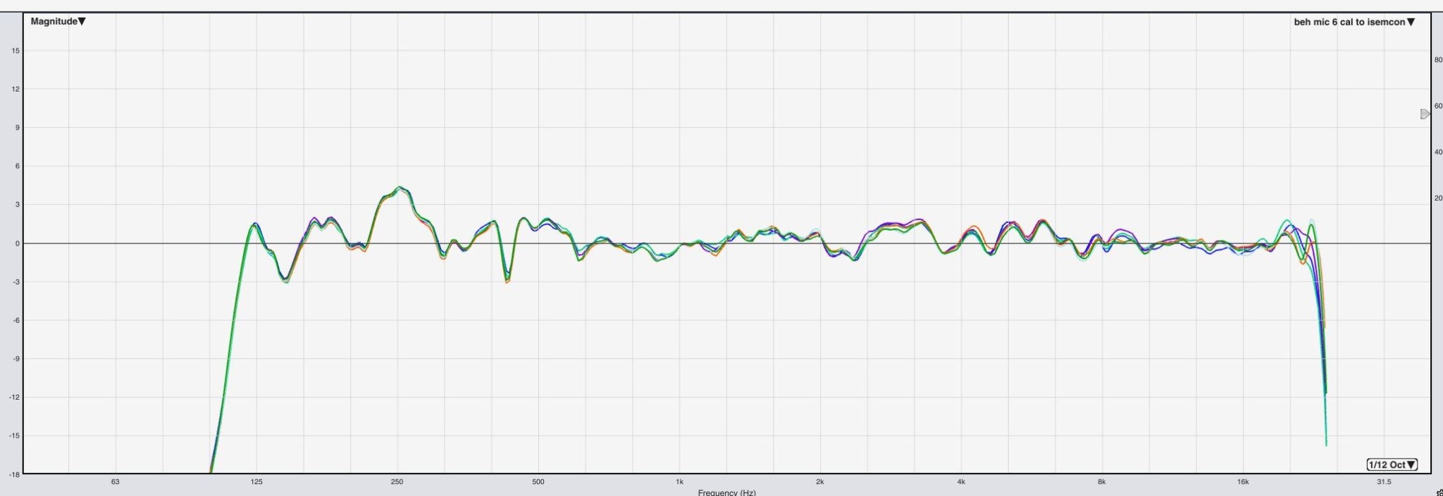

I'm another happy camper, with the iSemcon EMX-7150. No clue how totally accurate it is, but i did get to measure it against a pair of M30's at a measurement workshop, and all three mics looked nice and close.
I use the iSemcon as a calibration device for a handful of the very low cost ECM8000s, by building a txt file to get the each of the Behringers to match it.
(Because I have an outdoor vertical mast that holds 5 mics...and don't want the expense of 5 EMX-7150, or the sometimes potential weather exposure before I can strike the rig).
Here's a trace of the EMX-7150's measurement of a speaker, and 5 ECM8000s with txt file calibration made for each of to match the EMX.
Seems to work well I think.
I offer this as an idea for those needing a XLR mic, moving on/up from a Umik.
IF you have confidence in your Umik, get whatever XLR, and match the Umik.
Save some $$.🙂

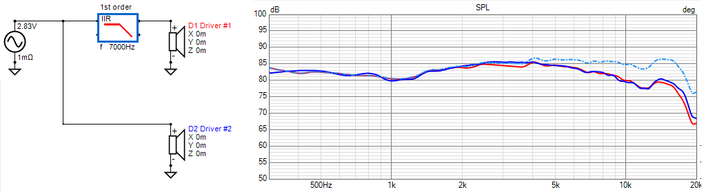

What I mean is during the crossover design that the highest treble measured means the final speaker design needs less treble boost, if that makes sense. The one that measures the most treble output, needs less to correct to "theoretical flat" response. I think we're on the same page.
A good idea, reference the "bad" mics to a known good, assume this was done by making own calibration file with an "A minus B" scenario? I've never tried this. Be interested to hear more.

Interesting, because a roll off at the top can sound the most natural.
It highlights the fact that calibration mostly affects voicing, which is often done on a listening test basis anyway. The crossover itself isn't affected since you need relative information there. Whatever the mic does to response can be fixed outside the cross using EQ.
I have no way to verify the accuracy of these mics at the moment, well, at least until my ISEMCON EMX-7150 reaches me in a couple of weeks (with the hope that at least that one is the most accurate) 🙂
I have similar measurements except I think my order may be the other way around. Will have to dig them back up and check. Thats crazy though, a 6-7db difference at 10kHz between the emm6 and the sound ID. Thats crazy audible (if one is used to design a speaker vs the other). And 3db around 5khz, that can fatigue you.
Yes and in terms of frequency response alone it means nothing. The image you posted was in the link I posted above. The point was that there are some other factors that detemine the Classes such as stability with heat and humidity. Where I live this could be an important factor.Have you ever checked the allowed tolerances for a Class 1 microphone?
