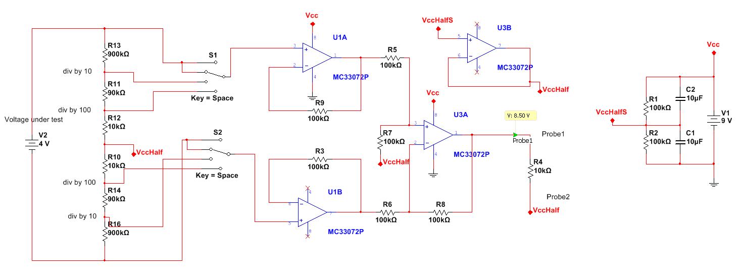

I am examining this because the differential circuit was going to have such a resistive network at its front end.

Hi, yes just that. Since the oscillator is truly floating, to the best of my abilities, I figured it would not make any/much difference if I earth its common, or its output pin. However this is far from true, and not intuitive at all. It is part of the "mystery". I did not have time to think about it more, and that's why I did not reply earlier, nevertheless, if one side of the circuit has just 2pF more earth capacitance than another, then at 200KHz 2pF is 400K Ohm, and that would account for the "weird" results. Part of that was observed, I think, when I powered the circuit with two 9V batteries, and then realised that in some measurement modes, where I did not ground the "common", touching the battery cases surely made a huge difference.
If I ever manage to put all this into the simulator and receive similar readings I will post here. Basically a model of the two batteries, oscillator and probe - so that the simulator reads more or less what I read in practice.
