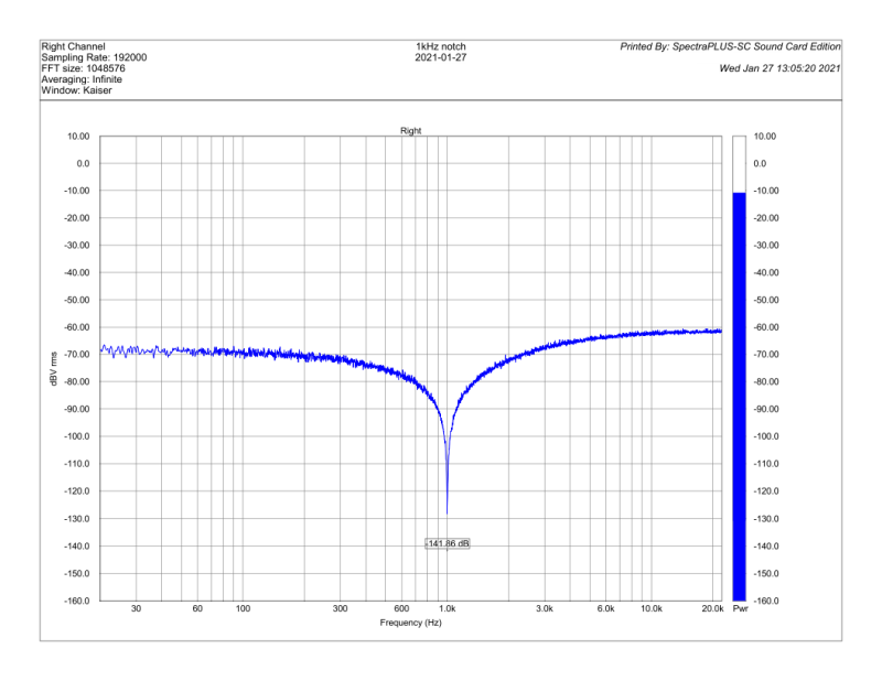

It is a passive twin-T followed by an amplifier. Based on my experience testing power amplifiers, a post-notch-filter amplifier is not necessary and even harmful, as it increases the noise floor considerably.The notch filter is a balanced implementation (or dual SE) based on Jansek.

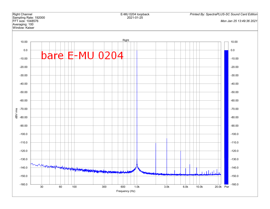

In your measurements, you seem to be able to resolve signals down to about -140dbu, or -138dBV.
My measurements above show that a bare sound card without any external amplifiers achieves the noise floor about 10dB better.

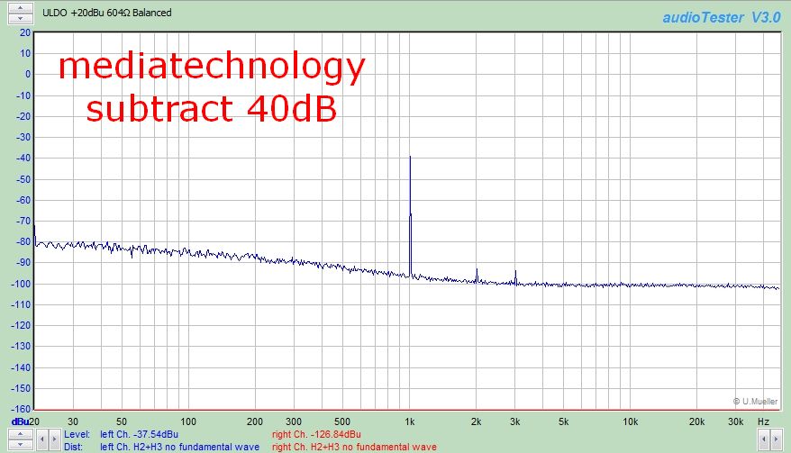

The oscillator output level in my example is +20 dBu.
I've been working on a low distortion oscillator
The fact that the fundamental before the notch has a high level attests to the quality of the oscillator. Designing a low distortion oscillator is a great achievement. Yours seems to be on par with some good designs out there, so congratulations.The oscillator output level in my example is +20 dBu.
My point, however, is different. In order to measure low distortion with a sound card, you need to be able to see the harmonics on the FFT graph. Using a passive notch filter to suppress the fundamental is one of the possible ways to achieve that. By using an extra amplifier after the filter, you are giving away 10dB of resolution for no apparent reason. With the amplifier, you can see peaks at -138dBV; without it, at -148dbV. In other words, you should be able to see more detail by dropping that amplifier and keeping just the passive twin-T.

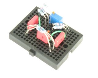

There is another option for the topology of a passive notch filter - the Hall network:
Like the twin-T, the Hall network requires three capacitors and three resistors. Unlike the twin-T, the capacitors are identical. However, the best feature is that the Hall network can be made tunable. The details can be found in the attached article.
With unmatched capacitors and with each resistor made of three E24 resistors in parallel, about 80dB rejection of the fundamental can easily be achieved:
Disclosure: in the past, I organized a group buy of PCBs for a low distortion notch filter designed by Samuel Groner, using this topology. The interest was so high that I did not have a single board left to myself. The above results are from a filter built on a solderless breadboard:

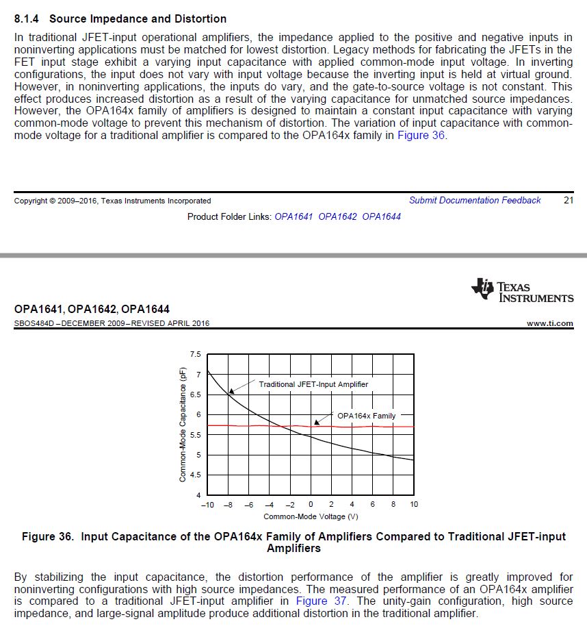

That's a common effect usually caused by the common mode distortion. Drive an amplifier circuit with 10kOhm and you will see distortion that typically rises with frequency at 20dB/decade. It doesn’t matter whether it is JFETs or bipolar, op amp or tubes - most amplifier circuits have non-linear input impedance which causes this.When using a 20K+20K resistor as a voltage divider to reduce the signal source voltage, I observed a very significant distortion deterioration.
A passive notch filter has high output impedance - in my builds, 10s of kOhms - and thus requires some measures, such as a buffer, to prevent common mode distortion.
May I ask you to post the doc or a link to it?There is a doc. "Distortion and source impedance in JFET-input op amps by John Caldwell"
also...Analog Design Journal archive: https://www.ti.com/lit/sg/slyt778/slyt778.pdf
As noted in the TI Analog Applications Journal 2014 4Q note in thread post above....
The SOI JFET input OPA1641/1642/1644 looks like a nice choice for high input impedance and low harmonic distortion non inverting applications, due to minimal voltage dependent (varactor) common mode capacitance on the differential pair & tail current.
The CMOS LM1656 might be an interesting op amp to compare for high input impedance and low harmonic distortion non inverting applications. The voltage dependent (varactor) common mode capacitance on the differential pair & tail current might (?) not be as low as the SOI JFET input OPA1642.
