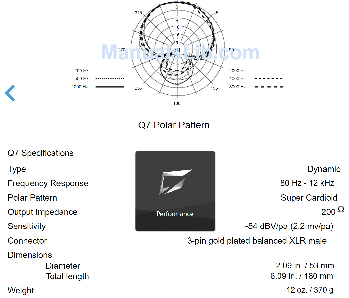

They don't have the sensitivity, frequency response, linearity, low noise, etc., as compared to mics normally used for mic'ing a room and its reverberant decays. If you want to see if the speakers can reproduce that you need mics that are significantly better than the speakers. Otherwise you might learn something about your gear, but you probably won't learn things that apply more generally. For instance, in another thread a member described performing listening tests and found nobody could distinguish AAC lossy encoding from CD. Well, he was using an RPi hat dac and didn't seem to be aware of all the problems with that. Those problems can be mitigated but it can be complicated and expensive to do very well.

And if i may: hypercardio won't be an issue if the kind of couple selected have a correct SRA and is carefully crafted to not induce too much angular distortion or compression.
But in the end... in ear mics binaural is the best bet for this kind of things imho.
Mainly because it mimics our auditory system ( delta amplitude+delta phase+ shadowing of our head+HRTF) and it's important if we want to explore this imaging thing ( especially HRTF).
