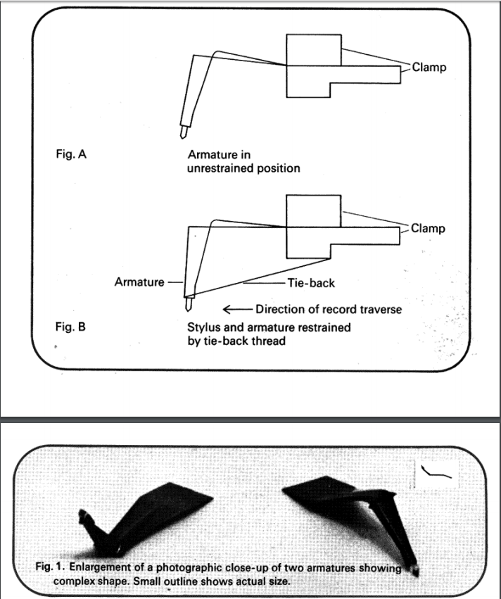

Actually, bending moment is OK at the stylus end. Cantilever, and the stylus, is free to pivot about its contact with the vinyl, but otherwise the stylus is not free to move because it is retained in contact with groove walls via VTF. This, in combination with conditions at the cartridge suspension end, determines what vibration modes are available to the cantilever. Both the TL model and classic bending models converge on similar answers, of course.Well, all the cantilever model asks is zero bending moment and zero shear force at the stylus end, an assumption I'm happy to embrace given the MUCH greater magnitude of both moment and shear at the "fixed" end of the cantilever.
Just about all conventional literature assumes that the spring comes from vinyl compliance, rather than cantilever flex. Decades of stuff by very credible authors assume it, and take it as read, but I doubt it is either true or possible. Rather, I prefer that the spring physically lies in the cantilever. Heresy, I know, and a minority of one against a body of conventional wisdom, but I'm pretty convinced conventional wisdom is wrong on this one...........!PS: I gather that there is a school of thought that it's the stylus/vinyl interface that produces the resonances of the cantilever assembly. Anyone have the literature on that?
It matters, IMO, because it affects what one needs to look for of merit in a cart/cantilever to manage/avoid audioband mechanical resonance, as well as stylus profile selection and all manner of corollaries.........

If someone can measure the behavior of Decca cartridges with the totally different cantilever construction from all the other cartridges, the origin of the resonance may be traced more realistically.

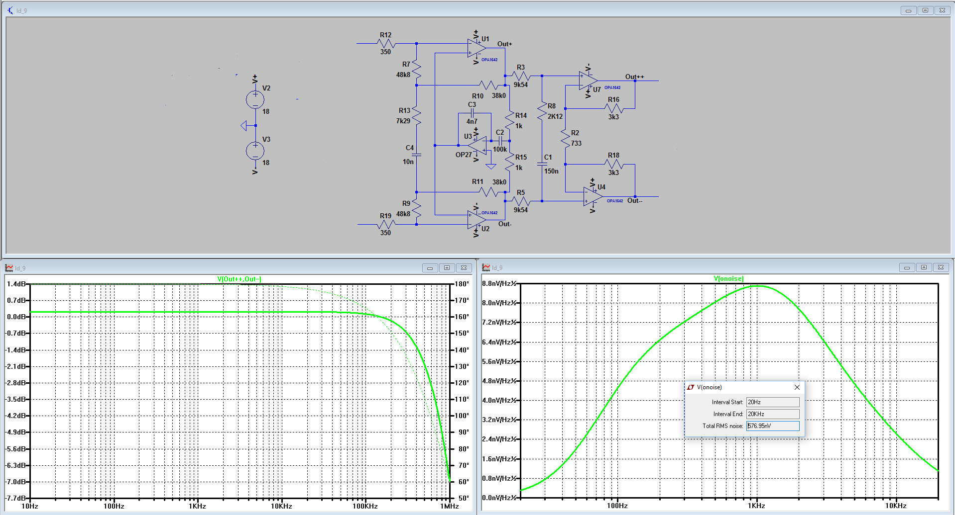

Still not happy with the results, I decided to trying to get better noise figures, more flexibilty in gain setting and much better CMMR figures.
So below is the final circuit diagram that I designed with LTSpice.
- S/N ref 5mV@1Khz is now 78.8 dBA, an improvement of a full 10dB over the original SE circuit diagram in posting #204.
- The 318u and 3180u correction network is now made passive, making it possible to change overal gain just with R2.
In the original design, gain setting resistor was part of the correction network making gain changes very complicated.
- Overload margin is more than 30dB over the whole audio range
- CMRR is now ca. 60dB when using 0.01% resistors and when including U3. With the SE version there is no CMRR at all.
- FR is within 0.1dB up to 400Khz.

Hans you must be telepathic. I was just mulling some questions to you on this and here it appears. I'll ask the unanswered ones.
1. Have you an idea of how low you can go with this generator impedance wise? Whilst the noise is too high out the box for a 0.25mV MC the 2.5mV of the Benz ebony H I will be getting should work, but no specs for the coil other than R.
2. Have you given any consideration to an MC version of this
3. For feeding miniDSP balanced input with the 318u and 3180u correction removed I need around 38dB gain. I was considering just dropping the second stage. Any thoughs?

With this Aurak design the trick is to add a resistor in line with the cart, to get a -3dB point at ca 150 Hz.Hans you must be telepathic. I was just mulling some questions to you on this and here it appears. I'll ask the unanswered ones.
I do need to build this one. If anyone is considering laying it out I'm game for a few board. If you wait for me to do a layout you'll be waiting about 2 years!
The first stage then starts increasing its gain at 150 Hz an stops at 75 usec, the third Riaa time constant. The combo of cart and first stage now having their -3dB at 2Khz. From thereon the other two time constants have to be applied and that's it.
But now for an MC Cart the world looks completely different, because its coils has a very low inductance not causing any roll off in the audio range.
So when using a miniDSP you could use the virtual input of an amp with a flat FR and do all the time constants within your DSP.
The AD797 is a very good Amp for this purpose, but there any more options depending on your wishes.
I have no experience with virtual input MC amps, but I do not see an advantage over a conventional voltage amp. None of the commercial top performers IMO has a virtual input, but it is certainly worth trying, especially when having a design that can be switched between current and voltage amplification.

I have 4 presets on miniDSP so having seperate MM and MC eq on there is no killer. But LD did say he uses a DL-102 and I wonder how he implements that.
The DL-102 produces 3mV at 5cm/sec @1Khz and has 240 Ohm DC resistance so it looks more like an MM to me.
Your Benz is definitely an MC.
Amplify the signal a factor 100 and you are able to do the rest of the processing with your miniDSP.
Hans

Well I now have another S-120 stylus this time with the cart attached
We still haven't found any mechanical resonances that need filtering, but I think we are going good work here
