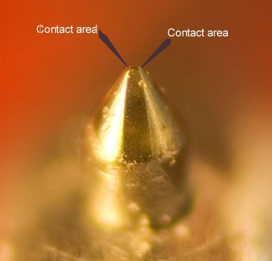

It varies, but generally somewhere in the conical section and usually one can see the witness line. For the S-120 it's probably not shown on that image, because of the scale.LD: where does the diamond end and the shaft start on that?
It's easier to see in the image below from the archive, which is also marked up to point to the location of the only bits that matter: the contact regions.
The resolution needed to see detail in the contact regions is impossible with optical microscopy, unfortunately. And the same problem with detail on corresponding groove walls.
One can see how different styli are made, and especially the true-biradials such as the nude 2M Blue I posted previously which differe from pseudo elipticals in obvious ways.
Anyways, here's another bonded one with a markup of contact points. Tiny aren't they ? Also see how the base point shape varies, as per my critique of the Hunt/Barlow/Walton indentation method. This one ends in a fine chisel like shape.

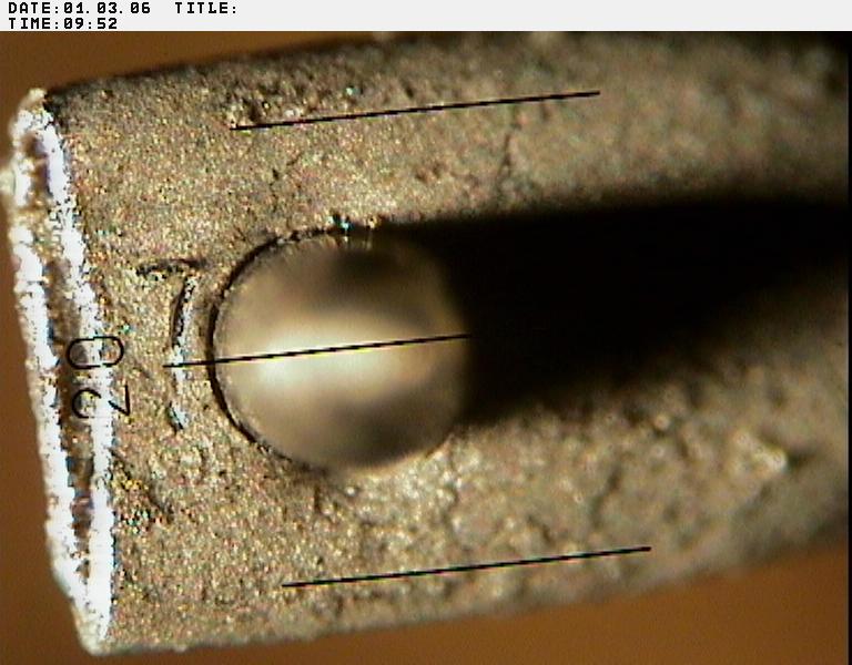

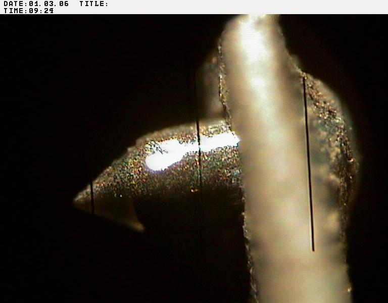

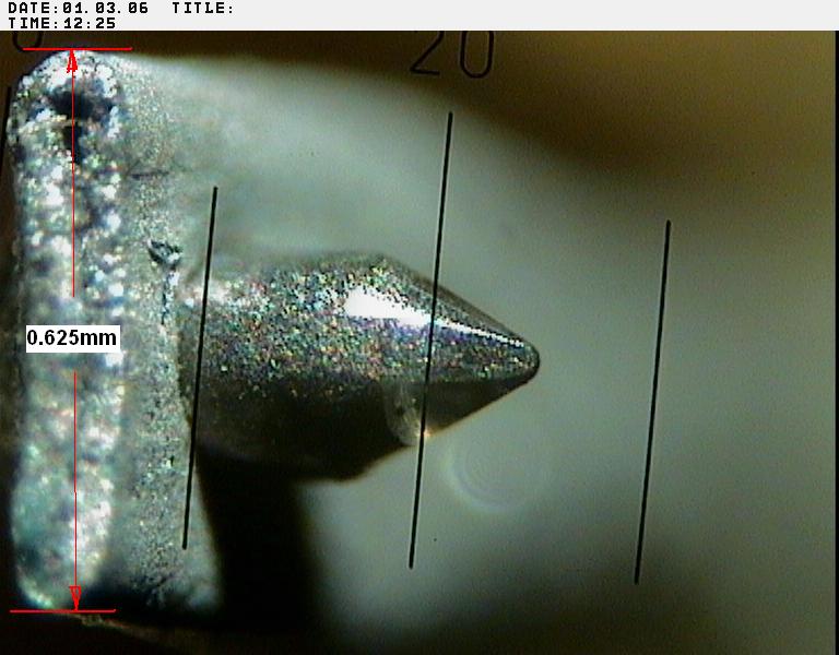

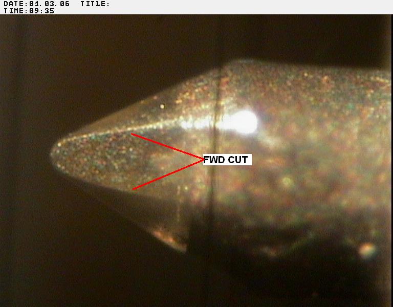

These with industrial RV equipment
(optics) Olympus rigid borescope
(camera+electronics) Karl Storz Technopack
Shure M97 xE cartridge
N97xE stylus with biradial (elliptical) diamond tip, 5 x 18um
(.0002 x ,0007 in.)
