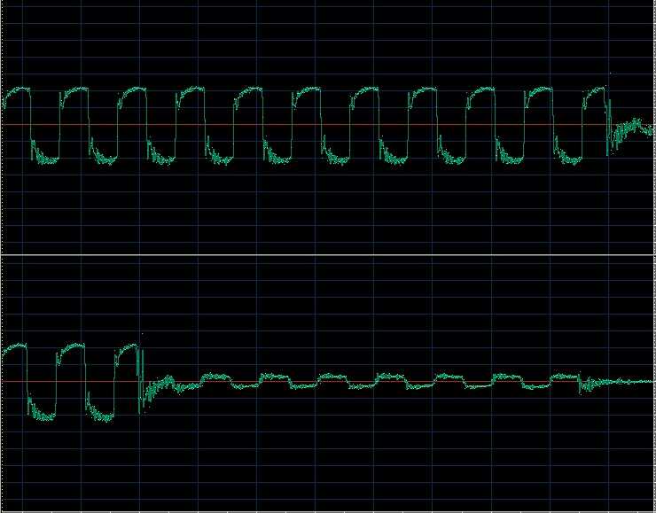

FYI - Here is the STR112 side A on my setup. The first is Lateral 5cm/sec tri-wave @ 1kHz outer groove, second is inner groove of same. Yes this disk is recorded as an analytical signal directly to the cutter and they claim great care was taken to get the displacements and velocities exactly right.
A little bit of overshoot on the inner grooves, but to me that looks pretty darned good especially for a £180 turntable.
EDIT - Note the slope changes on the inner grooves, I hope LD has a story for this. 🙂

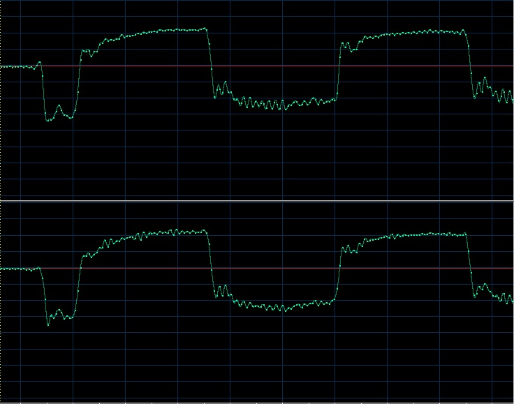

If cartridge output is a square wave, the stylus is physically transcribing a triangle wave shaped groove. The flat portions of the square wave are the long straight sections of the triangle wave, a constant angle. The exact angle changes depending on spindle radius: it's very different for inner and outer grooves, but always a triangle shape.
Edges/slope of the square wave are physically the apex of the cut groove triangle wave. Curvature of this apex increases significantly for inner grooves as the angles mating there become steeper. At some point, either stylus curvature won't fit the apex, or stylus acceleration force at the apex, which is a function of curvature, becomes so great that vinyl deforms*/cantilever bends* (*delete accordingly 😉). The result is that there is a limit to curvature which can be transcribed, and since curvature = acceleration = slew rate of cartridge output, the edges of yer square wave have lower slew rate on inner grooves.
It's real and affects slew rate of programme material too.
Experiment number 2, 5cm Lateral square wave on one channel while shorting/unshorting the other channel. Not one iota of effect from having one side of the motor assembly driving a short circuit vs an open circuit.
That's a good test, and yes, that result's right. The generator converts so little of available mechanical power, that shorting the coil has no mechanical effect because the forces invoked in the generator are many orders of magnitude smaller than those moving the cartridge mechanics.
I would assume with respect to past discussions here any efficiency loss would ultimately translate as loss of SNR? 5mV into 47K is ~50nW so at a 400 Ohm internal loss that would be 1.2uA or is that not a way to look at it?
See above, yes I make it that 5mV into 470 ohms (shorted MM coil) is ~ 50nW, versus perhaps 0.3mW mechanical power available tracing a 5cm/s rms 1kHz groove. That would make the generator about 0.02% efficient. This is why there is no mechanical damping associated with cartridge loading.

If I read the scale correctly, the ripple riding on the flats of the square wave looks to be about 40kHz, with little attenuation. Not much damping at this frequency. Anyone like to suggest candidates for the elements involved?
a) flexure of cantilever between tip and pivot?
b) torsion of cantilever between tip and pivot?
c) ... any others?

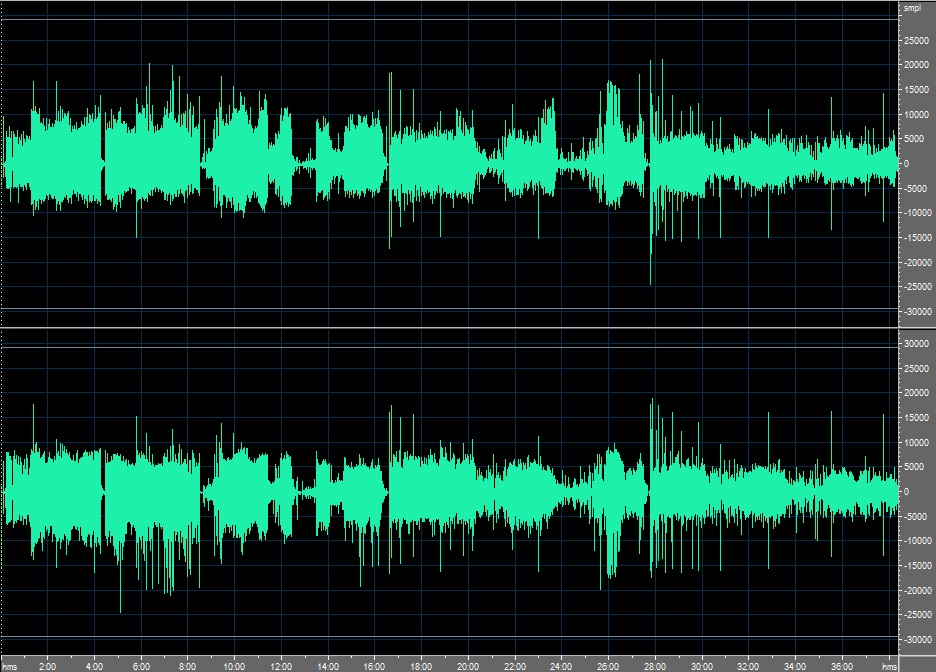

One more test I changed nothing and recorded both sides of the Sheffield Labs Track Record (a turgid collection of 70's memes) and the Crystal Clear Charlie Byrd album (actually nicer than I remember). Not a single over with no RIAA in the path. Apply your digital RIAA and be done with it.
As direct as possible recording, cart buffered by 2SK74 followers directly into Tascam DR-60D mic inputs, 24/96 with 32,768 full scale.
