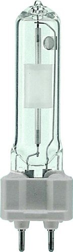

a cdm-t bulb is actually hqi but in a different package and lower wattage, they have a better colour stability, they yeald more light per watt but they also dont last as long, they are more compact too, im getting a cdm-t setup next week well in fact i orderd it 5weeks ago but the company is slow at shipping for some crappy reason so it should be here in a few days, this bulb puts out 13000lm - 14000lm initial life and about 12000 - 11500lm at half life, they last about 6000hrs, are very small mine is 10cm long, the burning arc is just 9mm and are available in single or a double ended socket, the one im getting uses the g12 socket it saves abit more room then a double ended socket, anyway bud ill leave it with u and ill get back to u asap on that ansi code.
Trev
pic below is the cdm-t bulb im getting and is 150w, G12 socket
Trev
