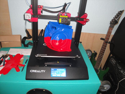

Have a Creality CR-10 S4 purchased almost three years ago now. Haven't been feeling well for a couple of those years and it wasn't used much. Major PITA
But once feeling a bit better took on the task of sorting things out and replacing hardware that wasn't manufactured correctly or correcting in another fashion.
All metal hotend, mine uses a cheap e3d V6 clone, Titanium heat break, Z frame stiffeners. Added a Bondtech clone 4:1 dual drive extruder to the hotend. It's based on the CR-10 Heavy Duty
This Direct Drive HD varient, without filament sensor, drag chain, etc.
Solid bed mounts and self leveling system, unless included are my minimum recommendations.
I added X and Y belt tensioners, Y stepper stabilizer bracket, 1000w heatbed and a Wham Bam magnetic build plate w/PEX. I was #32 on their Kickstarter.
Currently pushing out PETG at 90mm/s and require another hotend upgrade to the e3d Volcano. Extrusion rate is my limiting factor atm. Want to use 0.8 - 1.2mm nozzles. Taulman recommends the cheap Chinese standard brass nozzles on their commercial printers for use with T-Glase PETT. Buy 0.4-0.6mm cheap brass nozzles and drill them out with a set of tungsten carbide drill bits from Harbor Freight. 10 pairs ranging from 0.2mm - 1.25mm for $8.99

Manage it with an Octopi server (raspB3+ and cam). On my android devices manage it with Printoid or directly through the web interface. Using Cura, but am wearing a little thin at how it slices sometimes. Think Simplify3D is on my list... like Bjorn's book that AMAZON still has yet to release! Errr

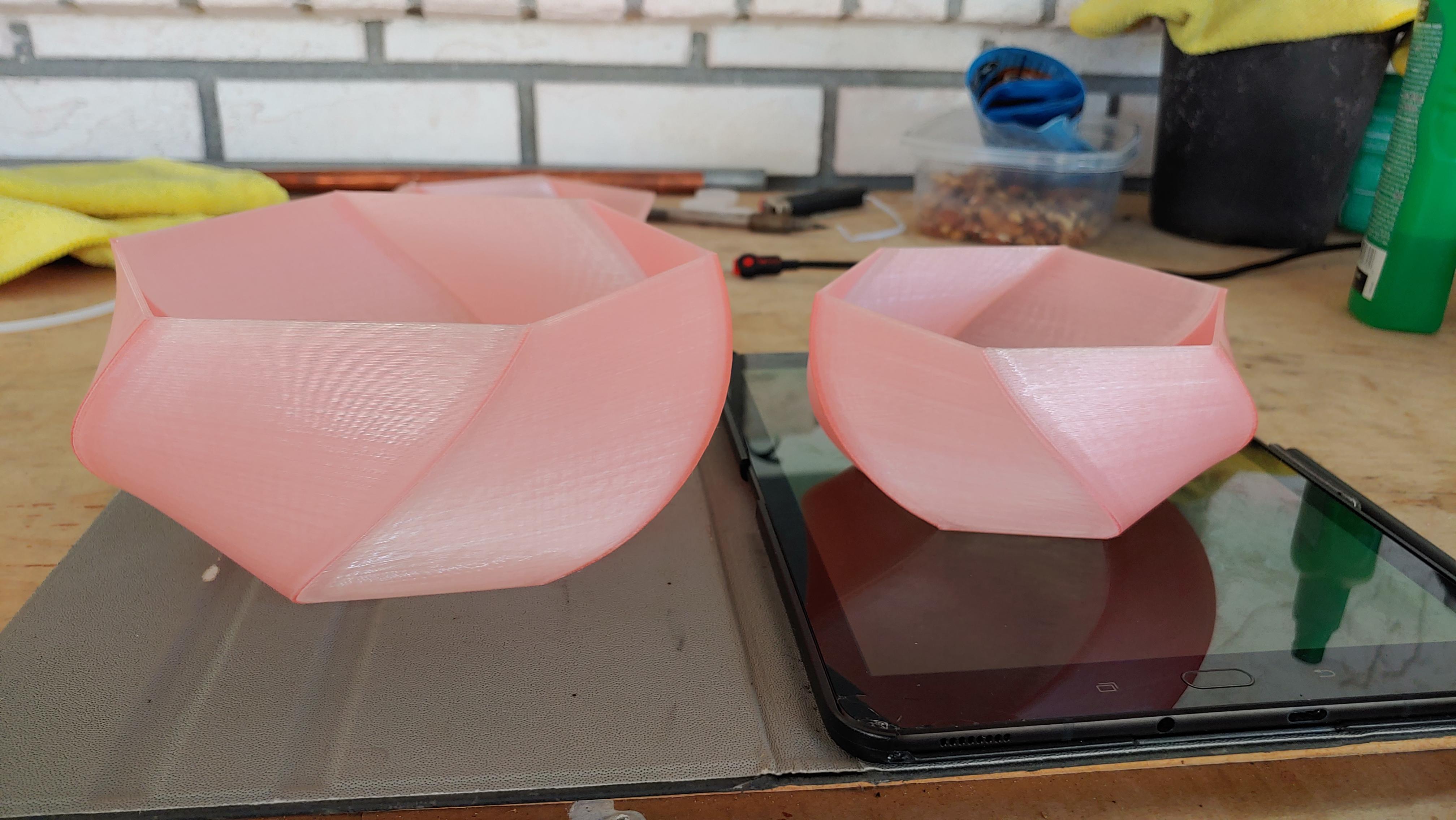

Post processing is very little on these transparent rose PETG (Prima EasyPrint) candy bowls. Sitting on top of my Galaxy Tab S3 for scale. The small one is 75% scale.

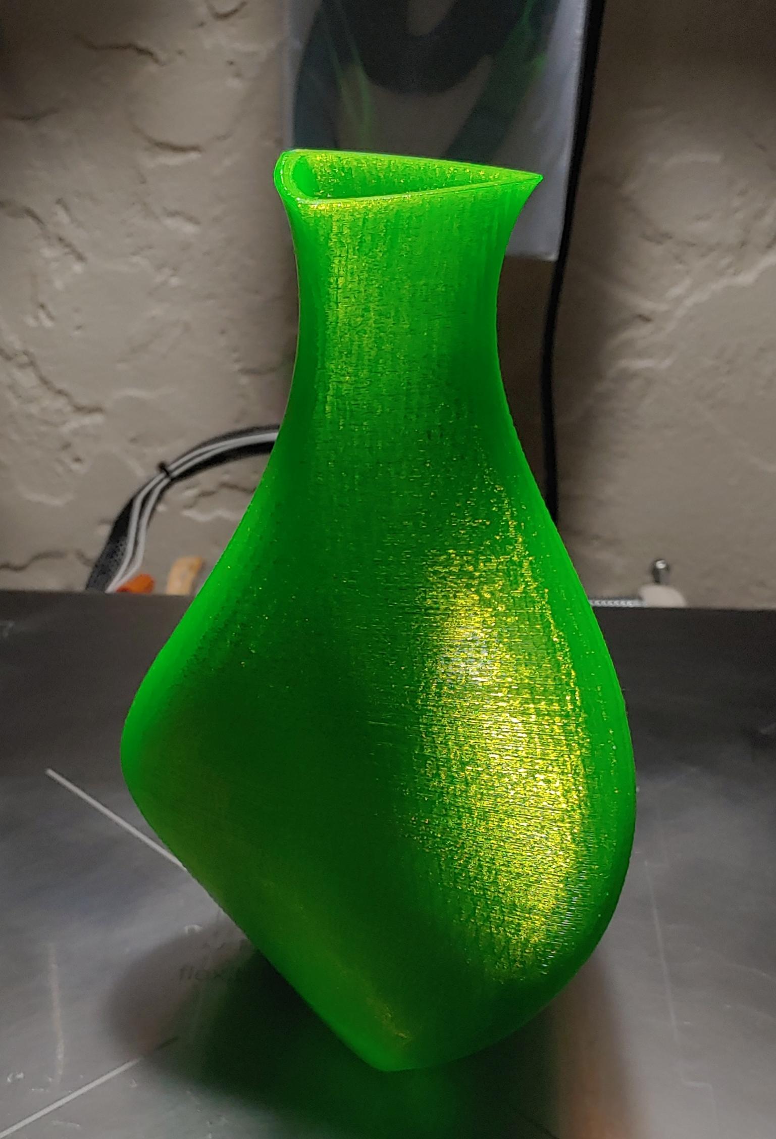

Made the Ctron vase on Thingiverse using 200g YOYI Translucence Green #5 petg.
Call it fluorescent Green with unique optical properties that tends to refract gold colored light. Looks amazing in a window, built tool tuff. Told neighbor to drop it, so he did. It just bounced, not a scratch
get the retractions set right and temps set correct for petg. Going from 2.95mm retract to 3.05mm retraction made a big difference in reducing that 'fine as frog hair' fuzz on my gimmick. Set temp to the lower side of the range scale... but as Patrick has mentioned even color change from the same manufacture has an effect on the glass transition point. I have some Tttyt3D pla that is recommended to work in the 205-230c range. It won't extrude, like not melt even at 210, must be pushed to 225-230. The highest temp material I've run yet is eSUN translucent purple petg which extrudes wonderfully at 242c

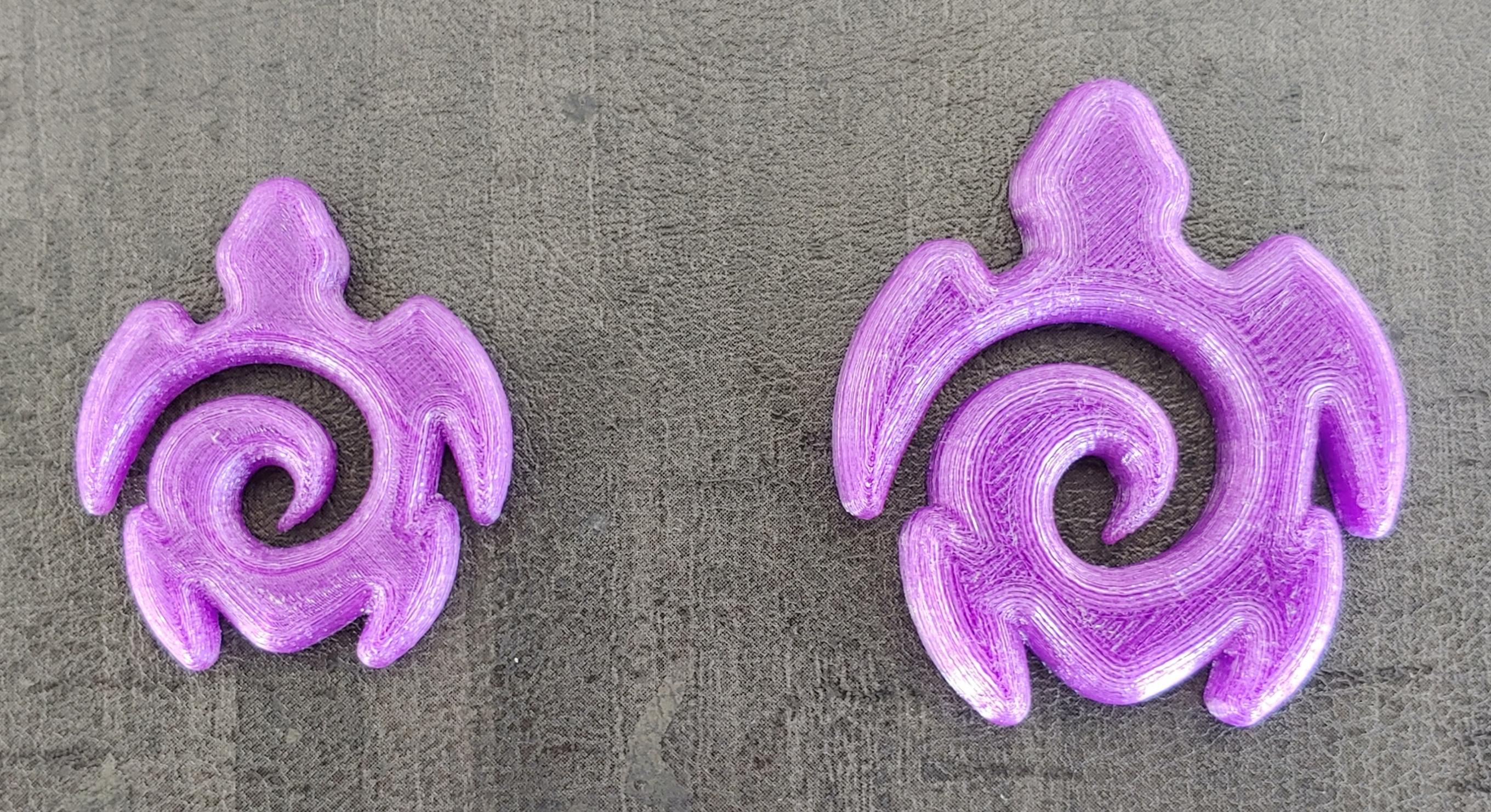

Purple Turtles. The second one is ironed on the top, so smooth as a baby's bottom. Interesting what the camera reveals
Not even going to try ABS until enclosure is built. Patrick what air temp are you shooting for when using this stuff with a heat lamp?

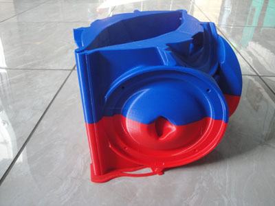

Simply printed in 5 pieces on Zortrax M200 using quality PLA, then glued using CA glue and metal pins, then filled with finnish putty then outsourced to experienced sprayer.
Now I an print in one piece on large printer in just one night. My next attempt will be printed mold and expanding polyurethane foam.
