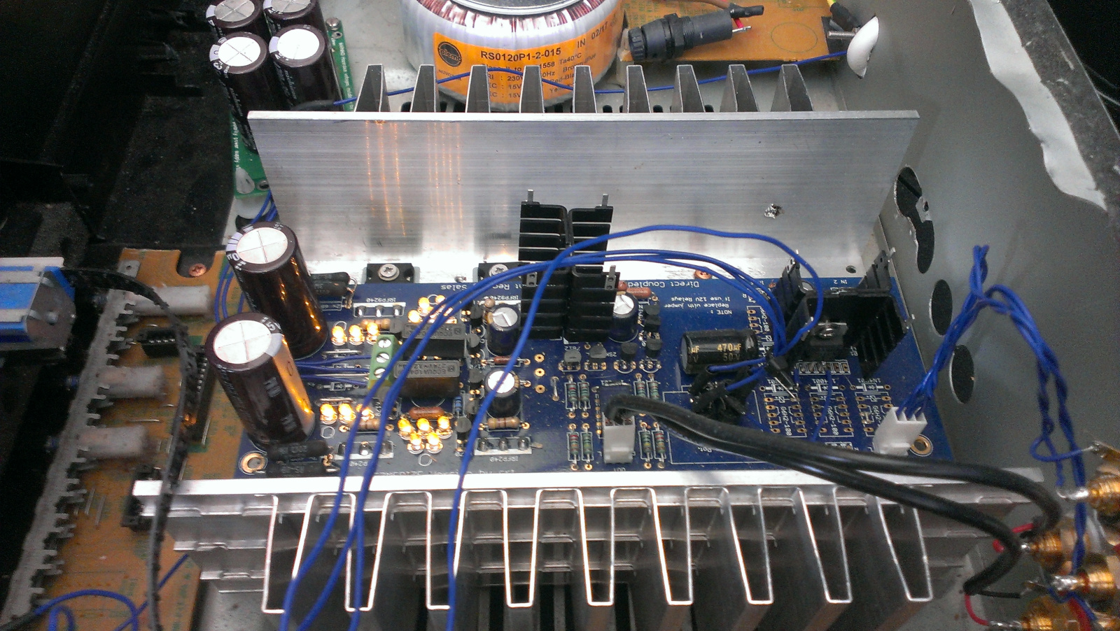

Sorry it's taken so long, but I promised I'd post a pic and subjective findings.
Firstly I apologise for the bodgy nature of the build. I (partially) hollowed out an old Marantz PM55SE to get a temporary chassis. A proper one is still planned but it's non-essential so is in the queue.
The strangeness you can see where the input switching relays ought to be is a power supply for the Lightspeed, which is the strangeness you can see in place of the volume pot. I initially tried sharing a 5V supply with the muting relay, which was the point of going 5V there, but it really didn't like it. So it's a separate tap from the rectified DC input. Getting 5V down from the 18V (iirc) sure put some heat into the regulators, but as you can see I dealt with that by using pairs of board mounted heat sinks, inverted to stand them clear of the boards. They're not too heavy so should be fine so long as I remember not to post it anywhere.
Right, subjectives. For context my other components are a Leema Antila CD player, MC2 MC450 amp, and ATC SCM19 Mk2 speakers. My other outboard pre-amps ones are a Primare P30, a Lightspeed and a MiniDSP DDRC24. It was mostly compared to the MiniDSP. This has caused me some future issues as I'm looking at converting to active in the future and needed the DSP. I can't use it now. I just can't go back. Everyone has their demons they chase through their systems but my main one was a slight graininess/harshness/glassiness in the upper mid-range. It's gone now. The improvement in detail and clarity while still expelling that hardness and sounding smooth and natural, is something I thought I'd never achieve. As such I find that the Mez especially shines with acoustic material. It may be me, I need to do some more A/B, but I wonder if the bass has lost a little definition. If so I suspect that's down to the impedance of the Lightspeed. More playing is needed.
Finally, I think I found a flaw in the BOM. It suggests two 300 ohm resistors if using a 5V relay. I found that it needed just one to get the right voltage.

diyAudio Chief Moderator
Joined 2002
Congratulations. Nice results. Happy that you like it. You don't use an input relay I think? When using an input relay also, there will be double the now drop across that resistor. The output delay relay & one selected input relay will be engaged all the time, thus half your now Ohms value should be adequate then. Hence the place for another 300 Ohm in parallel. Maybe 2x250R or 2x270R would drop the 12V line closer to 5V nominal feed. There are tolerances but each coil should be drawing about 28mA at 5V (178 Ohm load). Such relays also have 3.75V must operate voltage spec so feeding dead on 5V to them isn't necessary anyway. For 12V relays no resistors are needed, just a jumper link in one of their places as the note on the board reminds.

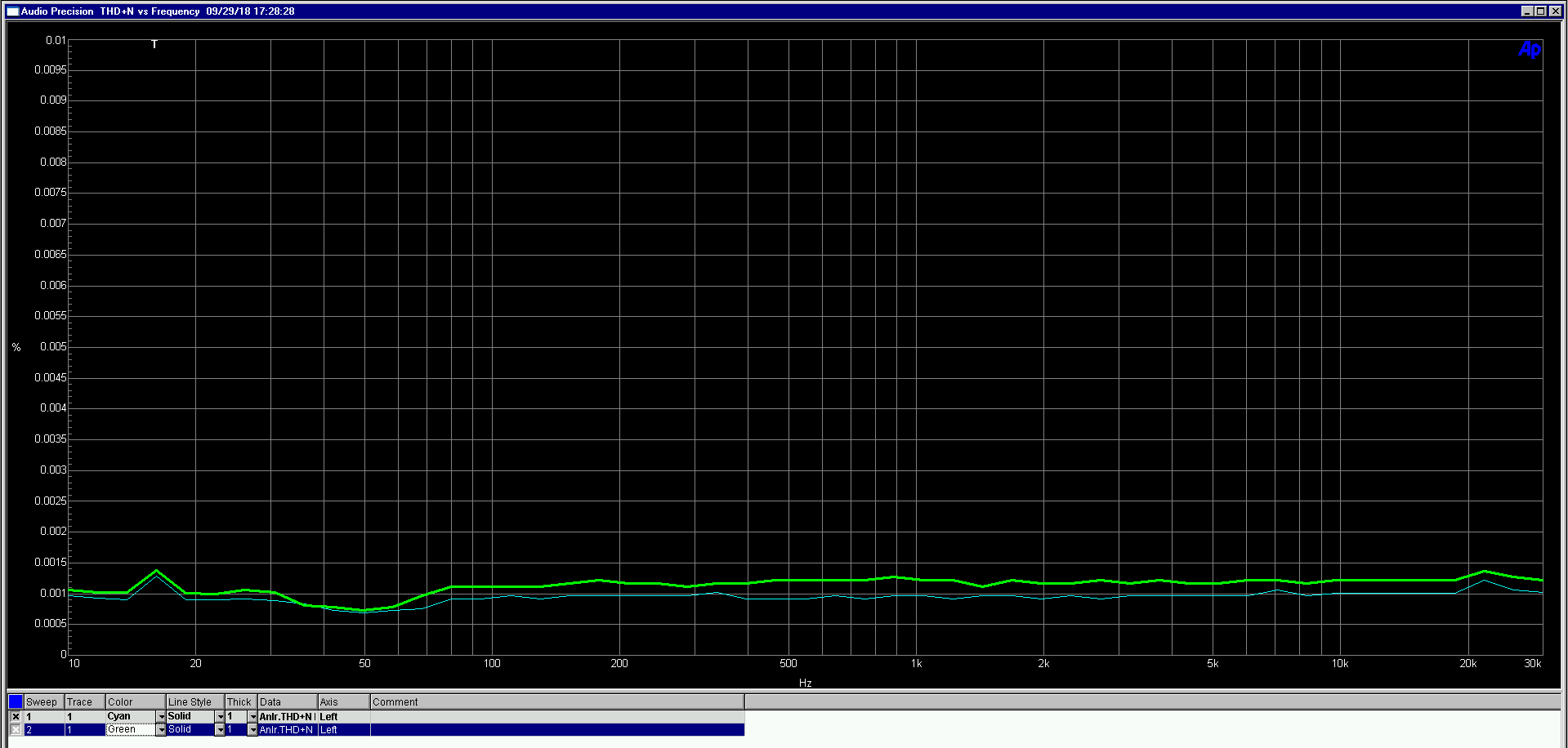

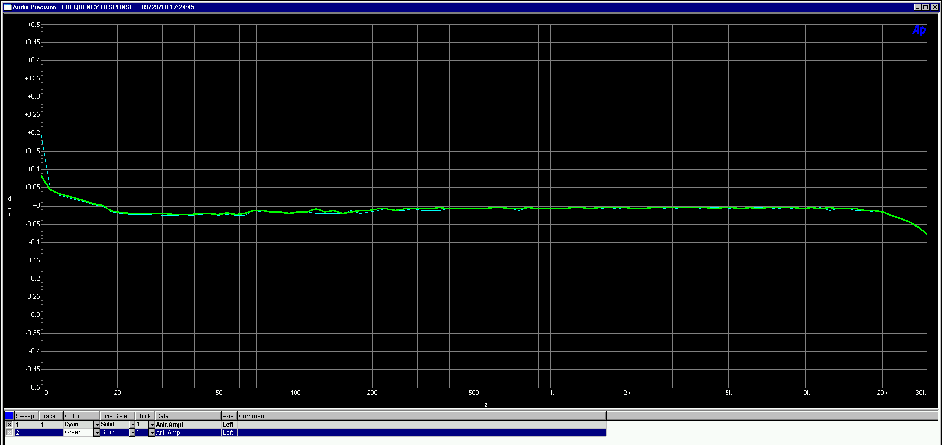

Yeah, I wanted to try without the lightspeed as it was exhibiting some rather extreme non-linearity in volume, which made me concerned about compatibility with my sources. I'd like to measure both ways but am under no illusion that THD+N will go up.
Apologies for the crudity of the tests there. It was a quick one, as evidenced by the lack of smoothing. We (it's not my test gear) have tentative plans to do a proper and complete set of tests from which accurate specifications can be derived. Of course that will include distortion vs. amplitude. Have tests ever been done by anyone else? If so it would be interesting to compare.
The conditions of the above were unity gain and 0dB / 0.775V. Also it wasn't warmed up, if that might make a difference.

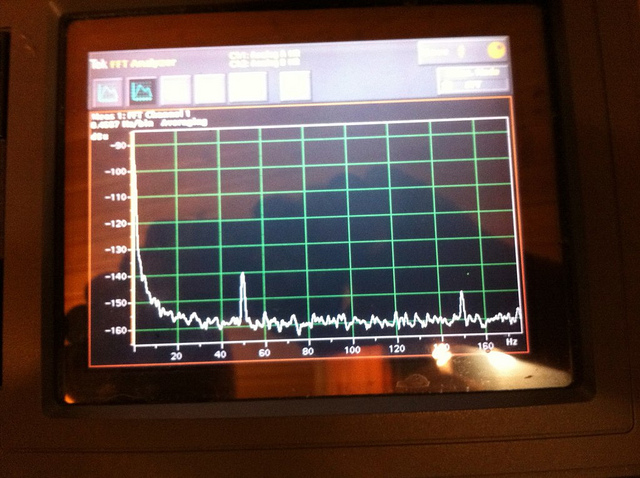

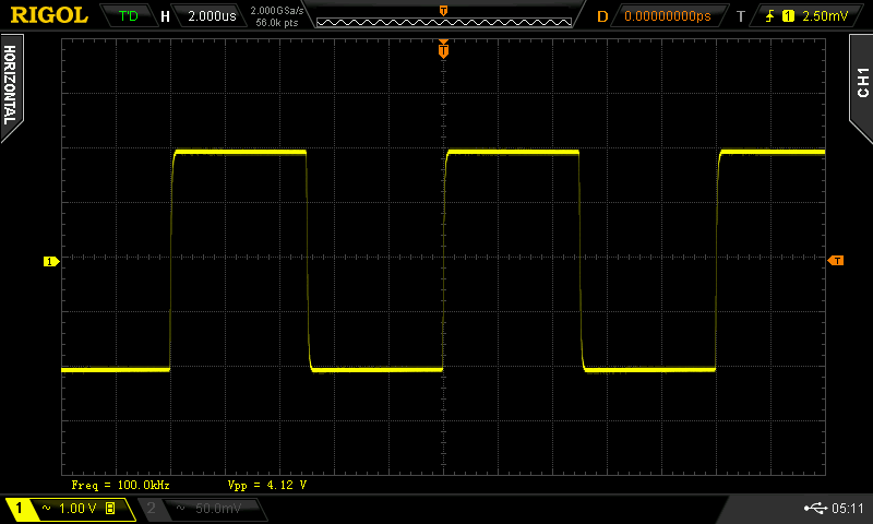

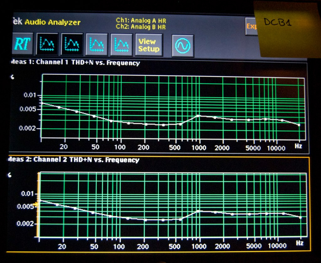

Joined 2002
There was a set done on a Tek analyzer by Spanish member Ramallo many years ago. Details about the THD sweep level were not given, only what was on a picture. Those curves were more zig zag and somewhat worse in % than yours on the AP station. His was a full inputs wired and boxed unit so it could also have its own peculiarities of shielding, transformer proximity, grounding.
My prototype's 1kHz spot frequency FFT done on an EMU interface ten years ago was about 0.001% THD+N at unity gain as yours shows there and in many other frequencies nonetheless. The second picture is the PSU's hum on the Mez board. The third is 100kHz square wave response done with a better scope at a later point by me.

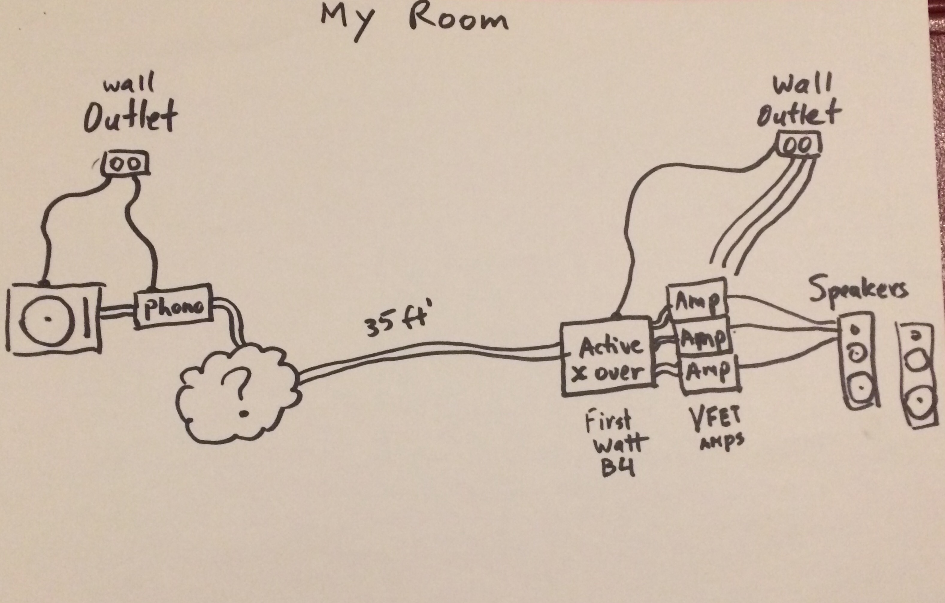

Joined 2002
Choose something with significantly more current reserve than a B1 to drive 35 ft interconnect. All that B1 has is 7-8mA from its signal path JFET IDSS. The cable's capacitance demands more current as the frequency gets higher. The longer the cable the more its capacitance.
