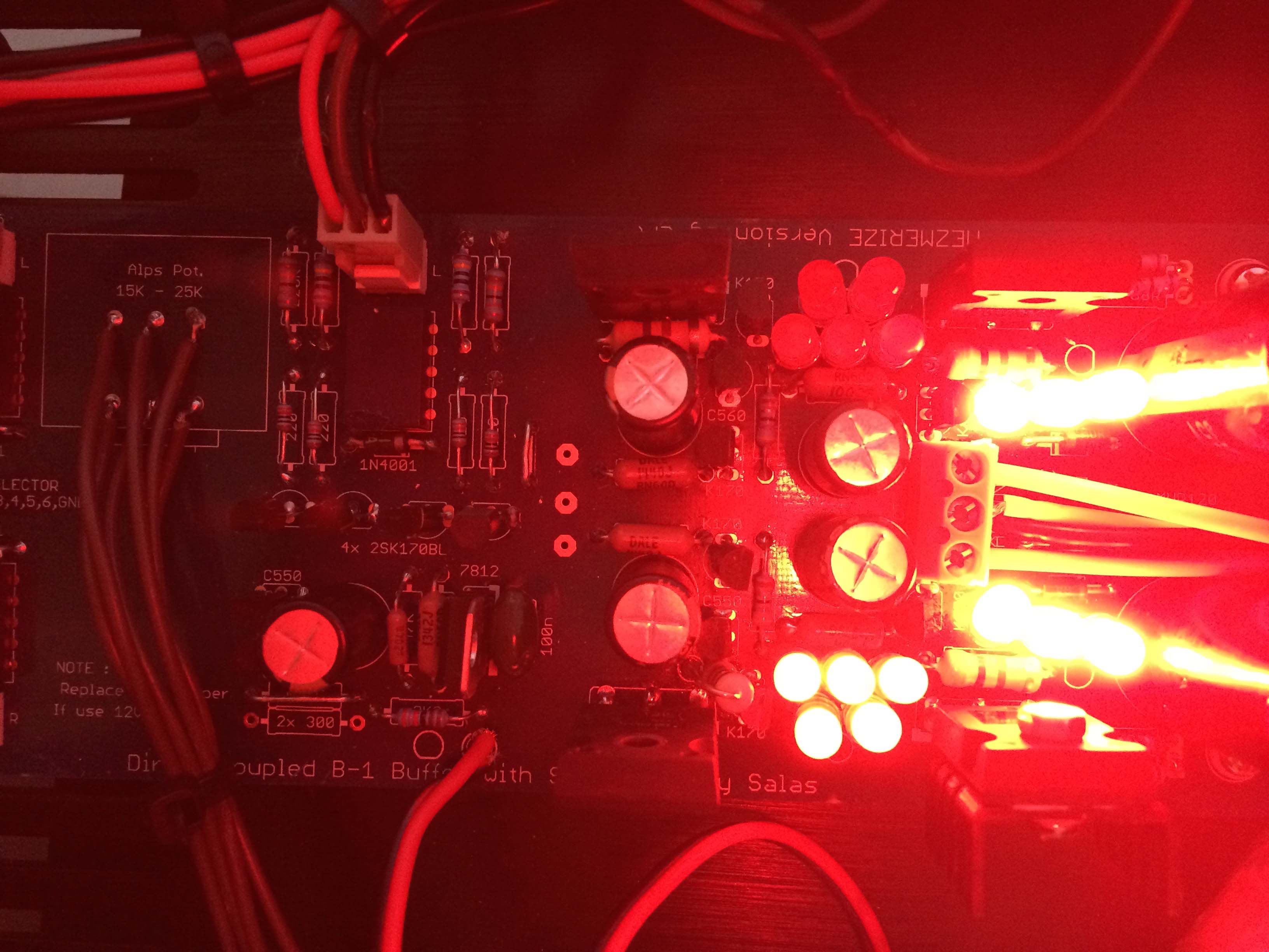

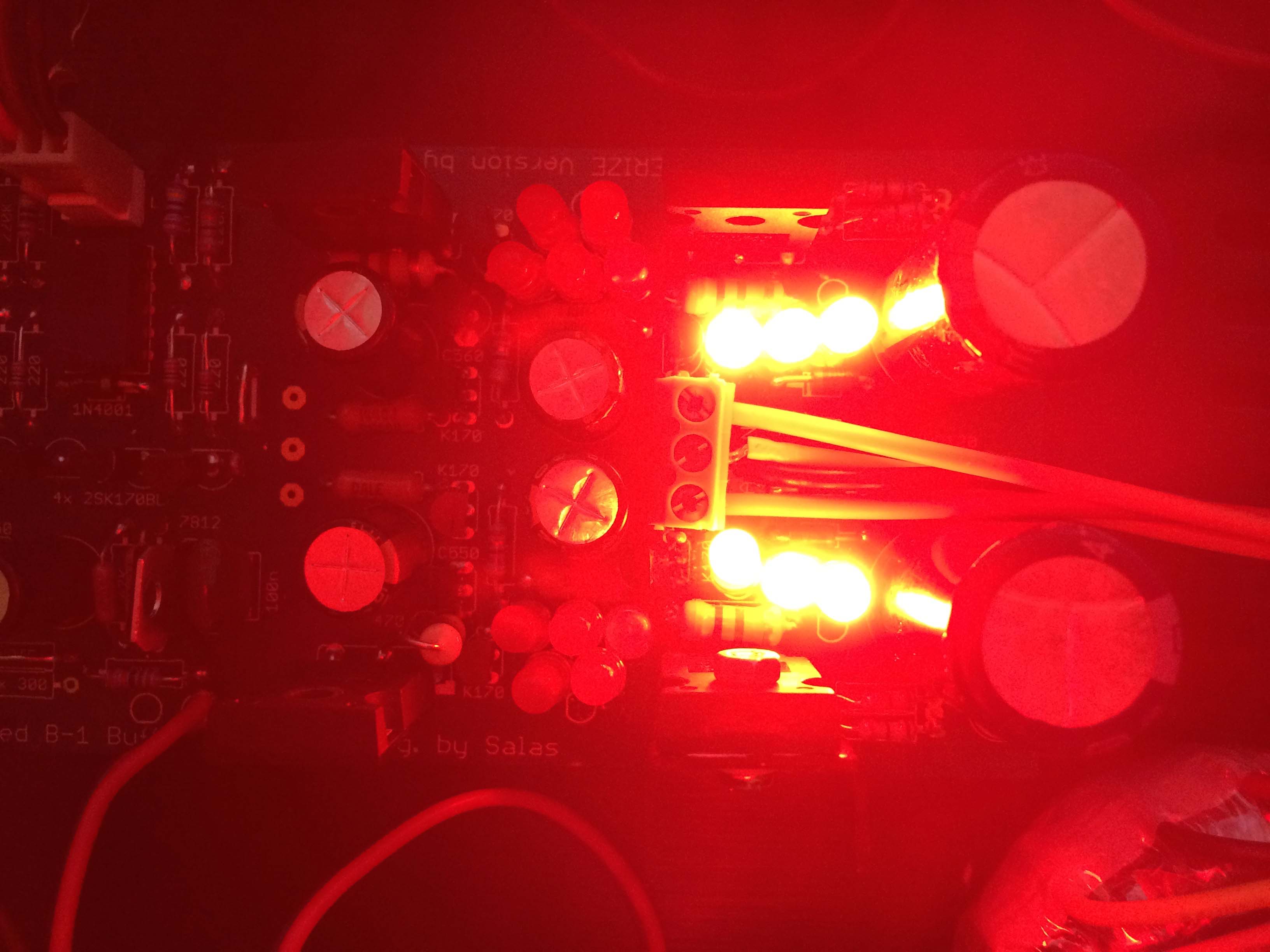

LED Issue
I have just finished my Mezmerise - in standard form and it works well. There is just one puzzling issue regarding the LEDs
The inner group come on soon after startup and then go off, only to return some minutes later on one side only.
The pictures attached give an idea, though of only phone quality.

Have I done something wrong?
Some intermittent solder joint in those LEDS or in the K170 next to them maybe. Or an LED that had too much time under the iron when soldering was done and became erratic. They look like 5mm and bunched together, could be heating up themselves it would be another but less likely suspicion.
