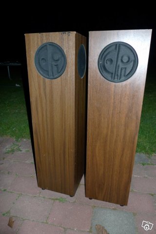

Didn't these have anything to do with the microTower?
HUMAN Speakers: EPI 201 information
There's a pair for sale in Sweden for around $125.
not exactly - these utilized 2 modules of the 8" woofer and 1" inverted dome tweeter in a sealed enclosure
the EPI microtower family ranged from the basic MT1 to MT3

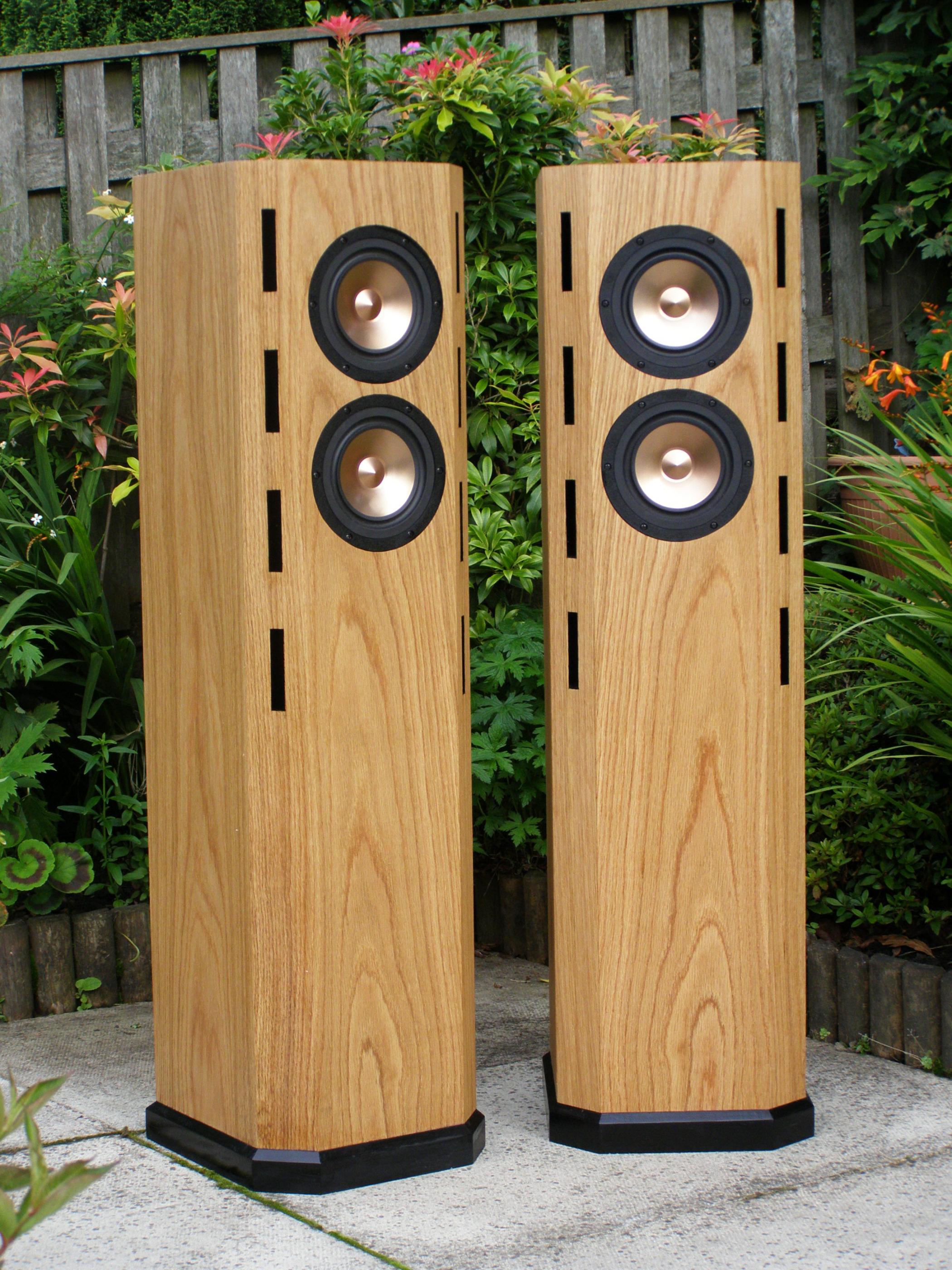

Are these the original MicroTower speakers?
Pretty much. One of the newer revisions though -- the feet may not be original. And selling for more than they cost new (and a lot more than i'd pay)
dave
I have built a pair of dual CHR-70.2eN Micro Towers. Still playing around with stuffing, but speakers have quite some heft, specially for their size. Guess EL70s will give more bass in the same box.
-Zia
note that some revisions to port tuning would be required, but pretty much, yes - a pair of EL70 per enclosure would not be shy on bass performance,
